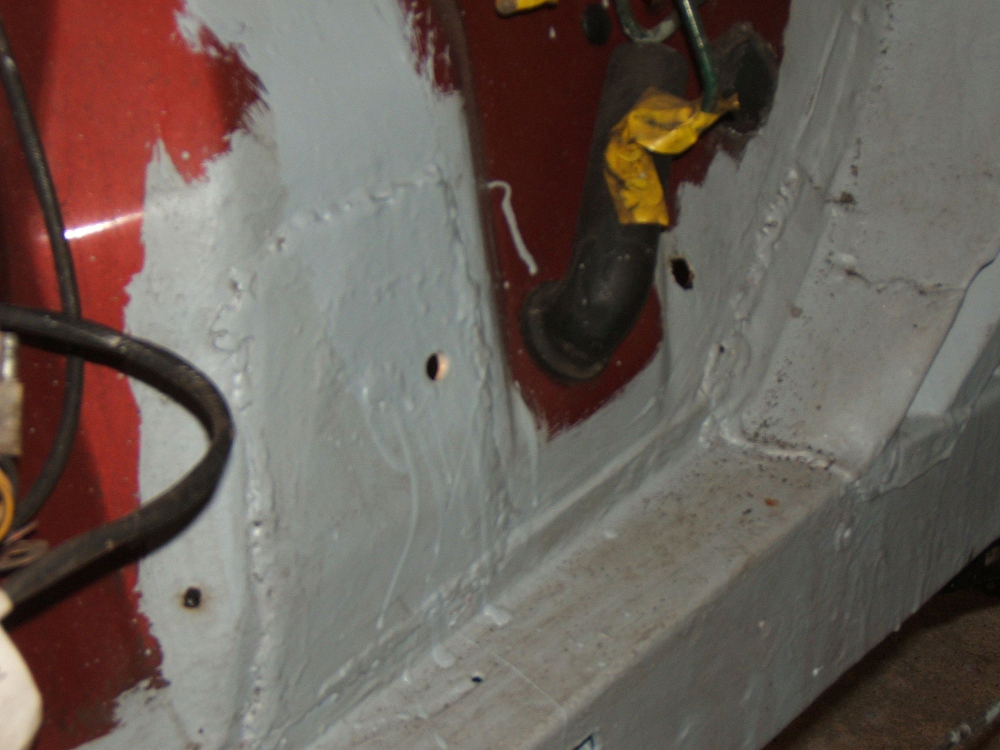

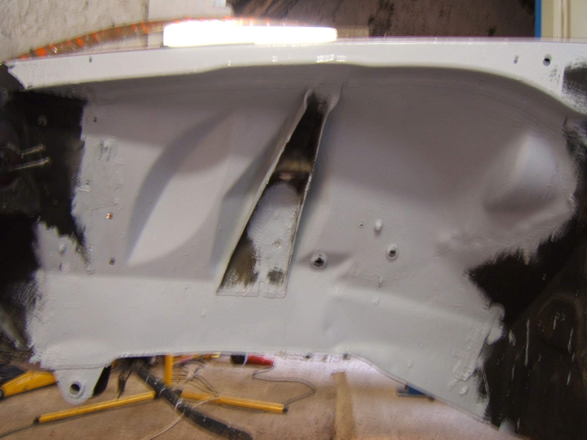

Once cleaned up and the rust cut out, I suèggest that you thoroughly clean behind the shock strengthener before welding new metal in. Then after welding, treat the metal all round and behind the strengthner with suitable antirust stuff, then seal the join between the inner wing and the strengthener with suitable mastic to keep the water out. I used AquaSteel and mastic called Stixall.
Shock strengthener, important to  treat and seal all round where it is against the inner wing metal
Welded up rust after tteatment
Welded up rust after treatment
