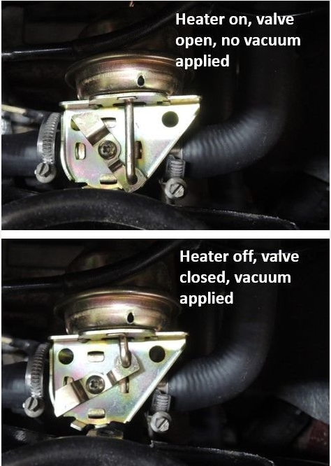

The heater valve opens when vacuum is applied and closes with no vacuum. Per other posts the opposite should be true.
My car is a low miles 1992 XJS. The valve appears to be original. I have no heat until I manually apply vacuum to the valve.
Is it possible that something slipped in the valve or is it different for 1992?
Here are images that I have borrowed from another post that illustrate how it is supposed to be.
This is how it is said to work, but my car is the other way.

NO vac is wide open.
VAC is closed.
BeEn that way on Jags since S2 and S3 and XJS since inception. 1992 is as described..

I've removed the valve from the car and discovered that it indeed self-reversed its function. It slipped internally. With the help of a screwdriver I was able to move the drum inside to the intended position.
A new one is on order.
Come to think of it, this slippage could cause the valve to be partially closed.
So if your car does not heat very well it might be worth looking into.
Partially open with the AC on would also affect cooling performance.
