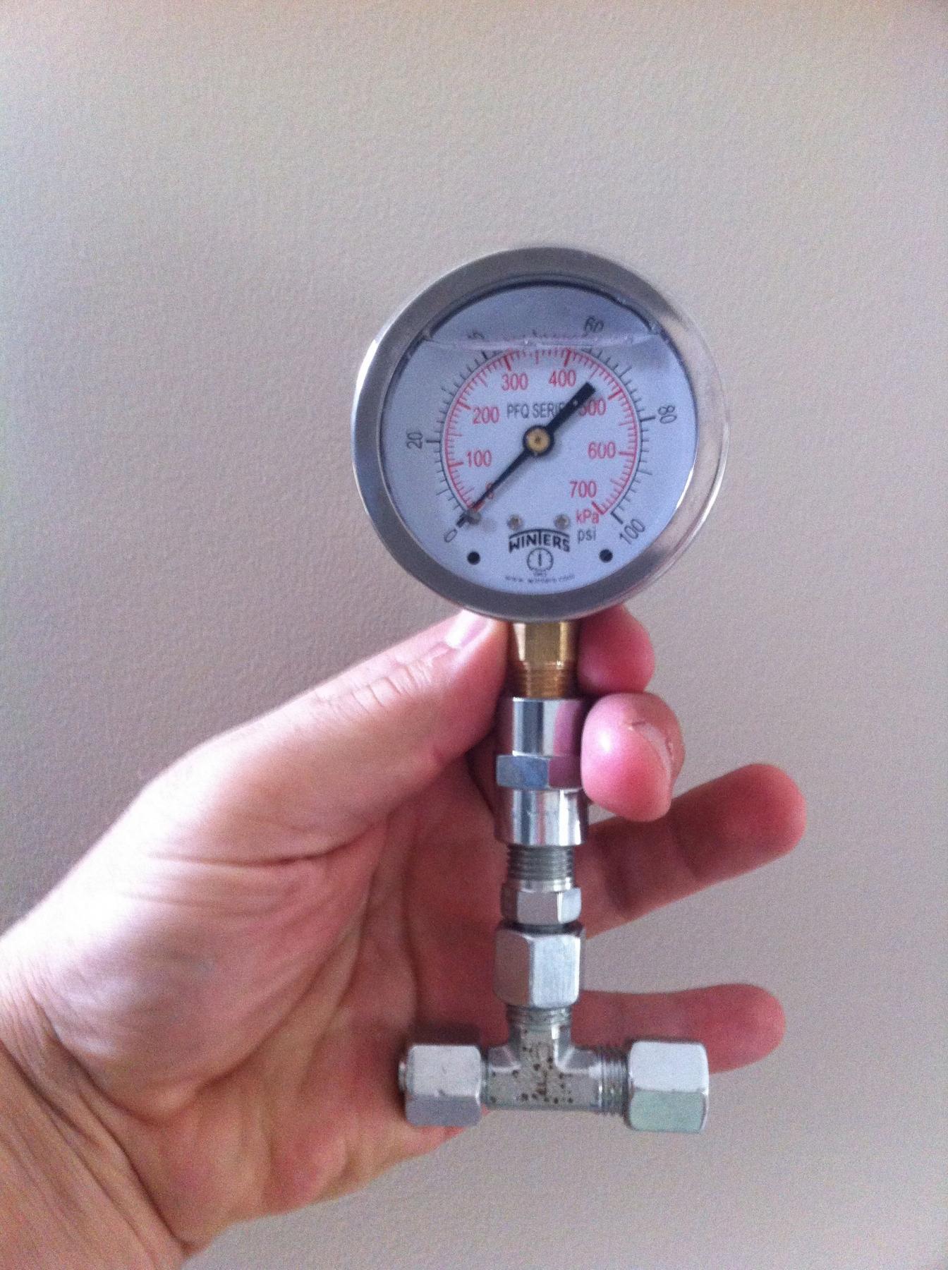

4. If you have spark and can hear the pump whirring, check the fuel pressure at the rail. You should have around 32PSI at idle rising to 44PSI at WOT. It's a bit of a pain to check the pressure as you have to make up a fitting for the connection or cut the hose and 'tee' in a gauge. I don't like doing that so cobbled together a gauge like so.
5. If you don't have good pressure you may have a blocked fuel filter (when was the last time it was changed?) or defective fuel pressure regulator.
6. After that it becomes a chase. It could be defective crank sensor or bad earth or any of a myriad of other ailments.
