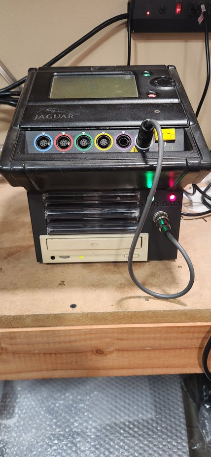

Hi Neal, I recently purchaed a 94 as well and I probably have the same issues your having. On the brakes, do you hear the pressure pump building pressue when the key is turned to the "on" position or the number2 position? If it's not running that could cause spongy brakes I would imagine. First thing I replaced was all the brake calipers, pads, cut the rotors, and soft lines. While doing that I found that I had water intrusion into the front bearings too. So replaced them too. You'll need a PDU to do diagnosis on the engine. There is one on ebay (if it's still there). My convertible top has a bad seal in the pump (available on ebay), so I replaced that as it was leaking fluid. I found the hydraulic cylinders were leaking slightly, so I replaced those too along with the lines. I have come up with a rebuild kit for the cylinders now that I had time to look closely at them and I have them on ebay. Top now works fine. Lots of things to sort through on this beast, but it is a really fun ride. Here is a shot of the PDU docking unit I made for mine.
