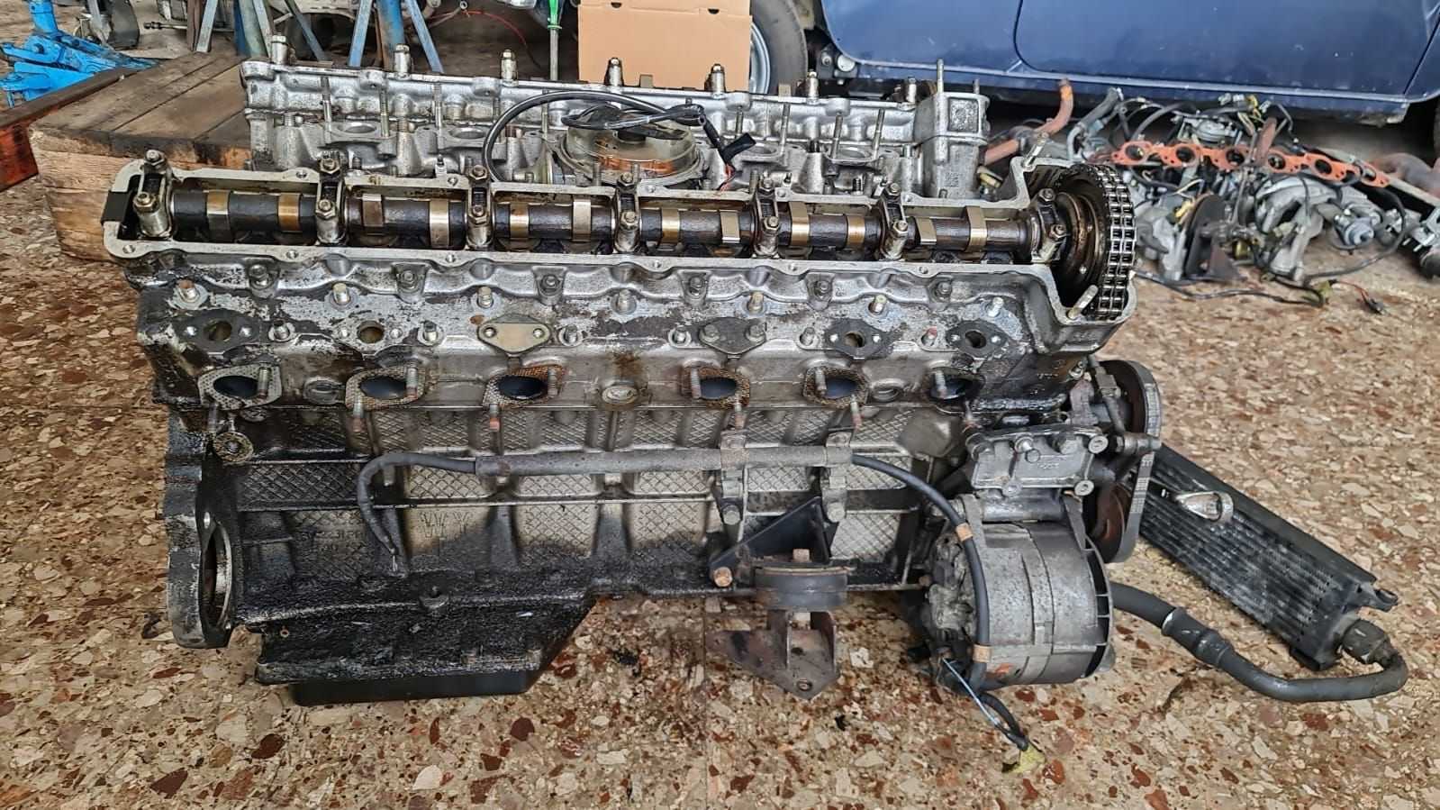

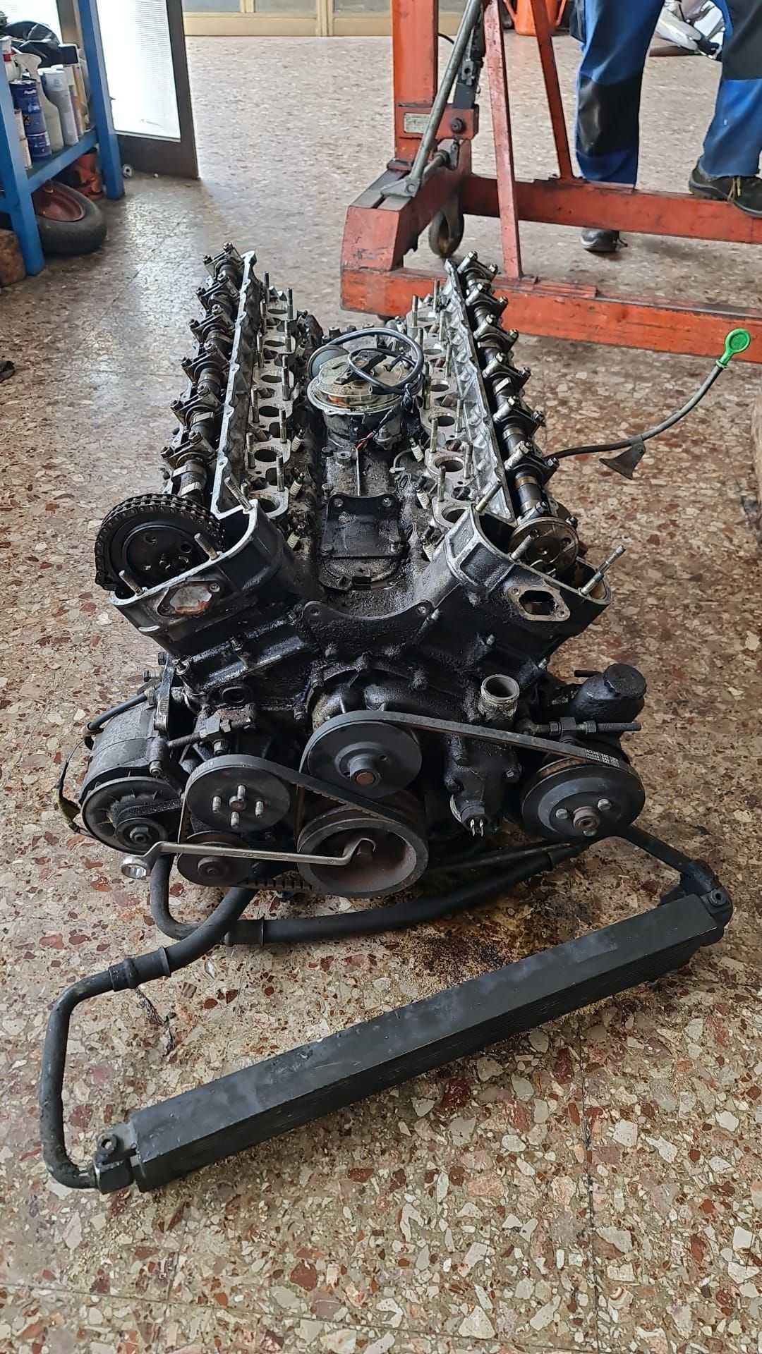

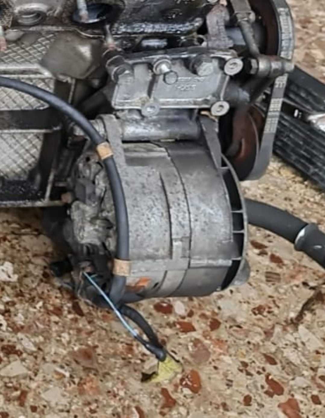

Greg(s) and Peter, sorry, I am getting confused...
The only thing that I am not confused about is that, for this high efficiency cooling system (2 electric Spal fans + fridge in the back) my 75AMP might suffer.
Will I need to adapt the mountings on these? The triangular mountings where the bolts go, seem to be in a different position from where my alternator has them:
https://www.autodoc.co.uk/lucas/13713781#alternator
https://www.autohausaz.com/pn/AL192X
https://www.autodoc.co.uk/autoelectro/10629950
And, apologies, I am starting to get really confused now. Are any of the 3 above a simple drop in replacement for part DAC5224 (as gathered from the Jaguar/Land-Rover parts catalogues)? Is part LRB00284 (recommended by Starter motor and Alternator company) not good? They can procure LRB00284.
I attach images to help you determine which are better for my Double Six
75 AMP alternator
Alternator position on left of image
Alternator position

Thomas,
ANY of the alternators I listed will be fine. They are all basically the same.
As to fitting it:
see this photo as marked up
The blue box shows the long bolt going through the bracket attached to the engine that provides the fulcrum for the alternator, allowing it to swing in and out as the belt tension is adjusted.
Depending upon the date of your engine, the holes in the bracket attached to the engine, through which this long bolt goes, MAY be 8mm in diameter, as will be the bolt.
The new alternator, which is essential in my view, will have 10mm diameter holes for the fulcrum bolt. All your guy has to do is unbolt the bracket (four large bolts, no problem at all with the alternator removed) and drill out the fullcrum holes. Dead simple; he will have no trouble doing it.
I have just been to the Turin motor museum; FANTASTIC. I am quite sure having seen such wonders as your countrymen created in the 1920s, that ANY italian would have no trouble fitting this alternator!
