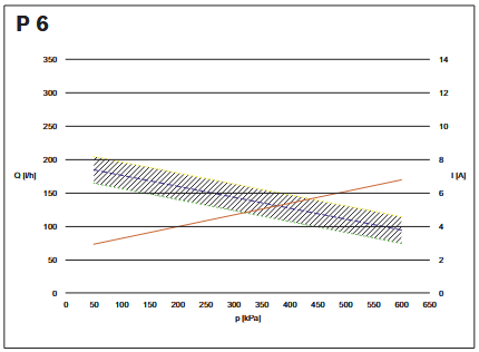

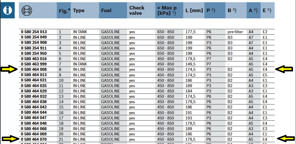

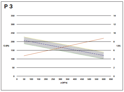

Went with the Bosch but the 0580464008 as it has a better flow rate. As near I can tell the Jaguar part equates to the 0580464070, I include this stuff here in case anyone is looking for a pump, I have found that many 'car part' sites will list numbers as if they're the same when they absolutely are not, they may 'look' the same but they aren't. Do not be quick to accept any old pump from motor part suppliers.
The 070 based on my research is the Jaguar equivalent
008 has higher flow rates overall.
070 has similar slope but lower overall flow rate.
