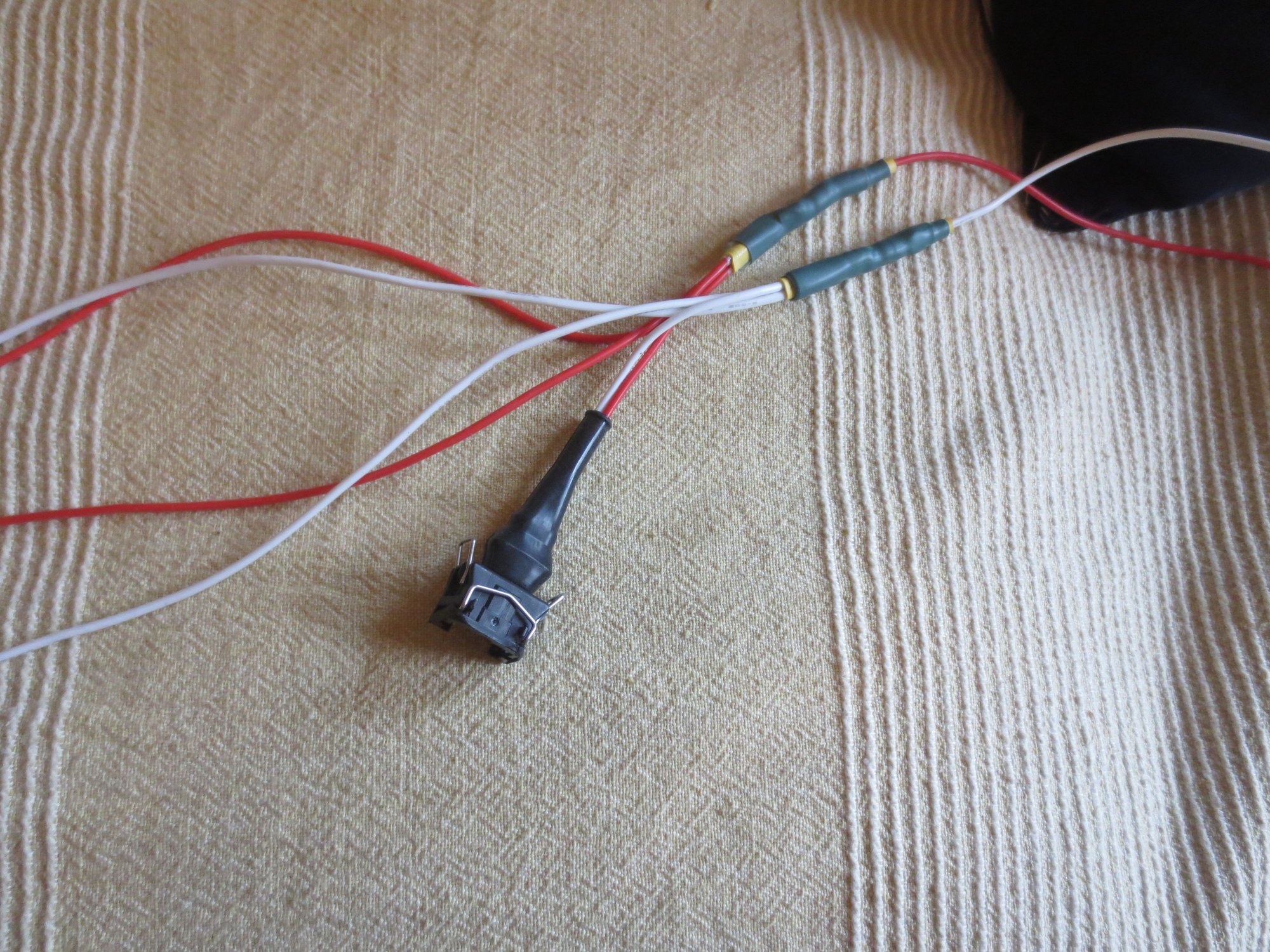

Sadly, the style of injector you illustrate will not fit onto the 5.3 litre HE pre-facelift injectors, as the collars that hold the injectors in place have not enough room to fit them. I do agree that removing the OEM ones is an absolute pain (I use a small 90° pick to get the spring off one side and then they can be worked free)!
This type willl fit with a tiny bit of filing:
These are easy to removeas well, just squeeze the ears together.

Oh you’re right, the metal retainers get in the way. Work great on my 92s! Where can we buy the kind you have pictured? They do look much more compact.

Here
https://fr.aliexpress.com/item/10050...yAdapt=glo2fra
