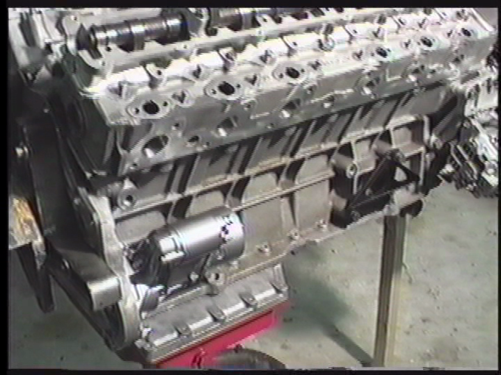

a pic of my starter, came from a Ford(dont know year or model), works fine very light weight around 9-10 lbs!
been 26 years so works for me! gear reduction.

I agree the gear reduction starter really works well and is both light and compact.

It's also considerably shorter, so the alternator to starter cable that runs thru the conduit may or may not be long enough. I had that issue today. It's a whole lot lighter, and much easier to wrestle into position. I had to drill out the cable ends for both the main battery cable and the solenoid wire.
