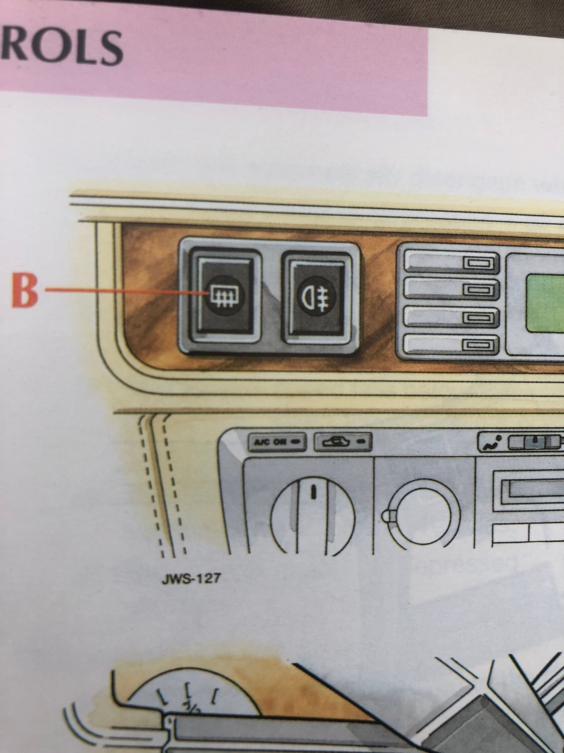

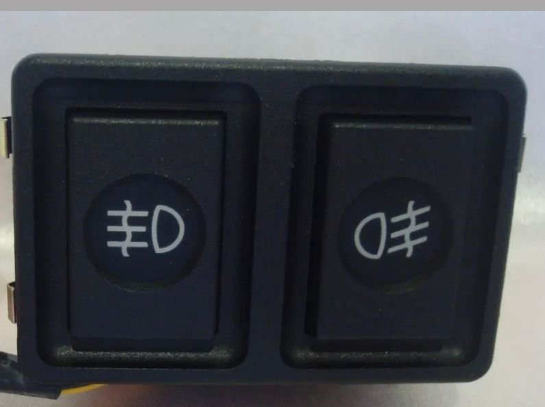

All 94/95/96 came pre-wired for front fog lamps.
If the button on your dash looks like this, your car did not come with fog lamps. That button is for the rear fog lamps::::
however, if that very same button looks like this:

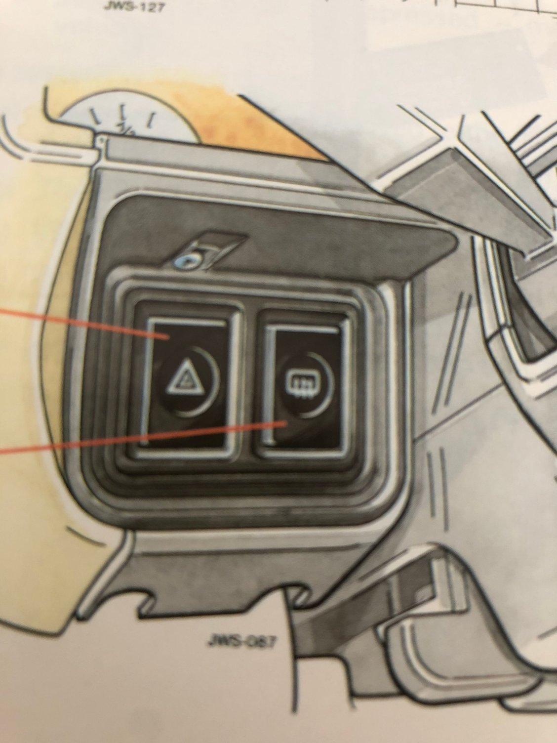

AND the buttons all the way on the left of the steering wheel have both the defrost and the hazards like this:
then you should have front fog lamps.
if you have a 94-95-96 car and you want to install OEM fog lamps you need
1- The actual fog lights and brackets
2- Fog lamp switch and the hazard/defrost switch as the one on the 2nd And 3rd photos
3-may or may not need a shortening plug. My car did not require one.
but it’s all pre-wired. You just install the brackets, screw on the lamps, connect them to the existing connectors, pop out the old switches and install the new ones.
