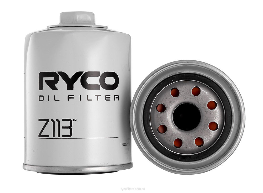

Found a Z113(with nut) oil filter today on ebay so I called Repco, they can get them sometimes (only short production numbers a couple of times a year). But they want $68 for them, or $45 on ebay.
Ryco Z113 OIL Filter | eBay
How to properly change your oil (and basic service) your XJS and at what frequency?-z113.jpgHow to properly change your oil (and basic service) your XJS and at what frequency?-dsc_2360.jpg

wow that is a pricey filter. I guess using the Z133 we'll see how much of a bitch it is to swap out to warrant getting the Z113 (nut job...ha ha ha) next time.

FORGET that Ryco Z113, that is plain highway robbery. They really are not that bad to change without the nut. Fiddly, yes, thats all.
I prefill them, coz they are right way up, and hold close to a litre of oil. If the Goose cranks a few revs prior to firing up, prefill is not all that precious.

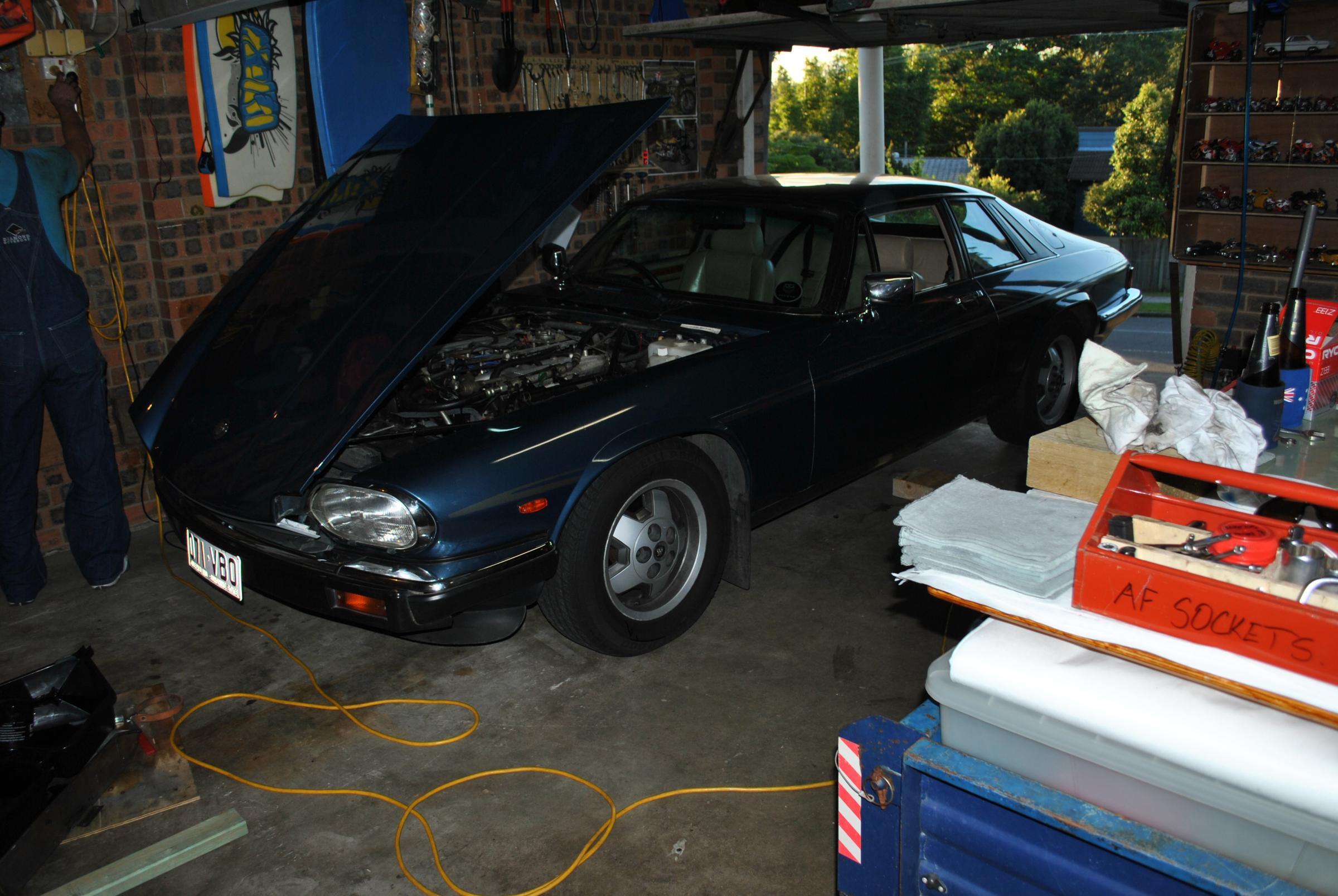

Meeting of the Beer and scotch appreciation society at my place tomorrow , and service an XJS before the bbq.

Beer,oil, beer.
Job done. And front and rear end pass check up.
