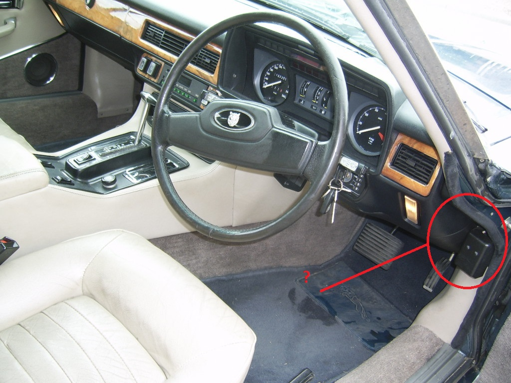

Cheers bud, I can't say I knew the switch existed Is it the one circled in the picture? (You might recall that is one of the original photos you sent me. I had it on my hard drive )
So being that it is a "collision" switch are you supposed to activate if you have a crash or something or is it used for maintenance purposes like we are doing here?
The idea is that if you have a crash the inertia switch clonks out, thus saving your unconscious body from being incinerated by petrol still pumping out at 70psi and x hundred litres a minute!

Cheers Greg. I never knew that. So the picture circled in red above is the collision switch?

Yep, RED circle is the switch in question.
Greg answered the rest of the question.
Some have reported that switch tripping if the door is SLAMMED, which apart from being UN-Jaguar, causes much grief for the owner to try and find out why his mighty V12 "NO start", and usually gets a "War and Peace" sized thread on here before said switch is reset, and drinks flow more than at CLeake's place.

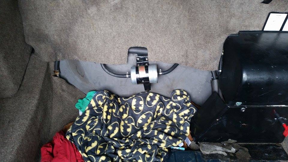

Heh guys. Fuel filter arrived today....just getting ready to do it in the next day or so.
Just going back a few months in regards to method as recommended by the great ones..
Best to remove any carpet under it first. Start the car, deactivate the fuel pump by removing the feed to it (eg pulling up the collision switch) and the car will stop after a few moments. This means fuel at high pressure will not squirt out from the system. Then with a goodly number of old shirts under the filter, just undo the body fixing and the pipe clips. careful to put the new one in the right way round.
UP is OFF, DOWN is obviously ON.

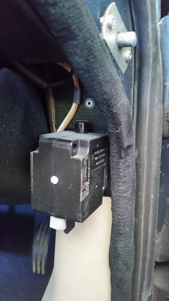

So going by a quick look before (see picture) my collision switch just looks like it has a button on top...so as mentioned above.....running the car for a few moments I just simply pull this little button up and my engine will cut out?
Once I swap out the filter and all I just simply press this down again , start her up and "wella" cleaner fuel going to my engine?
Its funny how 600V AC doesnt scare me but an automobile does lol!
Paul
Once the switch is up, the engine will gradually die as fuel pressure drops. Just let it die and then the lines will be depressurised. When you have finished, reset the switch and current is restored to the pump. Then a few on and offs with the ignition will prime the system, the pump runs for 2 or 3 seconds each time the ignition is switched on. Once that is done, start it normally.

So just out of interest sake, is the collision switch just a normally closed switch in series with the fuel pump or is it more complicated than that? I see the cable going to the bottom of it is a multi-pin connector with a few wires going to it. Just interested to learn a little more about it

Well now that wasn't too hard! I survived without blowing myself up so I'm happy.
Before I started I looked at the workshop manual and it stressed the importance of de-pressurizing the system as we discussed however it talks about pulling the lead for the fuel pump and starting her up without the ignition coil on.....are we just effectively doing the same thing only easier by pulling up the Collision Switch?
Well either way, I just pulled the switch up as Greg mentioned and the engine cut out in a few seconds.
Once I placed all the rags down and a bucket just in case, I removed the filter. There was a little bit of back pressure, but none to write home about. Caught most of the dribble in my bucket I laid underneath.
Actually noticed the fuel that came out of the filter didnt look too bad, however I am no expert so not really sure what dirty fuel would look like.
Anyway, put the other one on no probs and she was good to go.
Whilst I was there I finally got around to re-wiring my fuel sensor as the earth wire was melted and hanging on by a few copper strands. Not sure why but I'm thinking maybe there was a breakdown in insulation and it was shorting on 12V near the battery at one stage....dunno?
I cut back the wires near my battery/ECU area and connected a new cable with inline crimps. Fitted off new connectors on the other end and picked up an earth closer to the sensor, which was much easier to get to it.
So , cleaned up, pushed the Collision switch down, primed the engine a few times (thanks Greg) and then cranked it. She started first go and I let her run for a few minutes, checking in the boot to makes sure the filter didnt have any leaks or anything nasty. All looked good.
Thanks for all your help guys yet again!
