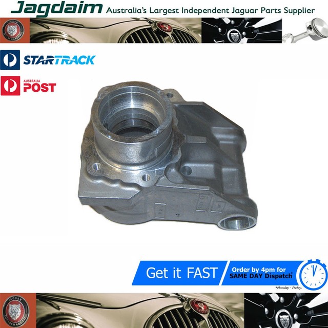

i have been told that a XJ40 hub carrier might be a bolt on replacement for the carrier i have which looks exactly like the picture you posted
picture below is what im looking at to replace mine with

An XJ40 hub carrier that you puctured is not a simple bolt on to an early Jag rear suspension. The complete half shafts, hub bearings, fulcrum bearings, fulcrum bolt, and hub itself that the wheel mounts on are all different. In addition, the XJ40 hub assembly is designed for outboard disc brakes, not inboard.
XJ40 hubs with all of the above different parts and more are sometimes used to convert an XJS from an inboard rear disc setup to outboard rear discs. There is also fabrication involved to do that swap. That may be what they are referring to.

That snap of mine is the hub unit from one of my S2 cars.
The Inboard brake outer hub is what it is.
YES, people have converted to Outbooard brakes, as mentioned, and used the XJ40 stuff, but the difference in attachment etc is like "chalk and cheese", NOT imposisble, nothing is.
Inboard brakes is what it is, and those hub units are unique, from MK10 right up, in so far as looking the same, I have never measured or anything else if there would be a difference from the 1960's to the last of the Inboard brake cars. I doubt it.
All the Series cars and XJS (Inboard) are the same, that I know. ABS cars, as in real late stuff are basically the same, just with an ABS sensor, which if the fitment has NO ABS, who cares.
They are Handed, for the purists, as in the grease cup faces the rear, a dirt ingress thing through the tiny hole, really??, otherwise no changes.
