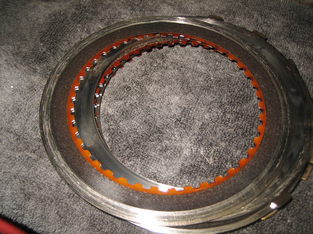

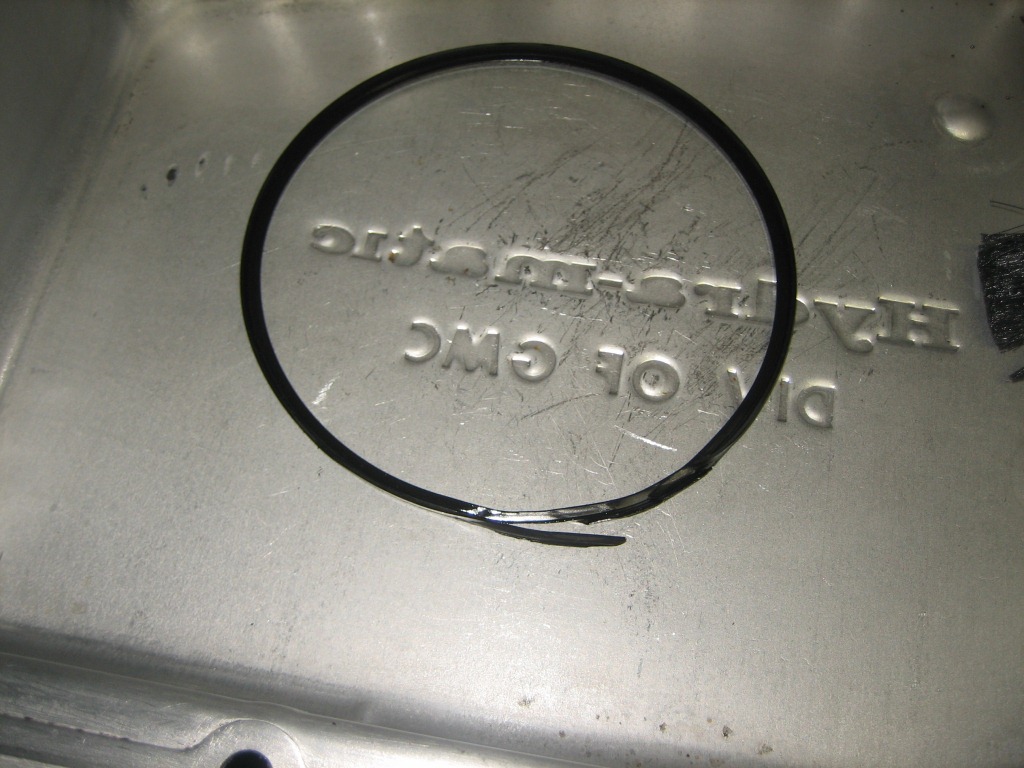

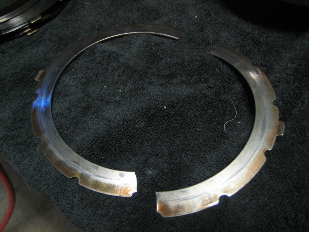

I've uncovered my transmission's problem. The wave steel in my direct clutch was broken and destroyed the rest of the clutch disks. The frictions and some of the steels have deformed to a bowl shape (heat distortion?). Some of the frictions have the fiber completely gone from one side, while the other side looks ok. Others have only part of the fiber eaten away.
I also found that the large lip seal on the direct piston was damaged. I'm not sure if the broken steel damaged the seal or if the bad seal caused the clutches to crater. Doesn't matter at this point.
The intermediate clutch and both bands look good, but I'll be replacing them since new ones came with the overhaul kit. I haven't gotten to the forward clutch yet, but I'll let you know what I find.
