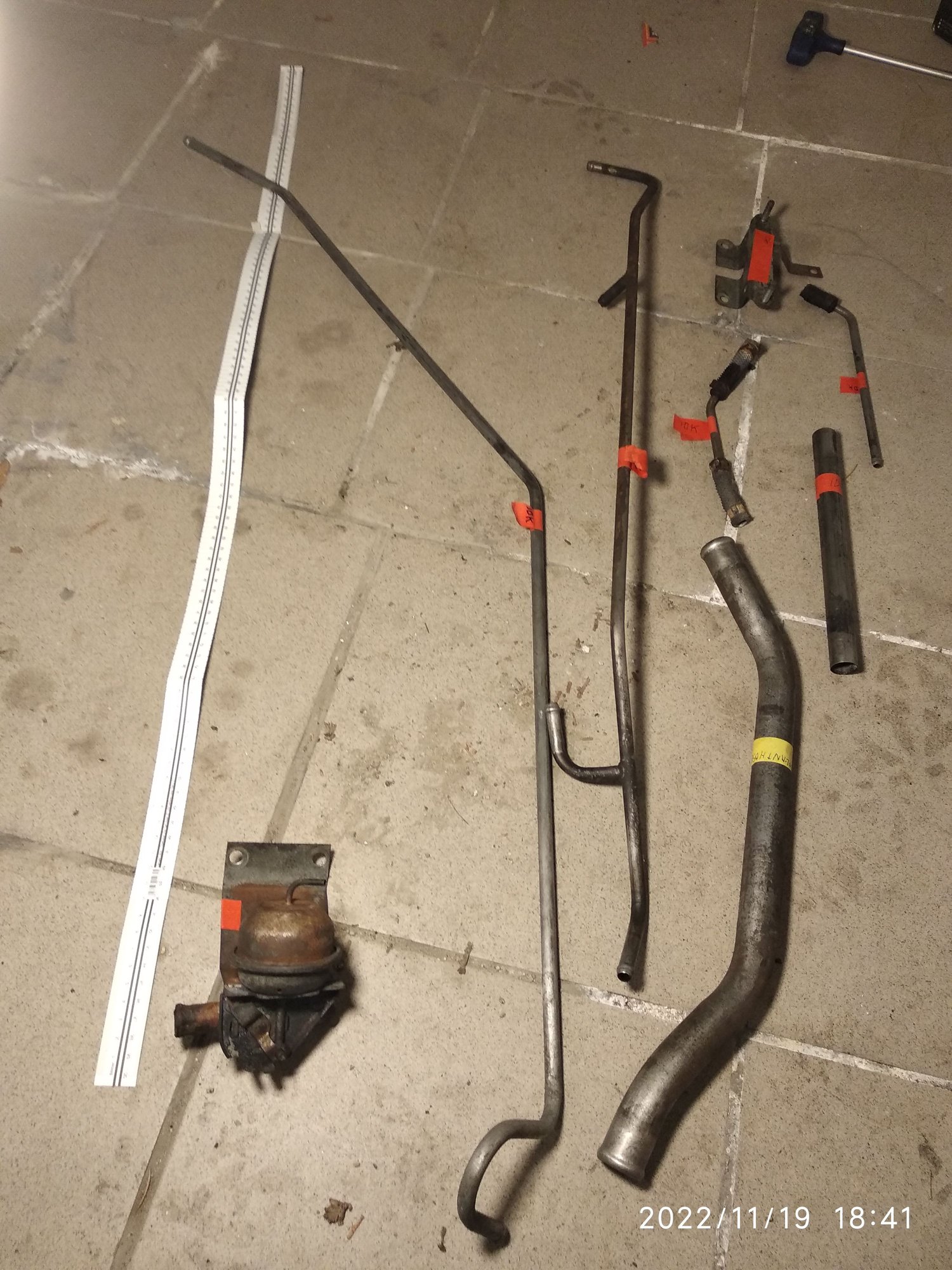

I had a fire. If you want the story, I write it at the bottom. Now my car needs some repairs. I need help identifying some parts.
I am putting labels on pats that I remove so I know what it is and where it goes. Some parts I don't know where it's from. These parts have red labels that say "IDK" as in I don't know what this.
In the photo I put a 1 meter long centimeter scale.
Any insight, comments welcome.

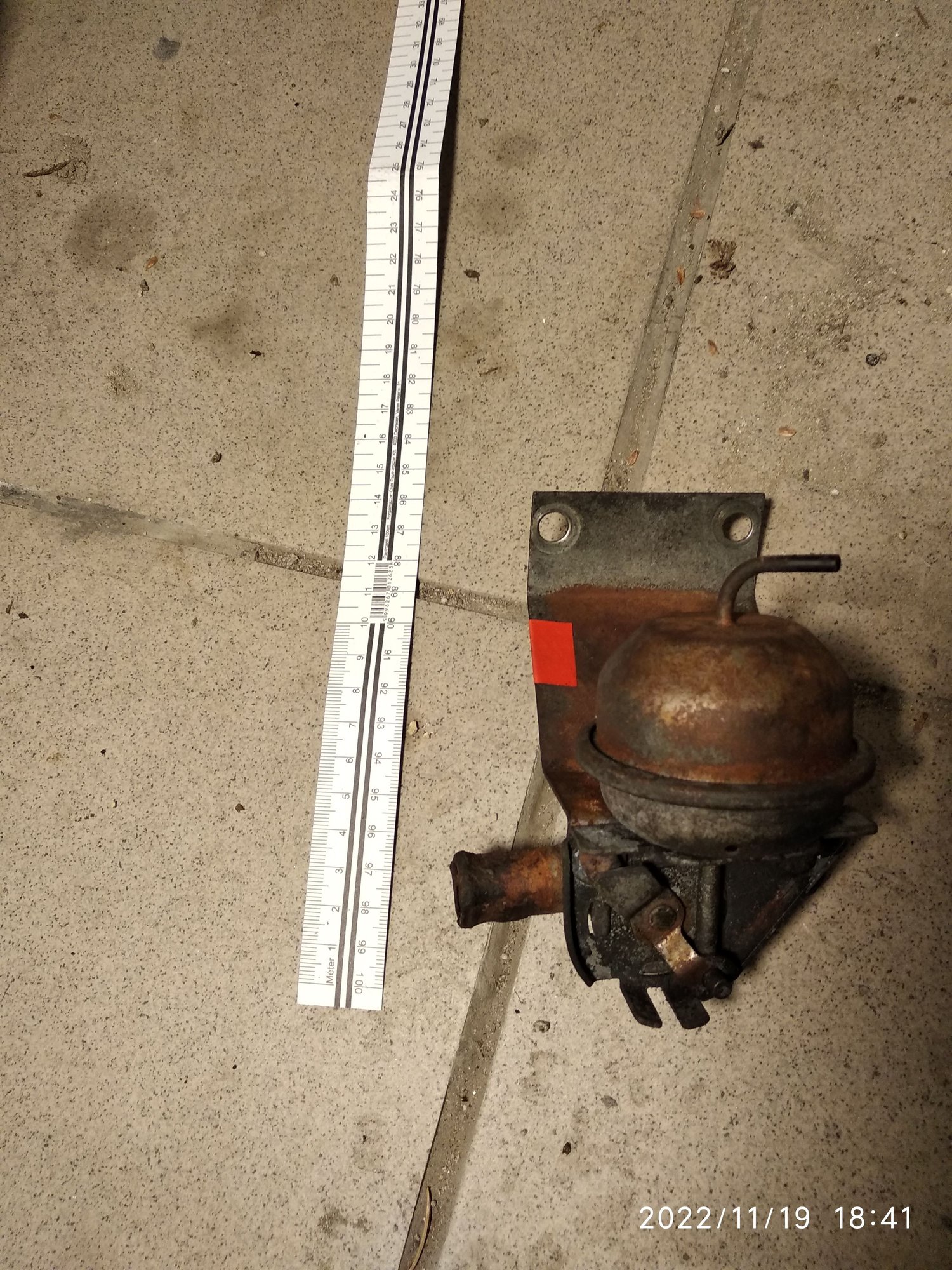

Heater water valve
Long pipe on the left of the group of pipes is the vac pipe from the firewall to the vac reservoir with the take off to the booster
The long pipe next to it has me stumped, is your car a left hand drive one? and which year is it? Maybe that poipe goes across the firewall to the LHS brake booster and the hooked take off on it is for the booster.
Someof the smaller pipes look lke connectros for the brake vac pipes

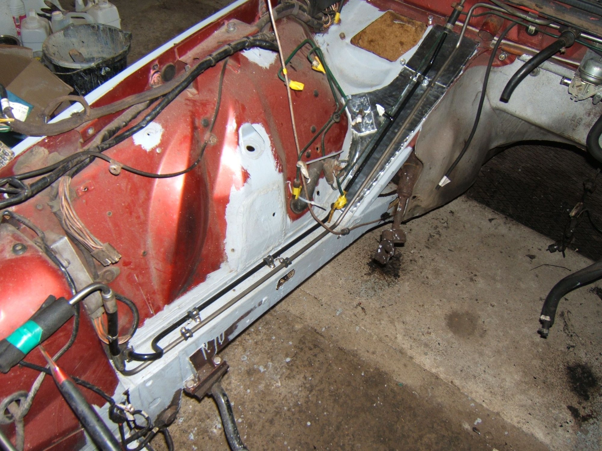

pic of brake reservoir pipe, the black one.

is the white stuff some anti rust material? What do you use?
When I rebuilt my car I rustproofed it as follows:
  1. All box sections, sills etc sprayed intenally with AquaSteel: https://aquasteel.co.uk/
  2. Then all box sections then sprayed with speciality paint from Indestructible Paints, Birmingham, England. This is the sort of stuff: Zinc Chromate which is the absolute best, I forget exactly what they sold me; but if you talk to them they will advise what to use. This is the "white" paint you refer to, actually light grey. HUGELY expensive it was, but rust in the UK is a major problem: https://indestructible.co.uk/product...romate-primer/
  3. I painted outside the box sections in this area too, as I had to weld up the inner wings behind the shock strengtheners (a common rust point so look out for it) and also round the seams near the brake booster area which also needed welding.
  4. FYI, I then sprayed the sills and box sections with rust prevention wax. https://bilthamber.com/product/dynax-s50/
I used this sort of stuff for the wax spraying, youneed an air compressor for the second type:
https://www.3m.com/3M/en_US/collisio...vity-wax-plus/
or this
https://www.rust.co.uk/product/cat/w...oofing-kits-26
On any areas that have rusted after the fire, use a chemical cleaner to remove the surface rust before painting. 75% phosphoric acid is best, if you can fuind a industrial supplier, but there are proprietory ones that work OK: https://por15.com/products/metal-prep
