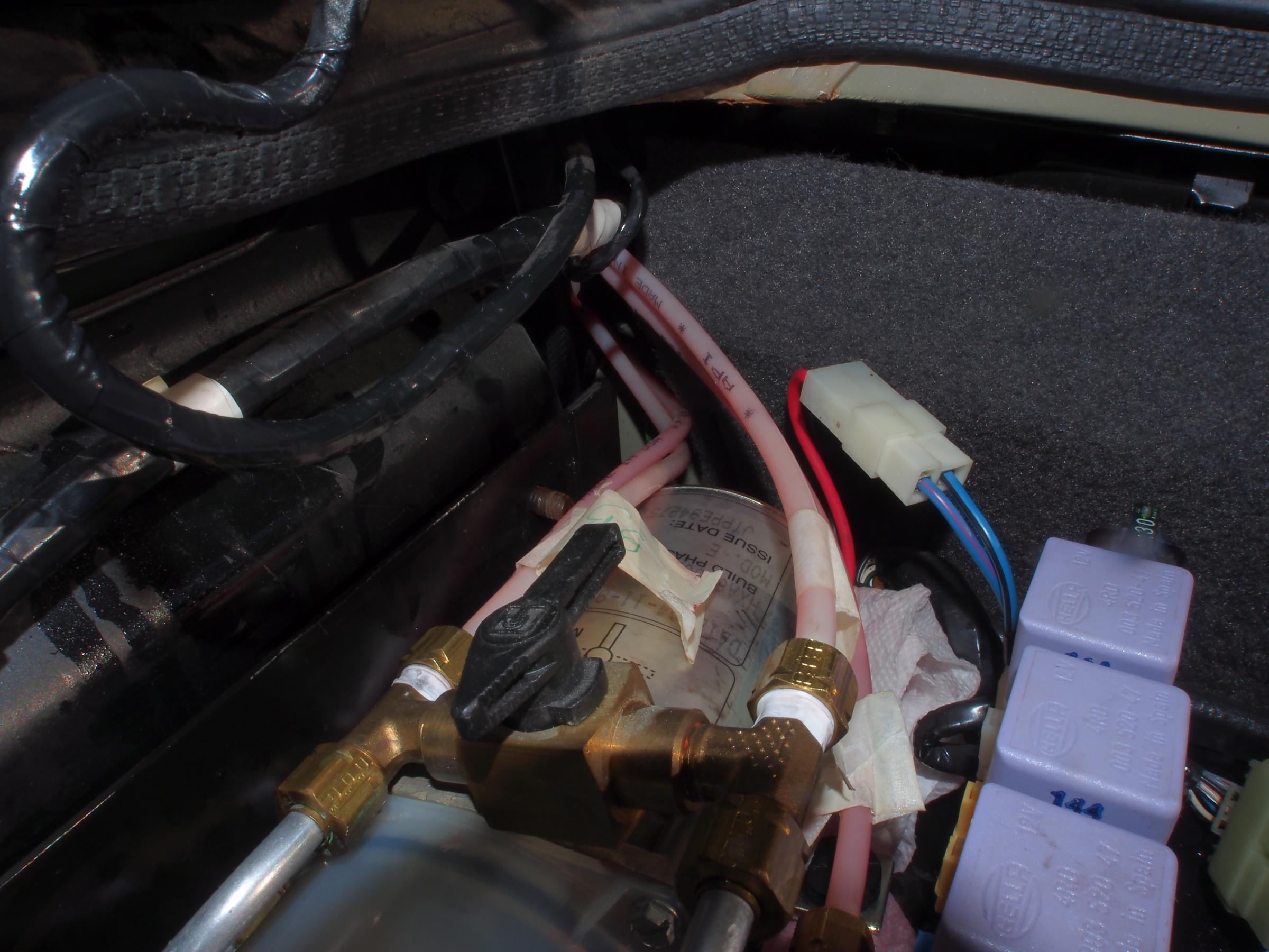

Help! I took apart my convertible top hydraulic pump and changed the seals but would you think I labeled the 4 hoses that attach to the pump when I took them off?. I ended up labeling them to the best of my memory and I hooked 'em up the way I thought I took them off but the top won't go up or down now. The hoses/tubing seems to come out in pairs as you can see from the picture. Could someone take a picture of their tubing or describe, based on my photo, how I effed it up? It's a beautiful day and I was hoping to go for a drive with the top down.

I came across this diagram and was able to fix it... now it goes up and down as it should.
