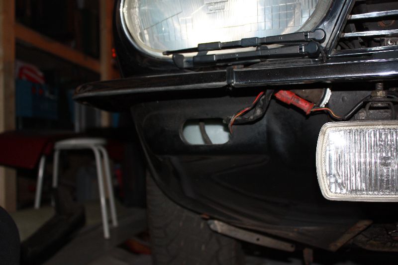

This evening I was going to remove the lower plate and grill for sandblasting. It was quite rusty and I'm planning on repainting. As I did that I discovered some nasty damage to a radiator...
It is a small size radiator, lowest to the ground and in front of all the other radiators.
Can anyone tell me what radiator that is? you can see the damage clearly in the pics.

I could be wrong, but that looks like the engine oil cooler to me. Not something you want to blow out on you when driving down the highway...

It is definitely the oil cooler. If you are lucky and the bottom fixings on the cooler (one each side) are bolts rather than studs, to remove it first undo the oil lines on each side. Ensure you use a spanner on each fixing (one on the cooler fitting, one on the pipe). Then pull the bottom of the cooler forward carefully, and then down a bit, which releases the pegs at the bottom of the aircon condenser (the cooler above the oil cooler) from their mating holes in the oil cooler.
If this does not work, then unbolt the cross panel that goes across the top of the radiator (two bolts each side) and ease it up an inch or two. This will allow you to also ease up the higher cooler, which is the aircon evaporator, which is a push fit into fixing holes and rubber bungs in the oil cooler top. Now undo the two smallish bolts (one each side) at the bottom of the oil cooler, that hold it to the body.
Remove cooler and chuck it away! Sadly, from expensive personal experience, you may not be able to buy a second hand oil cooler in anything like a decent state. If not, a new one is around 150 to 180 UKP. Try Grublogger for a second hand one, or any other breaker. If you plan to keep the car, a new one is always a better idea.
The oil cooler to oil pipe fixings are different sizes on different model years, depending if you have the oil bypass system or the full flow system. So you need to know this when ordering a new cooler. If one of the oil cooler pipes exits from the front RHS (UK driver's side) of the sump sandwich plate, then you have the bypass system. If not, not. The bypass system was changed to the full flow in the late 1980s.
I love the bumperless look, and the indicators, where did you find them? The car will run MUCH cooler without the bumper too. The horns are easily moved one to each side, and this ilproves airflow too.

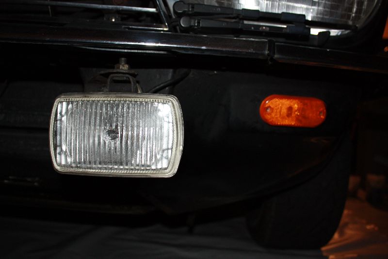

Some more pics of the turn signals:
greetz Frederik
Attached Thumbnails My work in progress :) - Nasty radiator suprise and new indicators-foto-0728.jpg   My work in progress :) - Nasty radiator suprise and new indicators-foto-0729.jpg   My work in progress :) - Nasty radiator suprise and new indicators-foto-0730.jpg

Mant thanks for the offer, I do not need them at the moment, but if I ever decide to ditch the front bumper, a modification I like, something like them would be very smart.
The only problem you may have with LEDs is that the flasher unit may not work as intended because it thinks a bulb is out. It is a feature of the XJS flashers that if a bulb goes out, the dashboard winker repeaters do not flash properly - this is a warning to the driver. I only know this because I chased a non-existent problem for about 2 days on my rebuild before I twigged the problem was an intermittently duff bulb!
I believe a resistor in the circuit equivalent to the bulb resistance will fool the flasher into working properly if this turns out to be a problem, but I am not sure on the values required.

I haven't figured out where to place the licence plate yet we'll see, I will take one as small as possible
For the bulbs to led conversion, I haven't tested them yet... I always take the battery out of the car and branch it to a solar charger since I don't drive the car frequently.
I will test them both with an ohm meter, and then fill in the difference with an resistor if necessary... That should work no?
