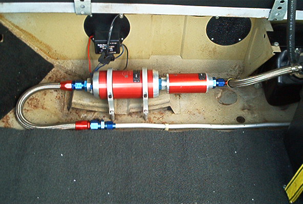

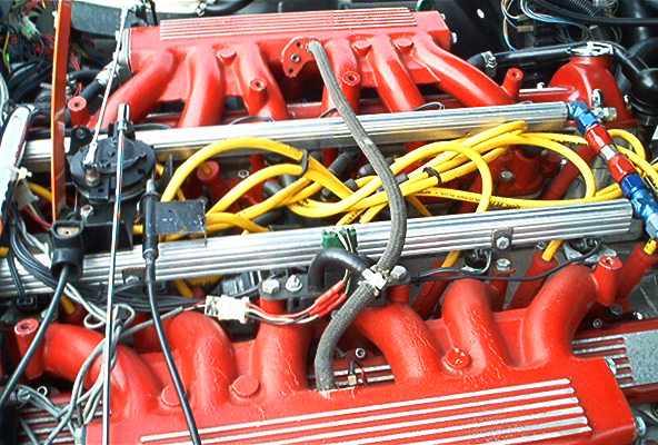

my injectors were rusted and could not be properly cleaned, so i decided on a completely different approach.
12 new 21# Honda injectors, but had to make fuel rails , from scrapyard, guy said aluminum hand rails from a restroom! go figure?
best part is no clamps and hoses, just simple o=rings, much more safe,(like leaks&fires), along with AeroQuip fittings&stainless steel flex lines.
if your gonna go for it? no rusty steel fuel tanks&lines,, plastic fuel cell,aluminum lines, hi-volume pump&filter. top o the line adjustable FPR.
