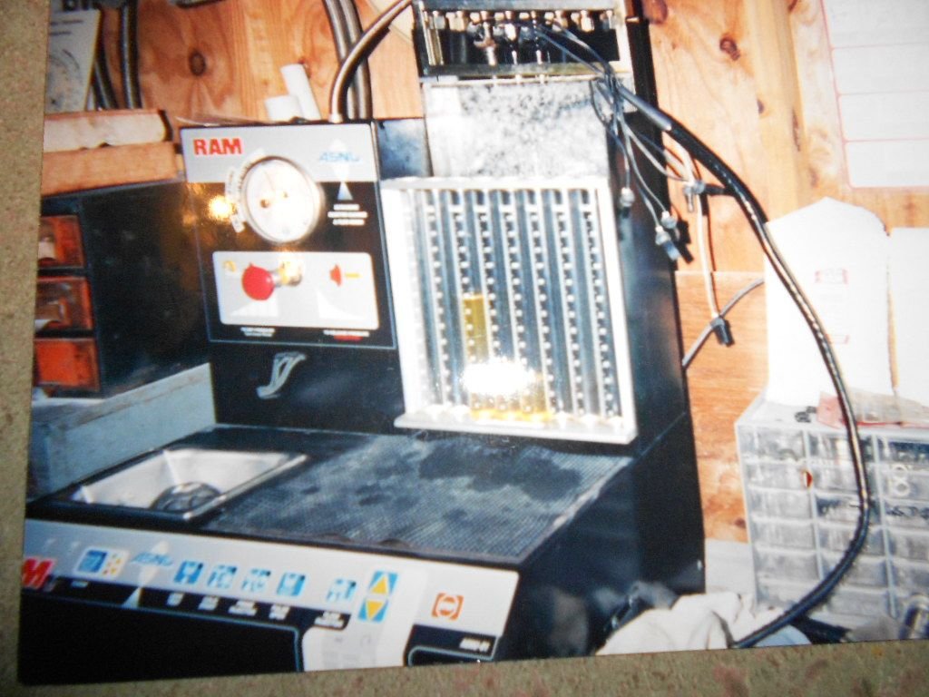

what he said, machine works wonders on dirty injectors . the Faircloth injection service , Jacksonville Florida,
pic of my machine sold with the business when i retired! ron
