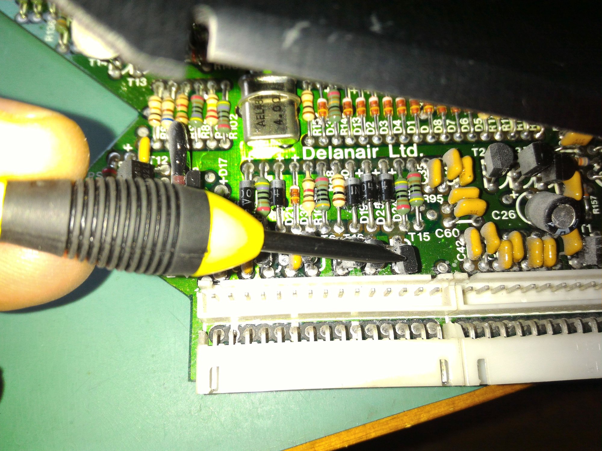

At the moment I am all in the middle of carpeting,,, seat covering,,, and the rear cage STUFF... When I have all of this stuff together or close,,, I will pull the ecu,,, find some courage,,, then start - probing... I have say this kind of work is WAY beyond my skill set and comfort level.
Where should that .6+ volts go after it leaves the ecu (If that's even what it does)???
ALSO,,, and I hate askimg for more, but is there a photo of the other side? If I can point to the transistor that needs replacing maybe I can just bring it to a computer or electronics guy and tell him "fix THAT thing, right there",,, lol... Electrics make me crazy!

The 0.6v is the test voltage from the DMM all it is doing is checking the transistor. A transistor is an electronic switch and 0.6-0.8v turns it on.
There should be a sticker on the ECU with a number can you check if it's 36900200 same as mine I am happy for you to send me the ECU and I can replace the transistor I already have a few in stock.
The transistor I am pointing to here is the one that drives the centre vent solenoid. The one for the AC clutch is the left one it has a yellow thing to its left and directly under the D in Delanair.

You could take the ECU to a local electronics repair place to get them to replace the ZXT if you find it faulty.
