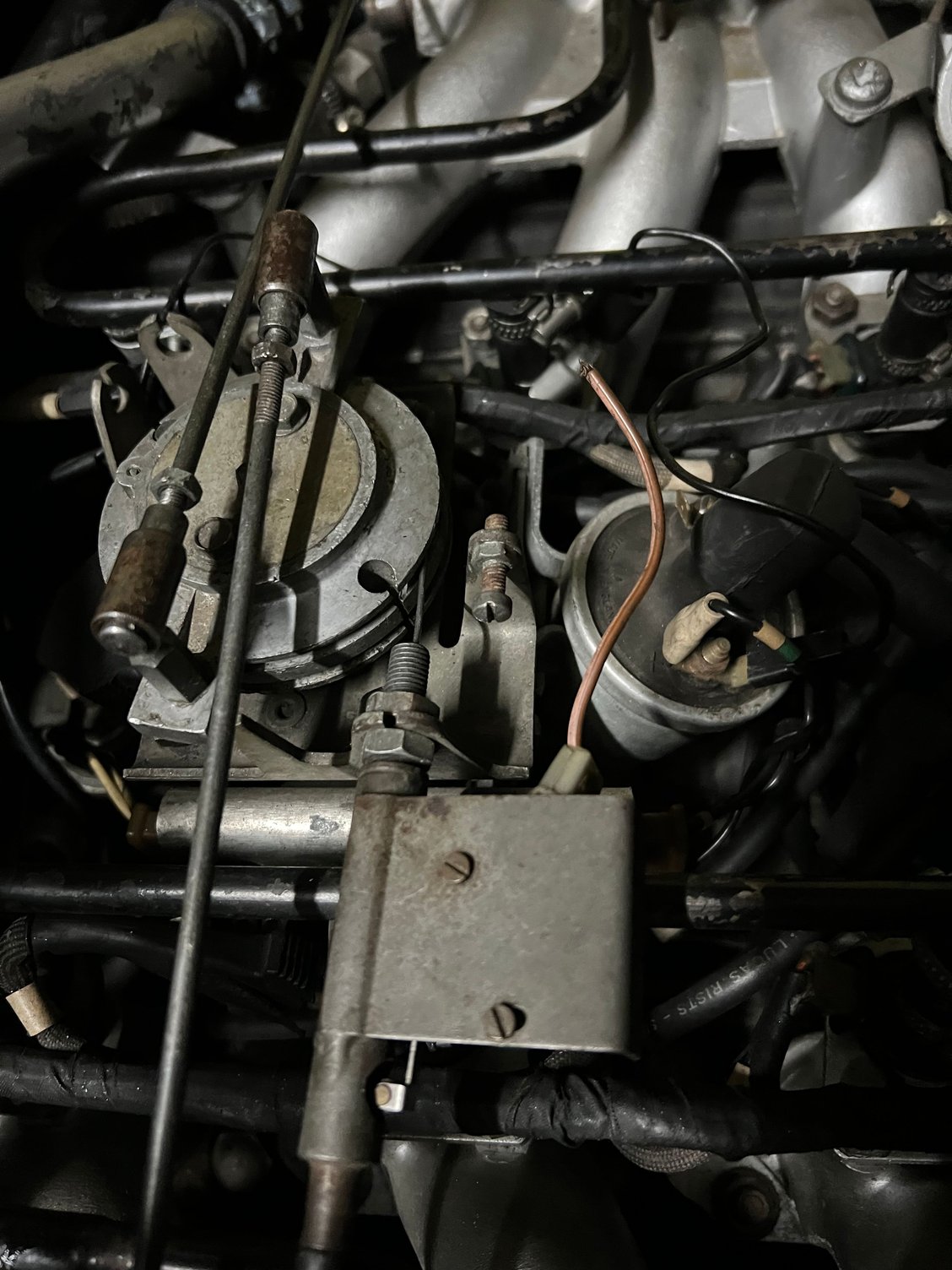

Thanks Baxtor. The handbrake needs a three terminal jobby, I am glad I shall be able to get one OK.
Good evening Greg,
could you help me please to restore the original connections of the full throttle switch in my 1975 XJ5.3C with Opus Lucas fuel injection?
At the moment the cable is disconnected.
many thanks
Enrico

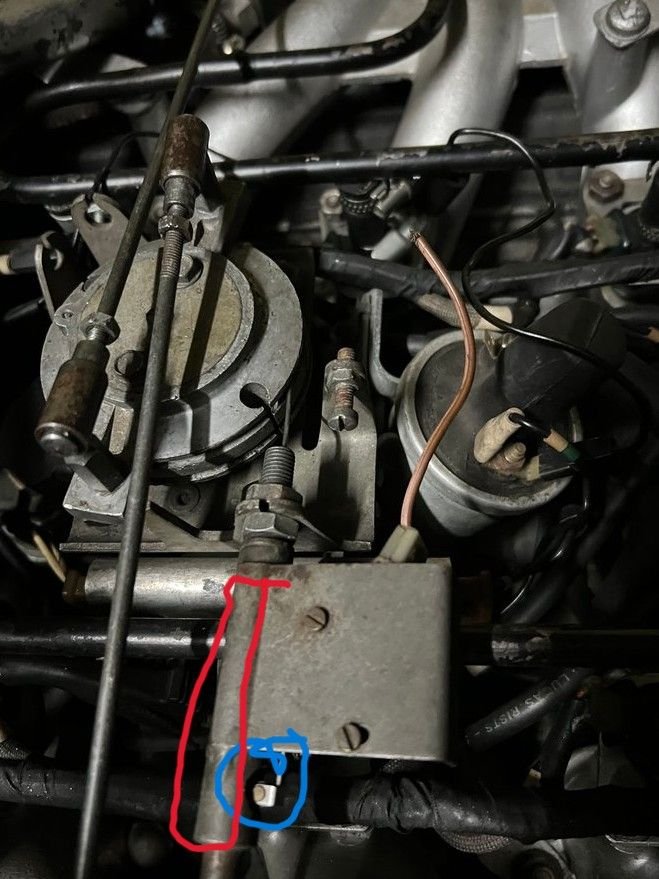

If the kickdown switch works on your car like it does on the HE cars, there should be TWO wires going to it. (It may be different on the pre HEs).
Can you see another wire anywhere, not connected?
As well as this, things to check:
The system works mechanically by a small lump on the accelerator cable pushing the microswitch lever at full throttle. If you ask a helper to push the accelerator fully down, do you see the lump push the microswitch arm? Quite often the moving parts jam, or the microswitch arm needs bending in a bit.
The blue shows the microswitch arm
The red shows where the mechanism is that can jam
By the way, those throttle rod nuts should be tightened up to the ends or the rods and throttle butterflies will go out of adjustment. The throttle rods are turnbuckles, one end clockwise, the other end anticlockwise threaded. Adjust properly and the tighten the nuts to lock the rod length.
dear Greg thank you for reply, I will check the mechanical linkage, as you suggest, but I don’t have a kick down switch, because the car is a 1975 (n.1064). I can see only one cable from the full throttle switch, the color is brown.
I don’t know how to connect it properly….
Someone could have a picture? Or a scheme?
I already set with a micrometer the throttle bodies and I changed the throttle springs, according to Roger Bywater suggestions, because the car has racing airboxes, air filters, throttle bodies, ecu settings and stainless steel exhaust.
last week I changed the Auxiliary Air Valve too, with the Jag Improver stainless steel one.
I am waiting from Uk the new breather valve with its gasket.

I do not understand. Underneath that flat plate with the two screws in it, there should be a microswitch. Is it not there? If you need a microswitch, this is what you need:
Amazon Amazon
If your car's kickdown is wired differently from an HE with the GM400 gearbox, you need a wiring diagram. Meanwhile I will ask Grant if he knows about the required wiring for an pre HE.

Exactly Greg,
I need the wiring diagram and under the little metal plate there is a switch. The full throttle switch, disconnected.
thank you very much
enrico

hello Greg, the car is UK, VIN 1064, 1975, and doesn’t has a vacuum switch, but only this switch:
