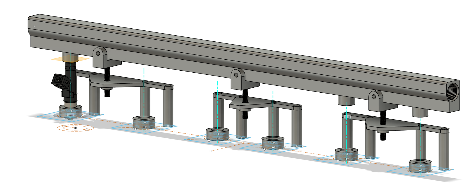

Old Jan 12, 2026 | 07:33 AM
Youngd59's Avatar
Joined: Aug 2021
Posts: 54
Likes: 46
From: Pennsylvania
Sure would be nice if you could make two sets of the fuel rails! They’re exactly what I have been looking for!
Old Jan 12, 2026 | 05:41 PM
BenKenobi's Avatar
Joined: Aug 2020
Posts: 1,194
Likes: 816
From: UK, Glossop
I'd consider making a second pair once I get through the lessons learned on the first ;-) ... be aware that these are not made to suit the hose barb types but a standard top and bottom O ring

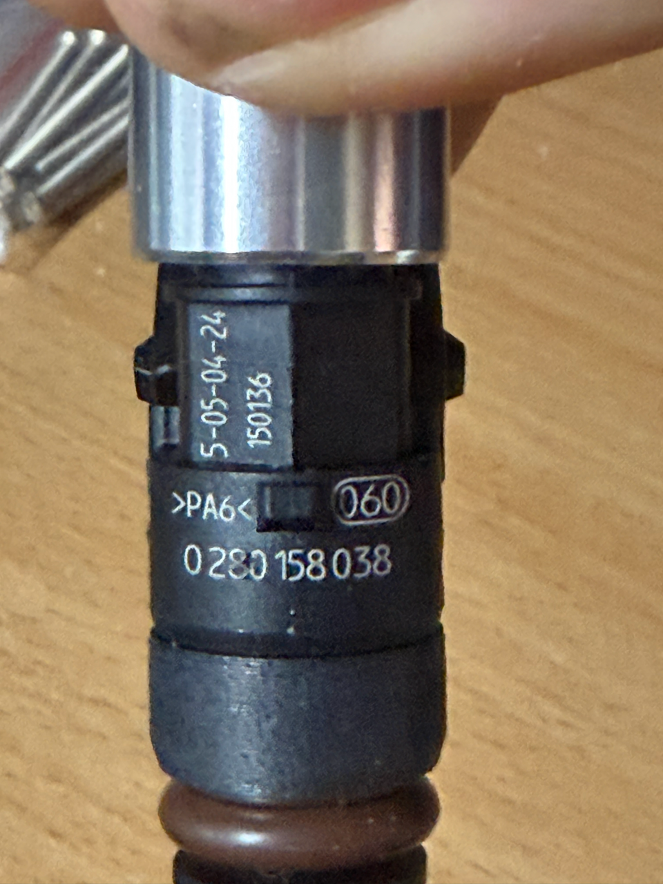

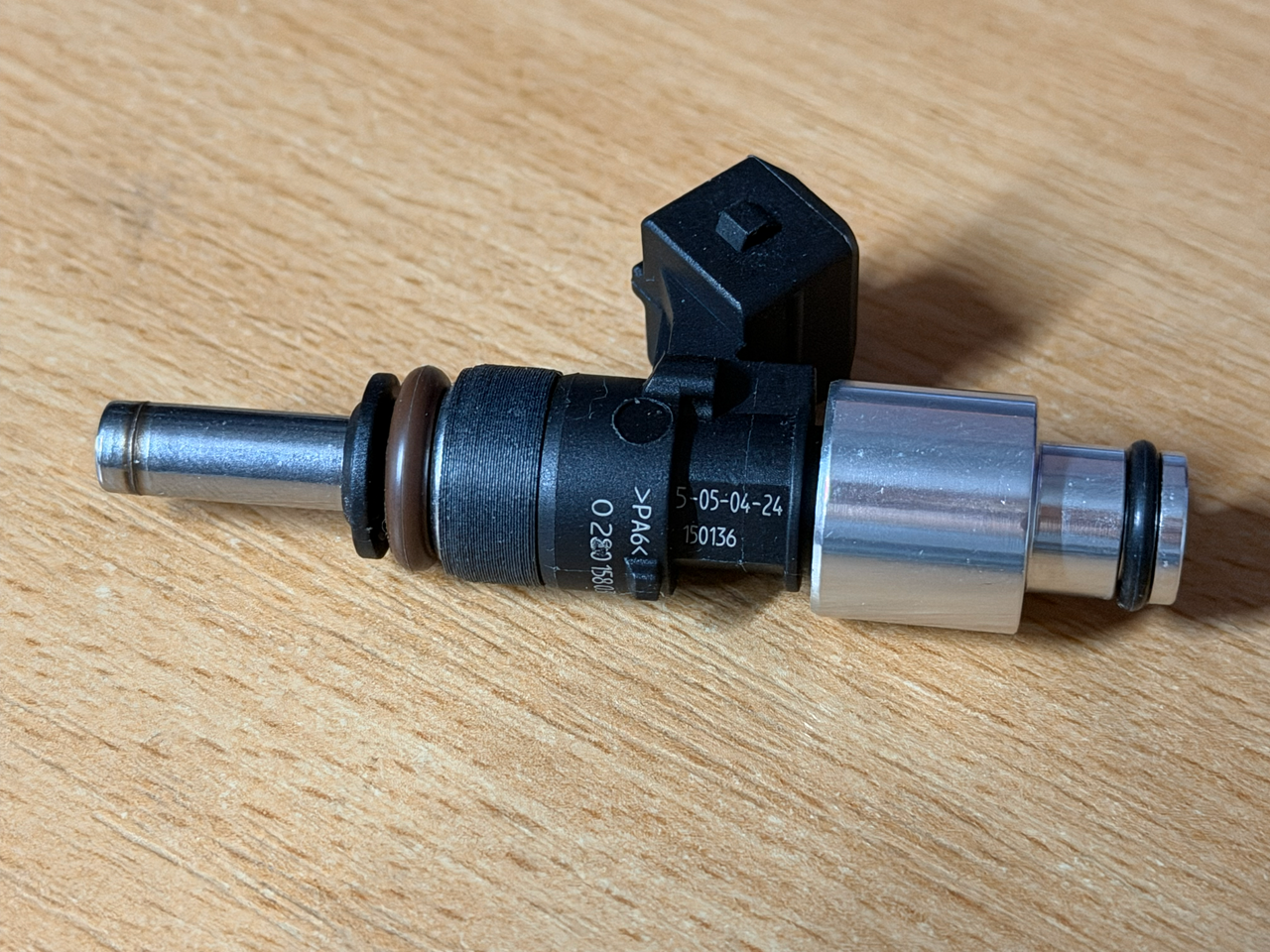

Old Jan 13, 2026 | 12:28 PM
youngd's Avatar
Joined: Oct 2019
Posts: 9
Likes: 15
From: Philadelphia
I am going to go with the Mobeck EFI system. I have the kit but didn't look closely at the injectors to see if they are barbed or use O rings. In any event, I was halfheartedly kidding about you making a second set of fuel rails. I am interested in what you eventually come up with though, as this is something I plan on addressing when the motor is reassembled.
