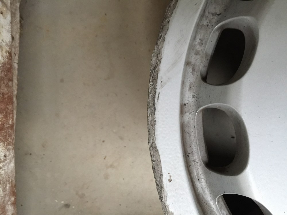

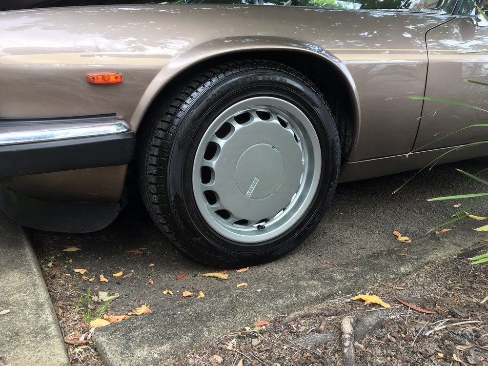

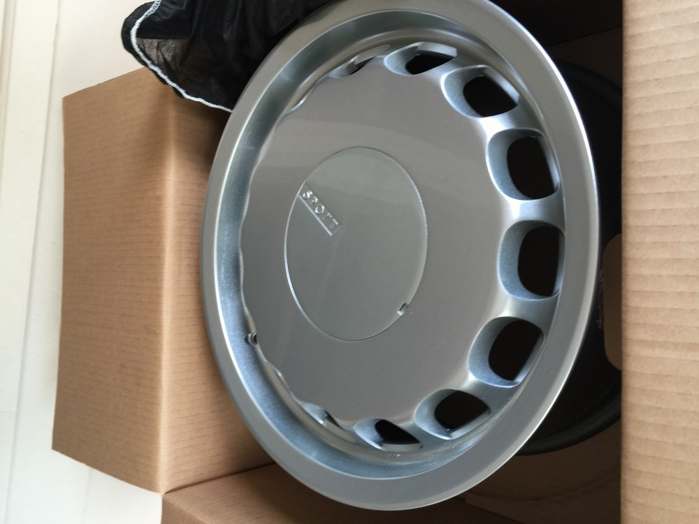

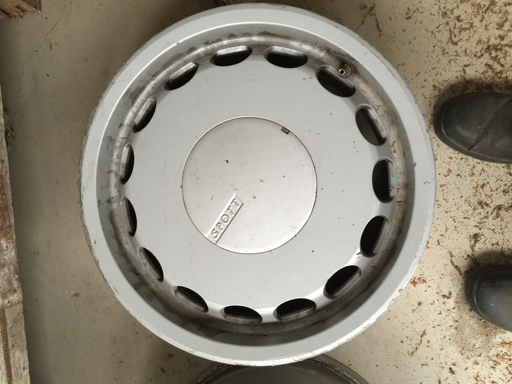

There does seem to be a fair bit more tyre choice in the 16" rim, at least in Australia that is the case.
I've only just managed to take off the aftermarket 16s that were on my car, and replace them with these.... it took me a long time to find a set, and they needed a fair bit of work, but I'm pretty happy with the results!

Old Jan 15, 2016 | 07:44 PM
plums's Avatar
Posts: 9,733
Likes: 2,201
From: on-the-edge
Top job as you say.
How did you get the edges smoothed out?
And paint specifics?
Old Jan 15, 2016 | 07:50 PM
dstary's Avatar
Posts: 102
Likes: 27
From: Sydney
Plums,
I wish I was skilled and/or resourceful enough to refinish those wheels myself! I actually contracted that job to a business that has been doing it for nearly 40 years. They had to re-round some of the rims, fill the gutter-rash, and then paint them, first in silver and then a good few coats of clear with silver flake in it.
If you'd like any more details (paint manufacturer, colour codes etc) just let me know, and I'll ask the questions.
