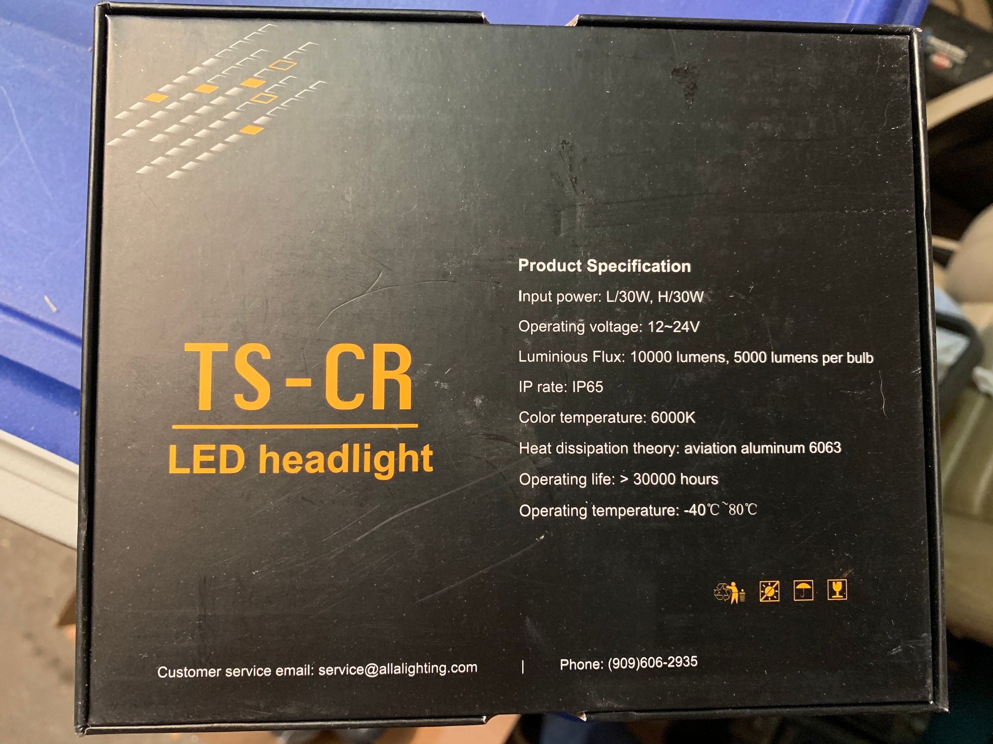

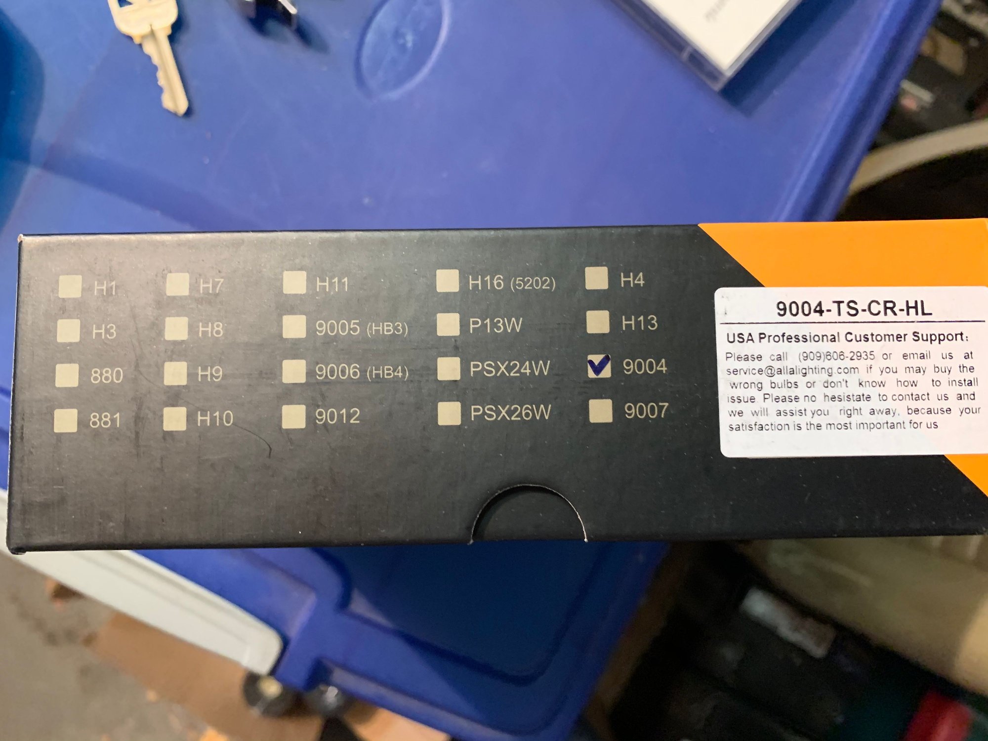

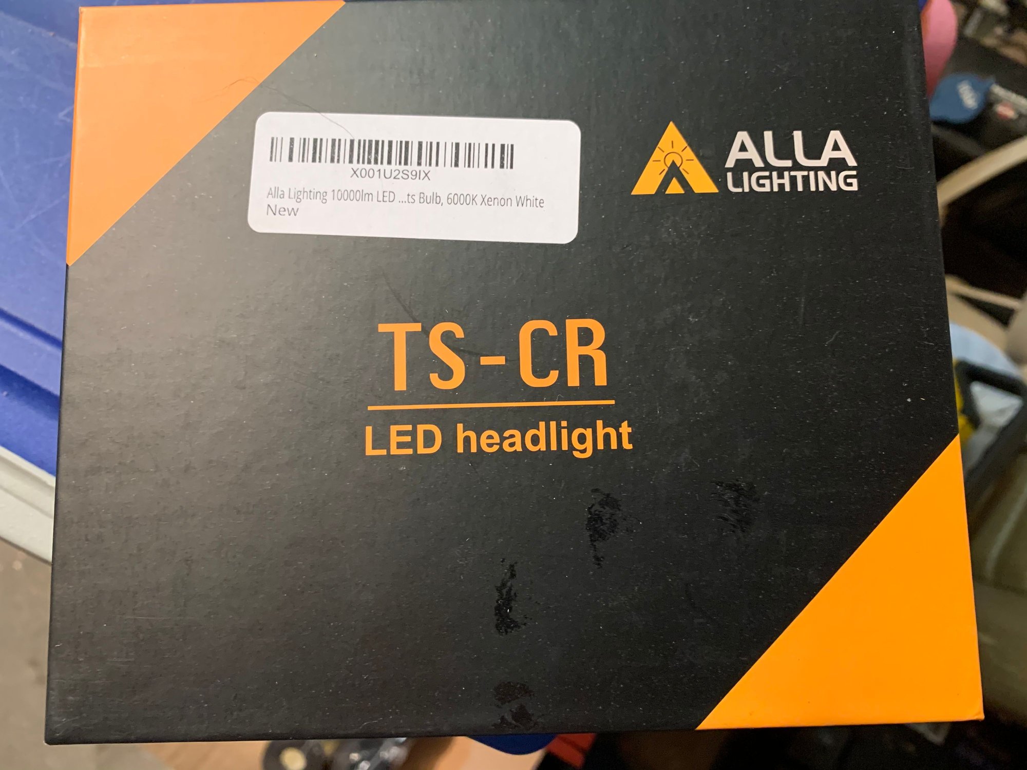

Talking LED Headlights for XJS
I recently replaced my old 9004 (US style) headlights and after about 300 miles on these I whole hardheadedly submit for your approval.
No more dull - yellow - dim - dangerous road illumination .Approx $50 USD per pair.

In what way would my "approval" make some kind of difference?
Would you immediately remove them if I disapprove of them?
OK, coincidently just the other day I was reading about LED car headlights because I was thinking that, since so many new cars come with LED headlights nowadays, they'd be pretty much "proven" by now.
Not that I'm still driving my '94 XJS in the dark because I have already replaced them with HID lights a while back, which provide beautiful illumination to night driving. I have them very carefully and patiently aimed and I have tested them driving another car in the opposite direction and I am absolutely not blinding anybody with them.
But, going back to LED's, since LED's have practically taken over the illumination world, including new cars headlights, I was reading about the fairly high heat that they produce and that some even come with a fan to cool them down. Are yours heating up that bad? One thing that confuses me is why do they get so hot if the only thing that causes heat is high current, yet, these lights generate a bad lamp warning precisely because the car sees that they're not consuming enough current, what gives?

Yes - These have fans on them and no notice of extreme heat build up with drives of over 1 1/2 hours. Initially the car "thinks" there's a light out on start-up and within a few seconds it goes back to "OK".
