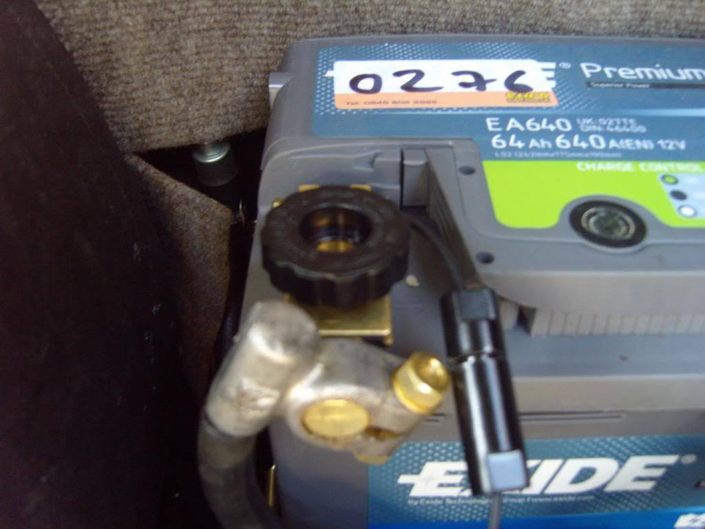

It may not be 'Game Over' although I think you are going to kick yourself for not knowing about that 'Green Knob' on the Battery or else I'll have egg on my face for getting this wrong
But I am 99.9% Certain! That the 'Green Knob' on the Battery is what is known as a Battery Discarnect (ebay about £5) a fantastic piece of kit! more commonly known as a Battery Isolator (I've got these on all my Cars and they are Amazing!)
Anyway lest I digress, if you had know what that 'Green Knob' was and undone that 'Knurled Knob' a couple of Turns, then it would have disconnected the Battery from the Car without having to take the Terminals off
Or else having to remove the Battery for Charging, also with that 'Green Knob' undone your battery would very likely NOT discharge itself if for instance left unattended during the Winter
Where the 'Clock' or 'Alarm' or a Leakage to Earth, could run your Battery Flat
All my Cars are fitted with these and having not been Started or even had the Battery Charged or even taken off the Car during Winter, as soon as that 'Green Knob' is Screwed Back In, the Cars always Start 'on the Button'
Also acts as an extra 'Anti Theft' device, because unbeknown to a Car Thief your Disconnected Battery is also locked in the Boot/Trunk, which is very handy if you have to Park your Car somewhere for any length of time (example Airport)
If 'The Jaguar Gods' are with you, maybe that 'Green Knob' just needs doing up a little bit tighter
(Not 'Stupid Tight'@Grant Frances) but just a little bit tighter and only by Hand
When disconnecting the Battery with this 'Gizmo' you don't need to take the 'Green Knob' off, as all you need do is undo it a couple of Turns

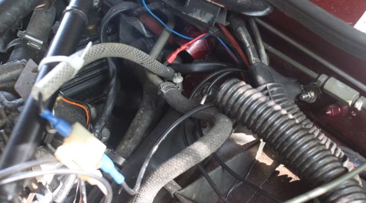

The 'Twitchy' Fuesable Link (Do not disturb!)

Hi UDATDERE
'You've Cracked it!'
Your Problem is almost certainly down to that Fuesable Link (see photo above) and so take off that Battery Lead and pull those Spade Connectors apart and really clean everything up before you put it all back together again
Then when you've got your Car Working, as I'm sure you will, then don't even think about moving that Battery Lead, just in case that 'Super Twitchy' Fuseable link decides its time to go on the rampage again!
Don't give up, you're nearly there! 'Well done!'

I use the battery disconnect on my 96 all of the time. My first one went bad and even with the knob screwed all the way tight, I still did not have power to anything. I thought I had fixed it, but heard a clicking noise under the hood while the engine was running. Turns out the switch was intermittently making and breaking contact. Luckily no damage was done. My advise would be to purchase a new disconnect switch.
