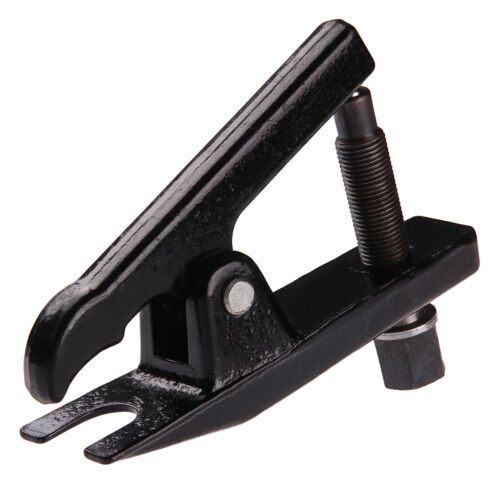

If the inner pivot pins are out, and the wishbone flopping around, that wont work. The option then is a balljoint splitter. Like the one in the snap I stole from google.

I have had nothing but success on all cars I've worked on with the tool GFrancis suggests above. Usually remove the bolt completely,,, then turn it back on 5 turns or so,,, and use the pinch tool. Then, cranking it down, I don't go toooooo far with torquing with several hammer blows in between wrench turns. Usually it'll POP and the bolt will keep things from flying apart. From memory,,, I think I left those bottom 4 1/2 inch bolts til last. It'll go,,, just have to get the right combination of pressures and blows.
