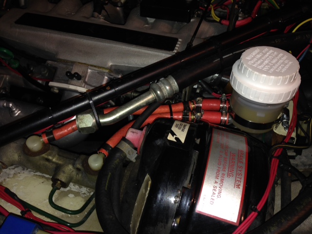

FWIW, replacing the OEM container with one from a Mitsubishi is cheap and easy. It uses a magnetic float which is more reliable than the Jaguar piece of cork. Plus it doesn't let air in like the OEM part, which means your brake fluid won't look like syrup so soon and you won't need to bleed the brakes as often.
You can get the reservoir online for under $40, and new hoses can be found at the local hardware store (air line hose) for not too much.
John
1987 XJ-S V12
63,000 miles
