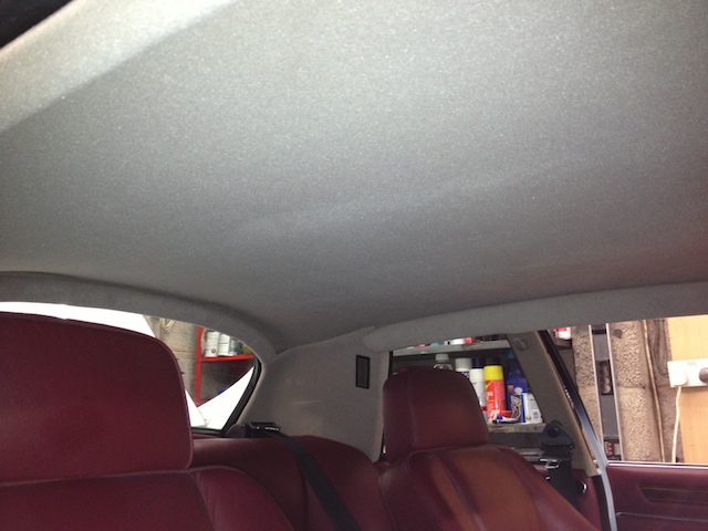

here is a pic from underneath , i refurbished this myself last year ,
this was before i cut out the sunroof hole
so , as for the motor , it may well be fubar, but it will be better to have it refurbished than try and get a replacement , as you won't , the XJ6 or XJ40 motors will not fit , it could be the switch , or power supply fuse where i mentioned , there is also a relay by the motor for direction change for the tilt and run ,

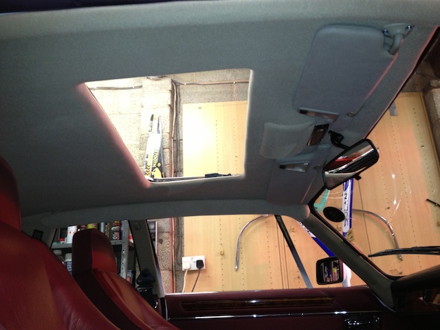

you can just see the smoked glass sunroof ( moonroof ) in this picture of my restored car
