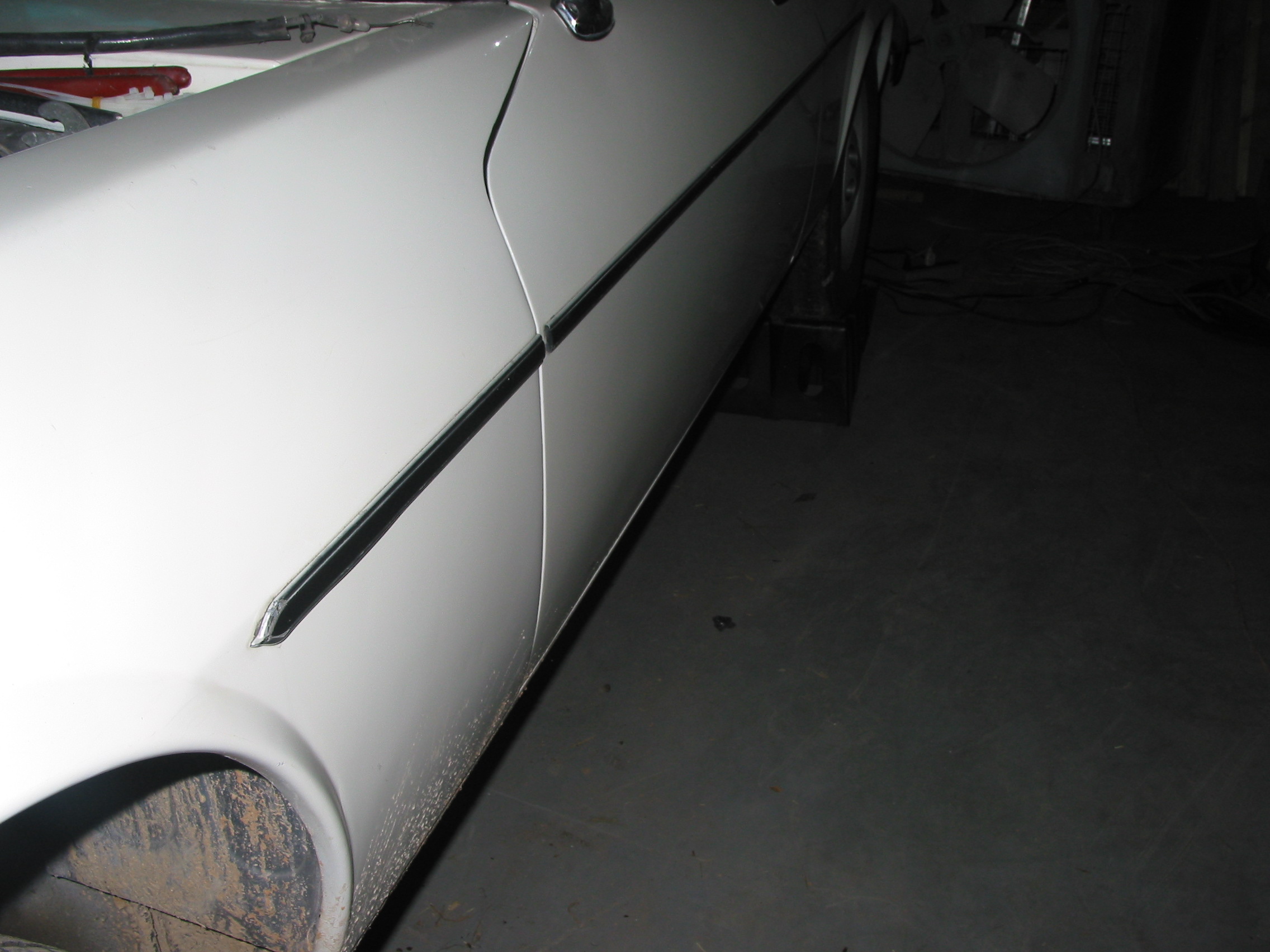

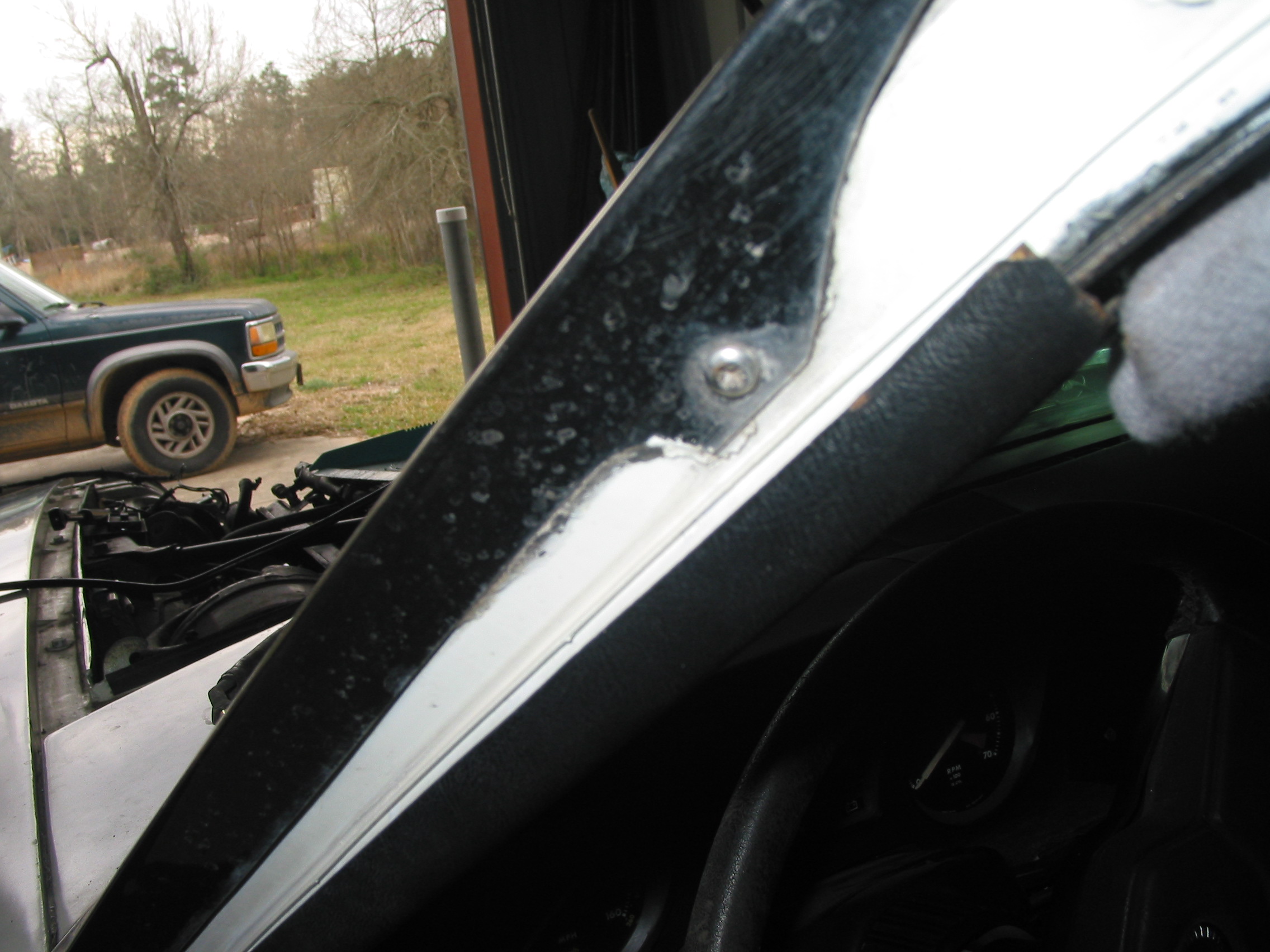

Thanks a lot for that info. I may have started to pry it off not knowing better. I also read that the side trim is riveted on. I thought it was the stick on stuff, but I guess not. Would I have to drill out the rivets from inside the fenders and doors to remove that?
Old Feb 24, 2013 | 11:01 PM
  #72
magnoliav12's Avatar
Joined: Jan 2013
Posts: 70
From: Magnolia Texas
Default Trim Pieces
Ok, I took some pictures of it for anyone who wants to see. One is of the pillar trim. As it turns out, I didn't even have the rubber in there to begin with, so it made it easier to see the screws. I'll have to find an appropriate source for the rubber gaskets after I'm done with the body work. The other pic is where the screws are located in the bottom trim piece that Greg pointed out. I do have to remove the windshield wipers and the piece on the cowl that's obstructing them. Also added a picture of the side trim that I was referring to earlier. The side trim looks just like the stick on stuff, but I heard that it's riveted in.
Attached Thumbnails My 92 XJS Conv Build Thread-bottomwindscreentrim.jpg   My 92 XJS Conv Build Thread-pillartrim.jpg   My 92 XJS Conv Build Thread-side-trim.jpg
Old Feb 25, 2013 | 02:29 AM
  #73
Greg in France's Avatar
Posts: 14,607
Likes: 10,802
From: France
Yes, you have to remove the wiper grille assembly to see the trim fixings below the screen bottom.
Cannot help with the side trim, except to say it was not fitted at the factory, they were dealer fitted and I think USA only. If the side trim is metal with a rubber insert (which it looks from your photo to be), pull out the rubber and see if there are fixings below it, which will be pop rivets, I expect. If it is one-piece, it is very unlikely the dealers did anything other than stick it.

That sounds like a good idea. I'll see if the rubber pops out. It looks very much like the stick on stuff I've used before on other vehicles, but I'll see if that pops out.
