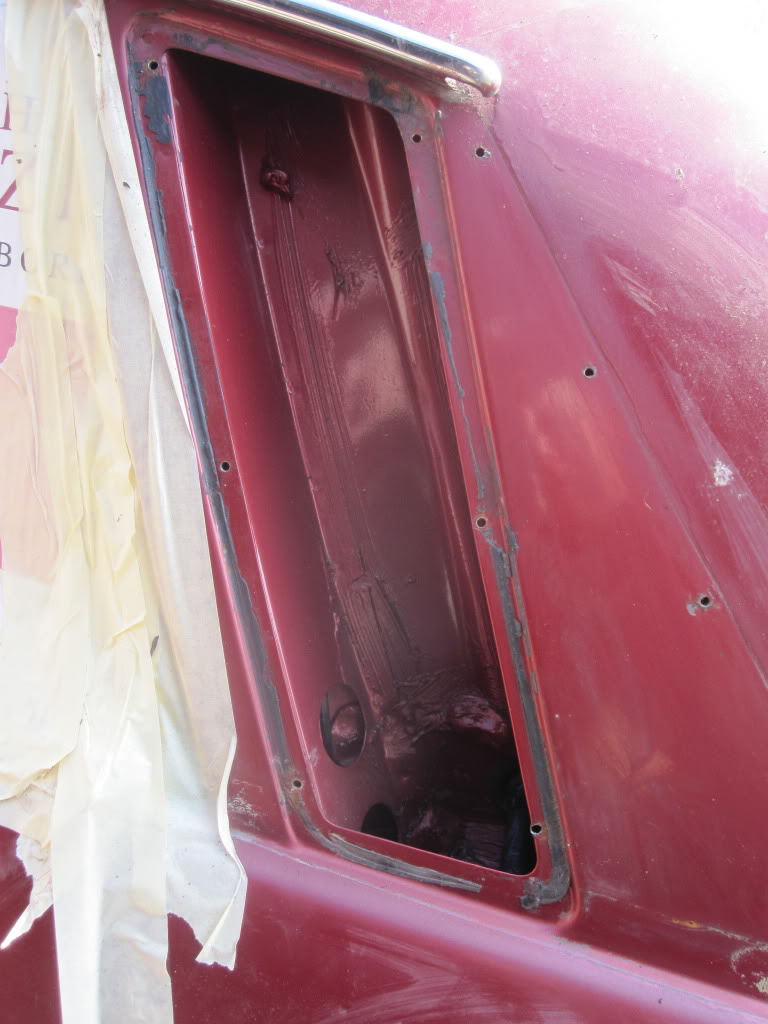

How did you get the chrome trim off without removing the side quarter windows?
I took all mine off over the weekend and it was PITA, good job though as the rivets holding the trim on were corroded both sides.
Old Jul 22, 2012 | 04:18 PM
  #103
R44chopper's Avatar
Posts: 42
From: Bedfordshire. UK
I just gave mine a good tug and out they came because of said corrosion. RS do some good plastic rivets that I have used with great success to re-attach all the chrome trim.

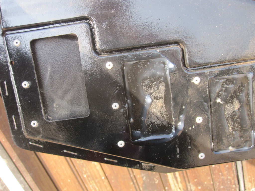

While you are in there, it is worthwhile taking out the non - return flaps under the black trim. I glued shut the bottom two, and removed the top one. You will be surprised at the silence that ensures once theses little flaps stop clicking about!
Greg
I was planning to discard these and install a blanking plate. Mine was full of wasp mud nests and a dead spider - have you seen Aussie spiders huge buggers.

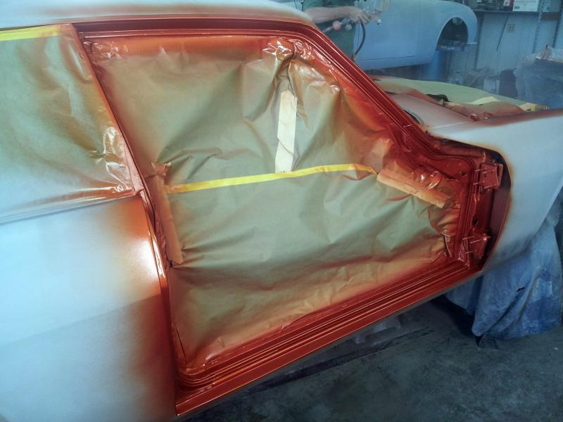

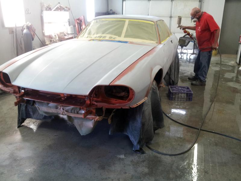

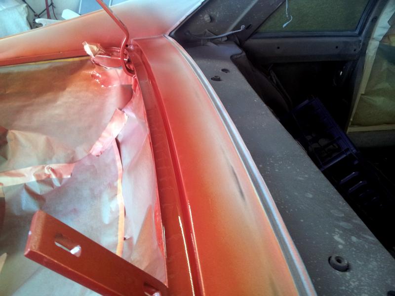

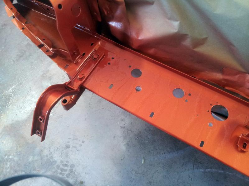

Old Aug 31, 2012 | 11:02 AM
  #110
Mish_Mish's Avatar
Joined: Jan 2011
Posts: 883
Likes: 173
From: Columbus, OH
Prep goes on...

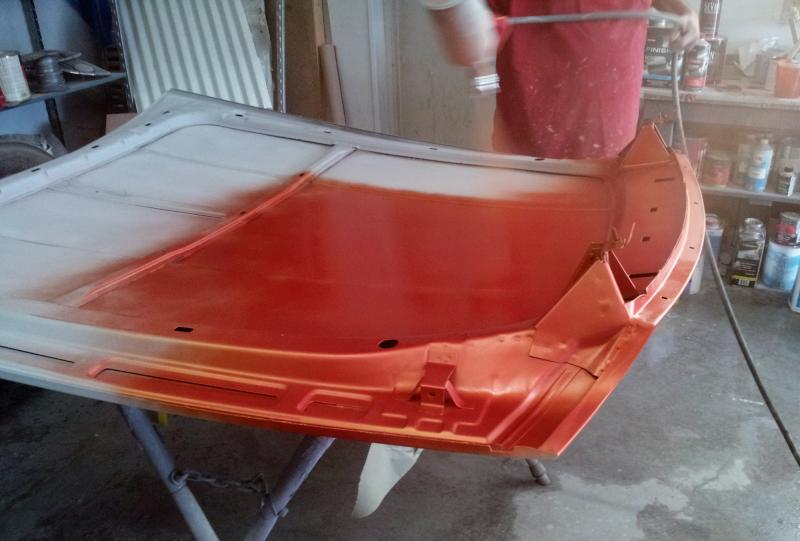

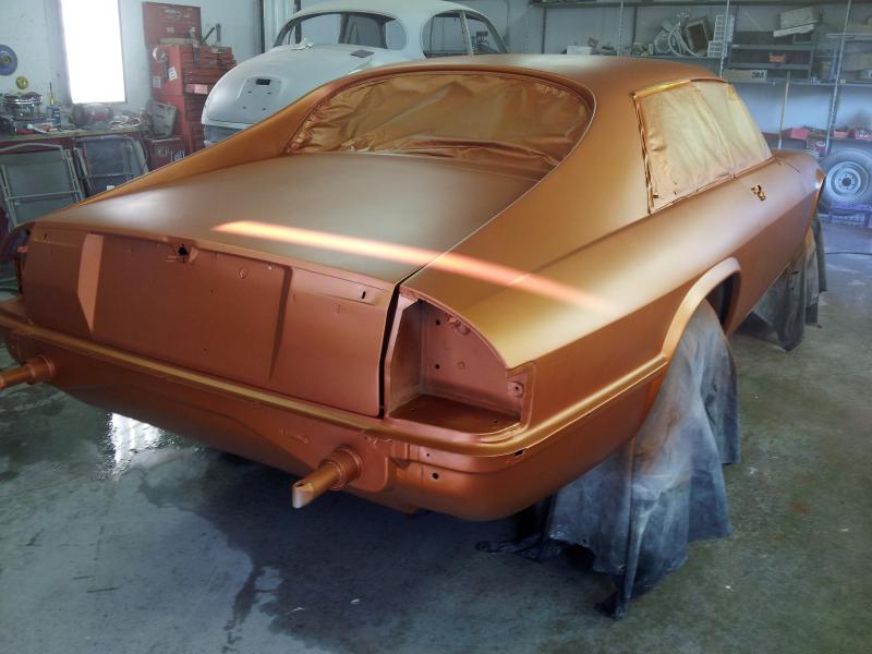

Old Sep 13, 2012 | 11:31 PM
  #111
Mish_Mish's Avatar
Joined: Jan 2011
Posts: 883
Likes: 173
From: Columbus, OH

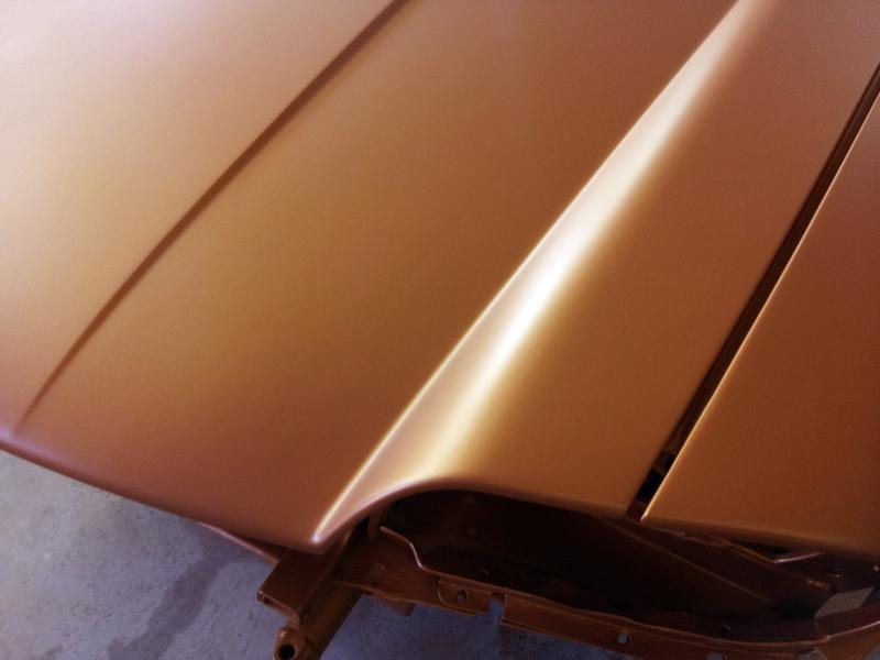

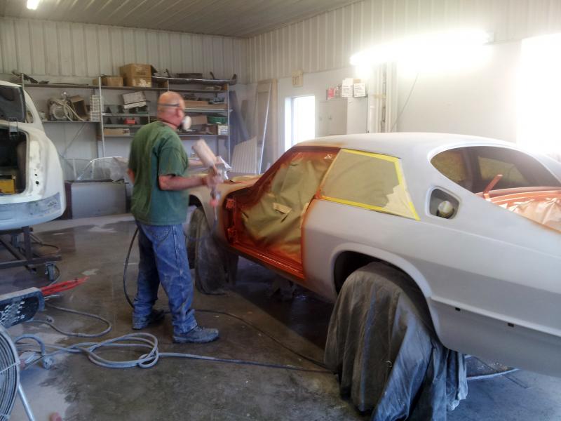

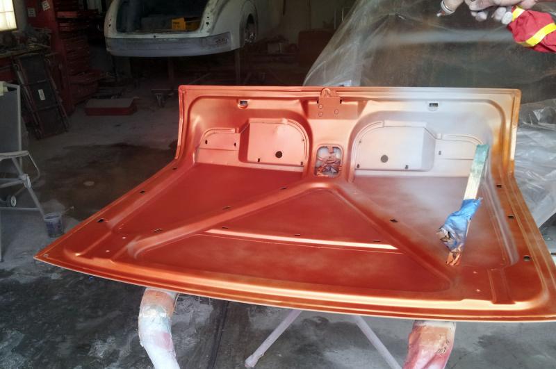

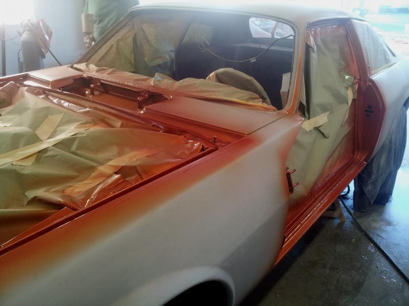

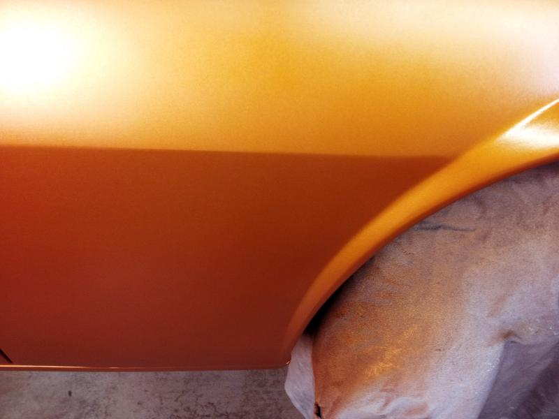

See the color, what do you think?
Attached Thumbnails Is my XJS the oldest here?-20120913_165326.jpg   Is my XJS the oldest here?-20120913_165843.jpg   Is my XJS the oldest here?-20120913_172213.jpg   Is my XJS the oldest here?-20120913_172430.jpg   Is my XJS the oldest here?-20120913_174037.jpg
Is my XJS the oldest here?-20120913_174047.jpg   Is my XJS the oldest here?-20120913_174345.jpg

Default paint color
great pics, am starting my project also , question on color
what color are you using, I was thinking of shooting
the Italian racing red metallic, just wondering
Old Sep 14, 2012 | 10:07 AM
  #113
Mish_Mish's Avatar
Joined: Jan 2011
Posts: 883
Likes: 173
From: Columbus, OH
This is PPG Deltron DBC, code WA418p, Atomic Orange Pearl.
Deltron DBC is arguably the best paint money can buy.
BTW, I have gallon of same Deltron in Candy Apple Red Pearl that my wife turned down (too Communist for her taste apparently). Will put it on eBay in few days.

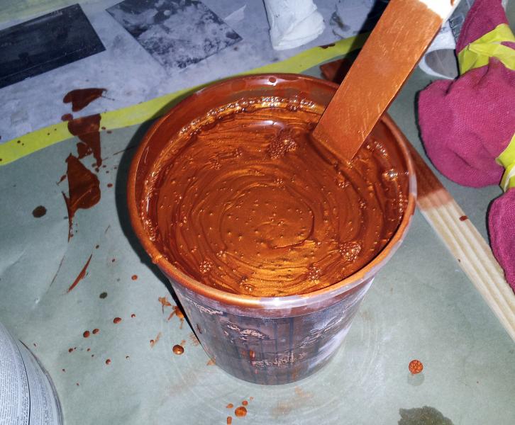

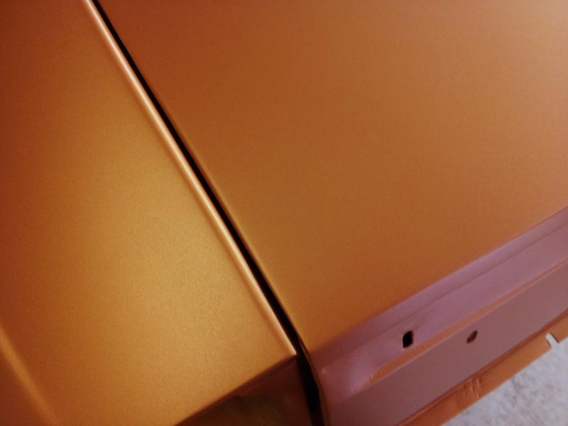

Old Sep 25, 2012 | 11:07 PM
  #116
Mish_Mish's Avatar
Joined: Jan 2011
Posts: 883
Likes: 173

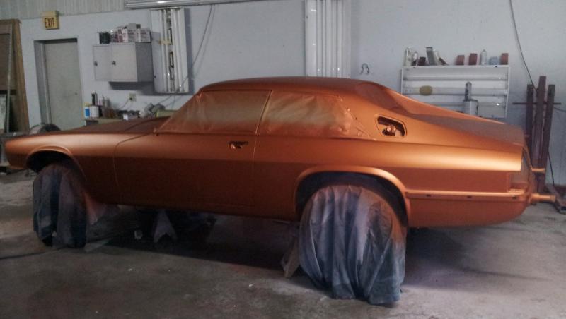

From: Columbus, OH

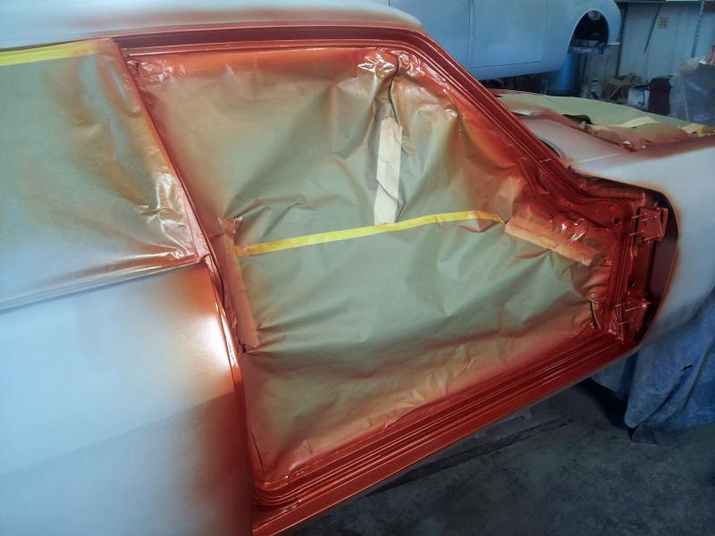

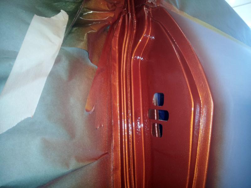

Attached Thumbnails Is my XJS the oldest here?-20120924_183158.jpg   Is my XJS the oldest here?-20120924_183206.jpg   Is my XJS the oldest here?-20120924_183224.jpg   Is my XJS the oldest here?-20120924_183246.jpg   Is my XJS the oldest here?-20120924_183302.jpg
Is my XJS the oldest here?-20120924_183314.jpg   Is my XJS the oldest here?-20120924_183321.jpg   Is my XJS the oldest here?-20120924_183339.jpg   Is my XJS the oldest here?-20120924_183838.jpg   Is my XJS the oldest here?-20120924_183843.jpg

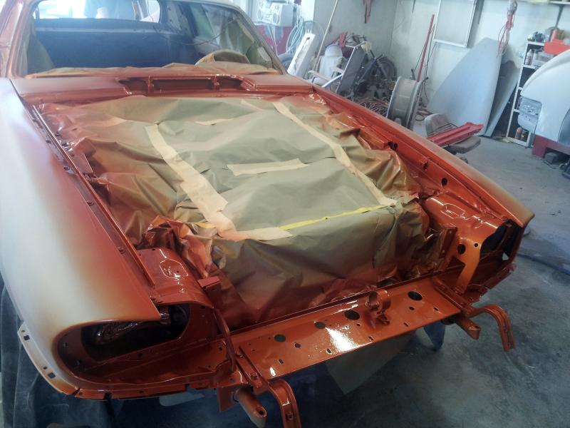

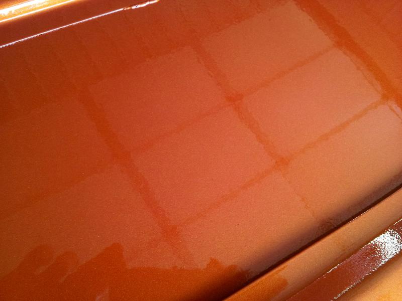

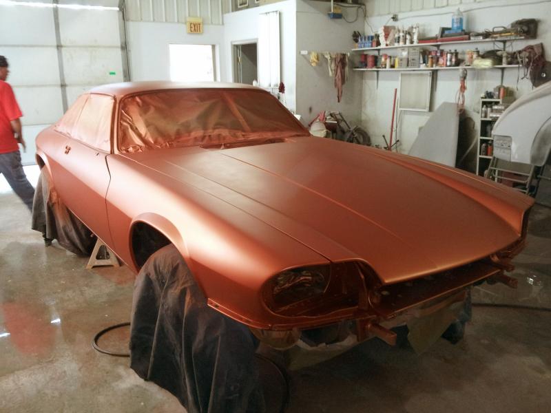

Old Oct 4, 2012 | 07:30 PM
  #118
Mish_Mish's Avatar
Joined: Jan 2011
Posts: 883
Likes: 173
From: Columbus, OH

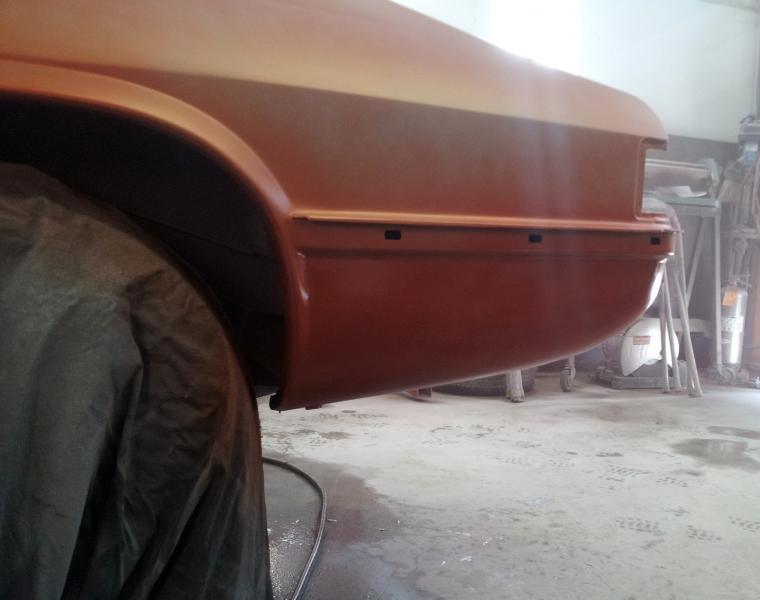

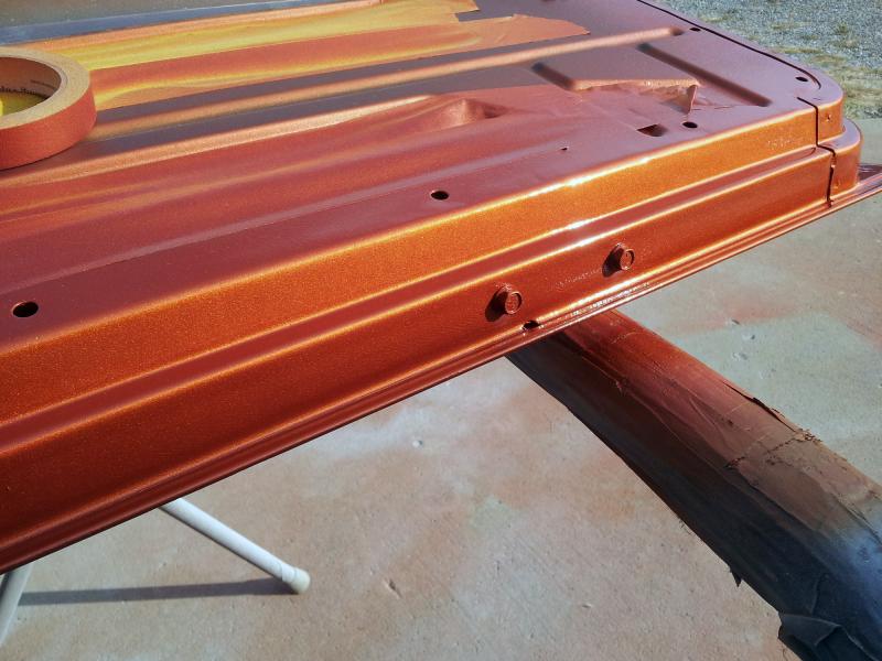

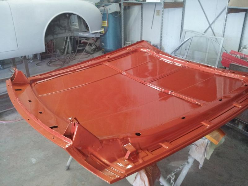

No clear coat yet, tomorrow we will do the spit shine on her!
Attached Thumbnails Is my XJS the oldest here?-20121004_161438.jpg   Is my XJS the oldest here?-20121004_162129.jpg   Is my XJS the oldest here?-20121004_162817.jpg   Is my XJS the oldest here?-20121004_165042.jpg   Is my XJS the oldest here?-20121004_165121.jpg
Is my XJS the oldest here?-20121004_170204.jpg   Is my XJS the oldest here?-20121004_175936.jpg   Is my XJS the oldest here?-20121004_180001.jpg   Is my XJS the oldest here?-20121004_180053.jpg   Is my XJS the oldest here?-20121004_180157.jpg
