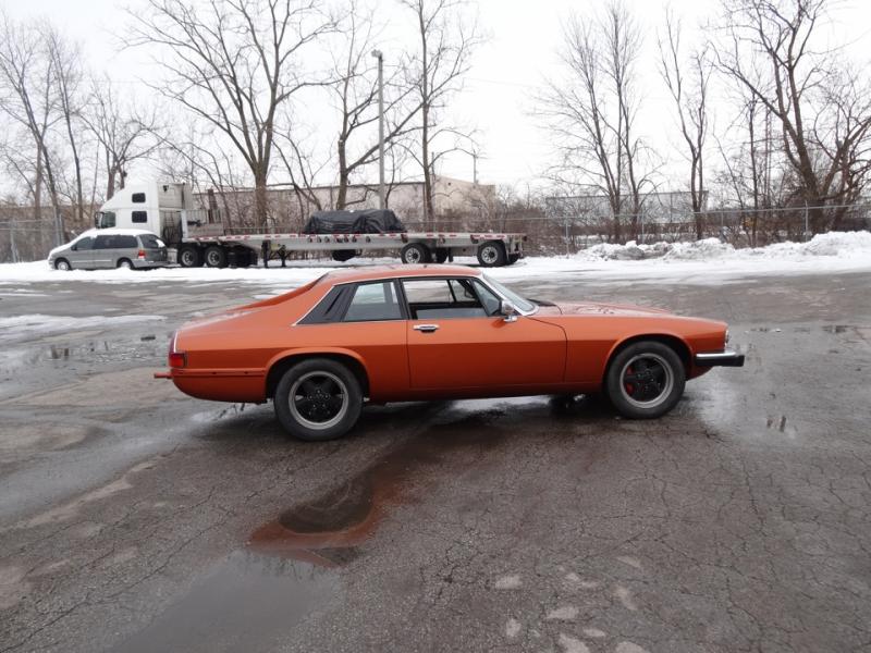

I notice the stance, especially the rear height. -What is the trick to the inch lift in the rear? -Certainly doesn't look like stock suspension. I have new adjustable Koni's and new springs going in next week.
No trick, this is what stock '87 shocks and springs look like with extra weight removed from the car. I have no exhaust, bumpers, interior and A/C in the car right now.

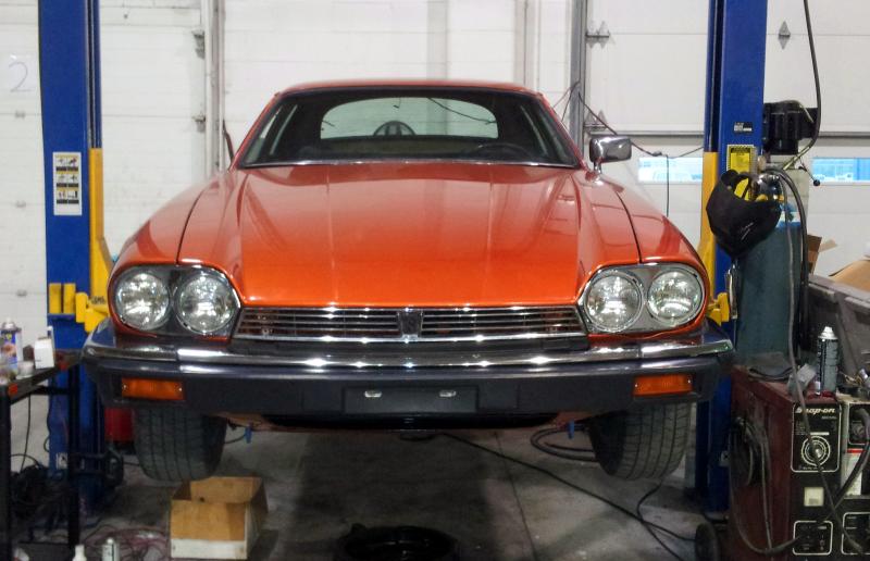

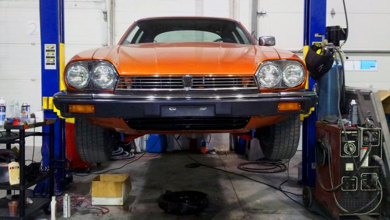

Front end is done.
Attached Thumbnails Is my XJS the oldest here?-20121115_170229.jpg   Is my XJS the oldest here?-20121115_170239.jpg

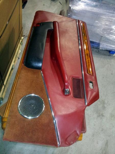

Some pics...

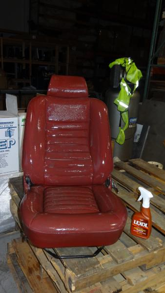

Talking to myself here, but still...

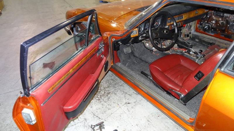

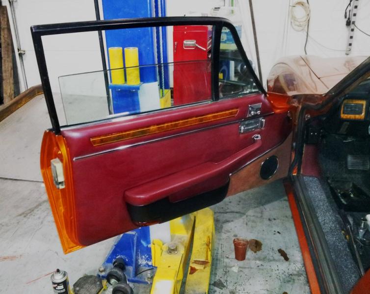

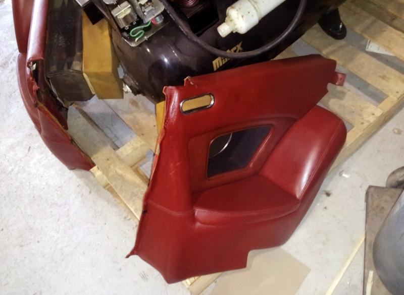

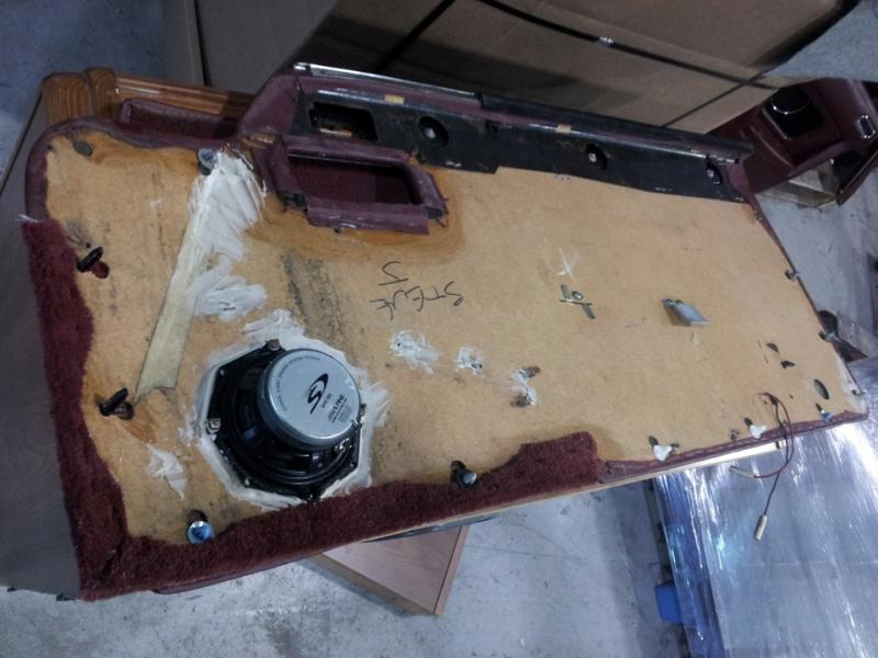

Old Jan 13, 2013 | 01:45 AM
  #145
Greg in France's Avatar
Posts: 14,583
Likes: 10,777
From: France

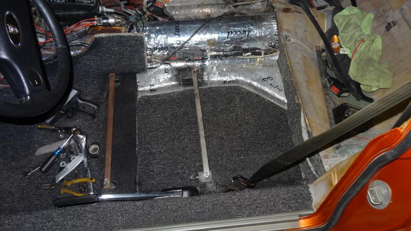

Mish
What is that modern-looking insulation on the floor, please?
Also, what are the steel rods across the seat mountings to be used for?
Car looks great, so you are talking to at least one person!
Greg

Against metal is Eastwood brand sound and heat insulation, fairly cheap stuff compared to the rest. Second layer is automotive / industrial carpet under layer, sold in carpeting supply stores. It is similar to original wool/fiber stuff, but does not ignite like gun powder.
Cross beams are adapters for UK spec seats, I am using. Original interior was beige and all messed up, so I bought 1987 interior from UK years ago. For some reason seat mounting pattern is slightly off. I am actually thinking of welding in permanent solution.
The seats are not just UK spec, but pre 'semi-facelift' ones. In about 1987/8 the seats were changed to Recaro style ones, that had seat mountings about 1.5 inches closer together. At this time the Aircon was changed to the Delanair Mark III, and the column switchgear modernised as well. So I guess you have bought a just pre semi facelift interior, the only difference AFAIK being the front seats. FWIW I find the seats you have (and that I have in my 1985) are more comfortable, and give significantly more rear set room as the backs are thinner.
If you do reweld the mountings (good idea IMO) it is just the sill-side ones that need to be changed.
Are the speakers anything special?
Greg

The seats are not just UK spec, but pre 'semi-facelift' ones. In about 1987/8 the seats were changed to Recaro style ones, that had seat mountings about 1.5 inches closer together. At this time the Aircon was changed to the Delanair Mark II, and the column switchgear modernised as well. So I guess you have bought a just pre semi facelift interior, the only difference AFAIK being the front seats. FWIW I find the seats you have (and that I have in my 1985) are more comfortable, and give significantly more rear set room as the backs are thinner.
Greg
Thanks for the info. I should have re-welded mounting areas prior to doing the interior carpeting. I will weld square plates to original points, so I could drill perfectly positioned holes as the sit placed.
Speakers are new, front Alpine SPS-410 and rear SPR-60, head unit is one of the modern Pioneers, with USB and HD radio. I picked one that looked good in XJS interior, with round chrome knob.
Not sure I'm digging the interior color with the exterior? Hum........

Work in progress, will do for now, other expenses are killing interior budget.

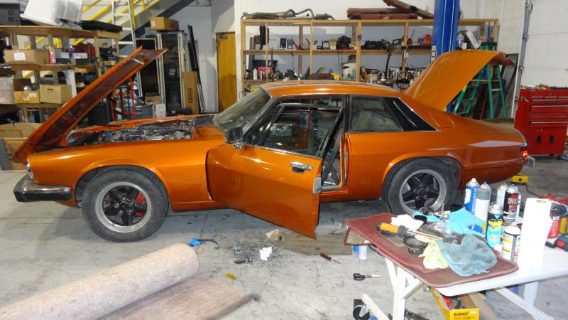

Still talking to myself, but this is out first outing with 5-speed. Wild beast is reborn.
