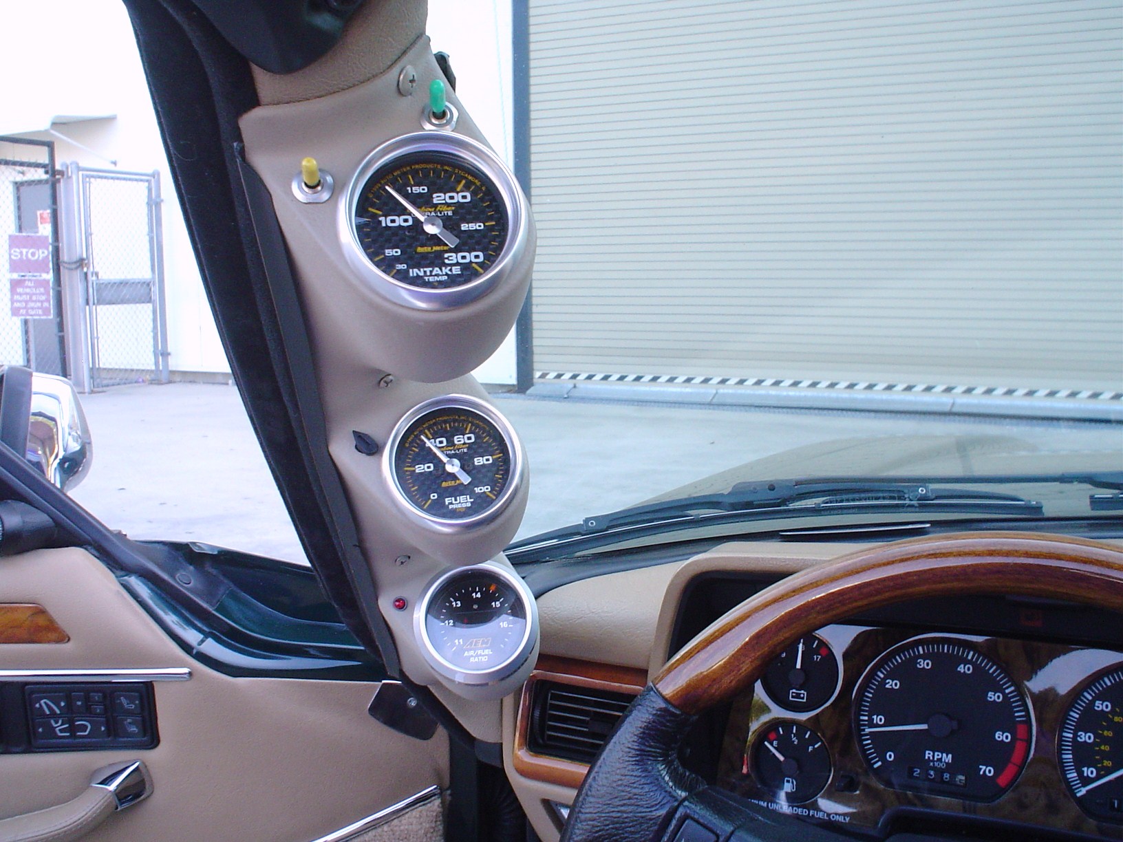

Just google three-gauge pod and you'll see lots of hits. That's the way I found mine many moons ago and this is what it looks like:
The bottom gauge is an Aem wide band AFR gauge.
And here's a pod from a popular place (inexpensive, too):
Amazon.com: GlowShift Universal Triple Gauge Gray A Pillar Pod: Automotive Amazon.com: GlowShift Universal Triple Gauge Gray A Pillar Pod: Automotive
Reinaldo

Some tips:
You will not find a pod that will perfectly match the XJS' pillar.
Measure the width and length of the A-pillar as it is now and try to get what's the closest to that.
Then comes the Michelangelo part: you need to sculpt using a knife and a hair dryer to carefully trim what needs to be removed at the edges and to precisely change form where needed. I couldn't possibly provide details as to what was done where because, like I said, it's been too long to remember. But this will give you the correct pod that fits your A-pillar like a glove.
Oh, I realize that you wanted only a two gauge pod, but I posted a 3-gauge pod link; still, there are plenty of the 2-gauge pods and one's as well. Or, perhaps there is a third gauge you may want to add while you're at it...
Good luck!
Reinaldo
