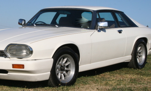

what do you guys think of minilites on the XJS?

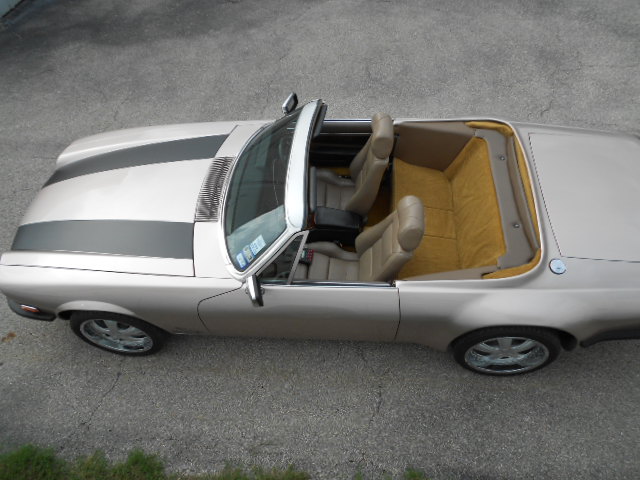

wheels are like opinions, everybody thinks there are the best!
fair enough, i think mine make the XJS look like a smaller car, which is fine with me!
Attached Thumbnails New wheels and tires-mazda-jaguar-001_copy.jpg   New wheels and tires-jag-overhead-004.jpg

275-35-18,, Nitto rears,, KDW frts

I've oft wondered how a set of Minilites would look on an XJS
Minilite,Minilite wheels,historic and classic car wheel replacement,competition and Classic Car Enthusiast,mini lite wheels
Vintage car, vintage wheels. I dunno. Just a thought
