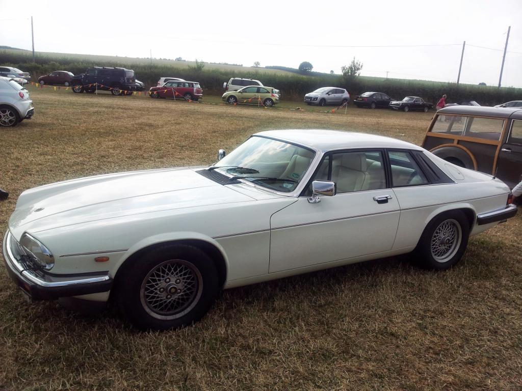

Hello, here's my new XJS - got it delivered on Friday and I'm enjoying it very much so far
Couple of issues I've noticed:
1. Hunts a bit at idle, don't really notice the revs go up much but you can hear it
2. Can't seem to get the cruise control to work
3. Aircon seems to do very little, the two vents on either side seem to blow no air at all.
4. Don't know if this is by design, but when you turn the lights on, a dash light shows they're on but this light then goes off after about 15 seconds which I find a bit weird?
5. Can hear a squeak coming from the passenger side (RHD car) while accelerating.
Apart from that, enjoying cruising around town at 11 mpg!
Attached Thumbnails New XJS-jagfill2_zps5ac41280.jpg   New XJS-jagwork_zps2122dc00.jpg   New XJS-jag_zps492c7406.jpg
