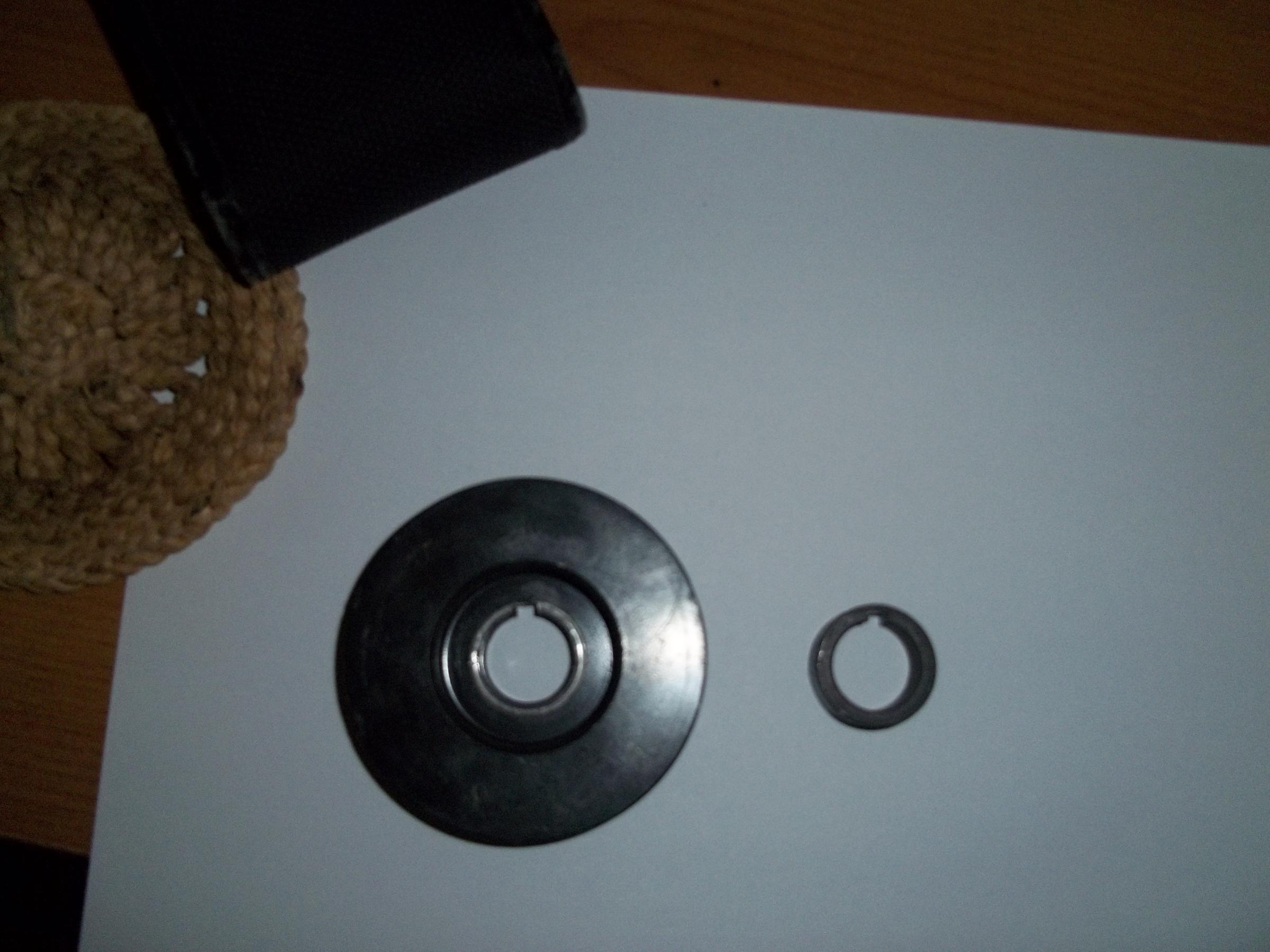

earlier this year I fitted a 115 amp alternator but had started to hear a twittering noise when pulling away after starting, I removed the alt. today and the noise turned out to be pulley not being able to drive the alt. when its pumping high amps. the nut was as tight as even I could get it but it wasn't enough, there is provision for a woodruff in the drive end of the alt but no
provision on the v pulley supplied with it. I whipped it down to the local machine and the slot was cut in the spacer and pulley £15.00 well spent I hope plus the usual bearing Loctite,

all back and ready for reassembly

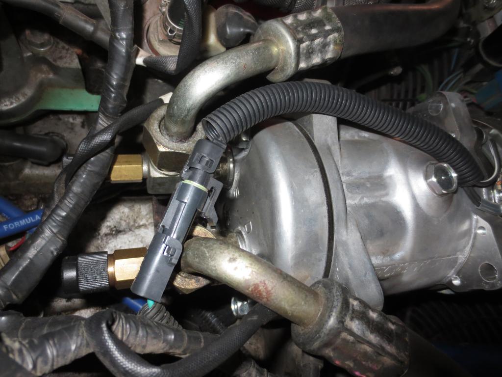

change of subject, when you fitted a sanden compressor Greg did you dispense with the silencer and does it make a difference
Yes, I did, on the advice of a very renowned specialist who at that time serviced the car (I was not retired at that point). Made absolutely no difference at all. The hoses come straight out of the compressor. Been like that for 12 years and aircon is fantastic.
Plus the Sanden can be fitted with modern charge ports, so the latest aircon machines can connect right up for dianosis, vac testing and charging.

AND the plugs are much easier!
