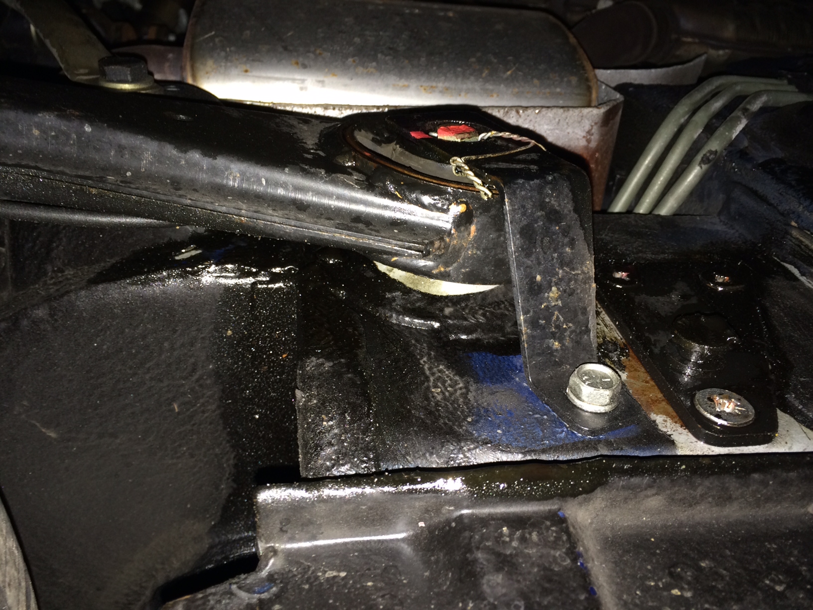

I was wondering if anyone could help me
I have a leak from the bottom of the car
near or behind the driver door, USA, so left hand side around the wheel well
I have looked under as much as I can and it seem to come from a joint where the suspensions are
I will attached 2 pic
I am assuming some bushing need replacing
and assuming this is some brake fluid?
please help
ab
Attached Thumbnails oil leak behind drivers seat xjs conv 1996-photo.1jpg.jpg   oil leak behind drivers seat xjs conv 1996-photo.jpg

the color of the fluid is clear, so I am guessing it is brake fluid

You sure it isn't fluid from the top?
If it was brake fluid all of the paint and undercoating would have peeled off.

Be careful to check this urgently as those are your fuel flow and return pipes that are running there. Is it petrol that's leaking?
By the way, it's great to see such a good condition underside for the radius arm mount! I'm guessing this is a very low-mileage car!

Check conv hood lift fluid

I think you are absolutely right
the conv auto top has not been working
you are the man
do you have any idea, what I do next

I am completely unfamiliar with the convertible system in the XJS. You need to locate the hoses,pump,etc and inspect them until you find what is leaking.
I can only guess that it is behind the rear panel, I don't think it is in the trunk because the convertible trunks I have seen have the same panels. Hopefully someone can chime in that knows more about the convertibles.
You could always remove the panels behind the seats and the panels in the trunk to look around for access. That's what I would end up doing.

Yes, the convertible pump is in the boot above the battery.
It's not impossible, but i would still think it unlikely that hydraulic hood fluid would get from the left hand ram (the pump is on the right) to the left radius arm which is under the body. I guess it could perhaps work its way down and out? It's not common for the rams to leak.
