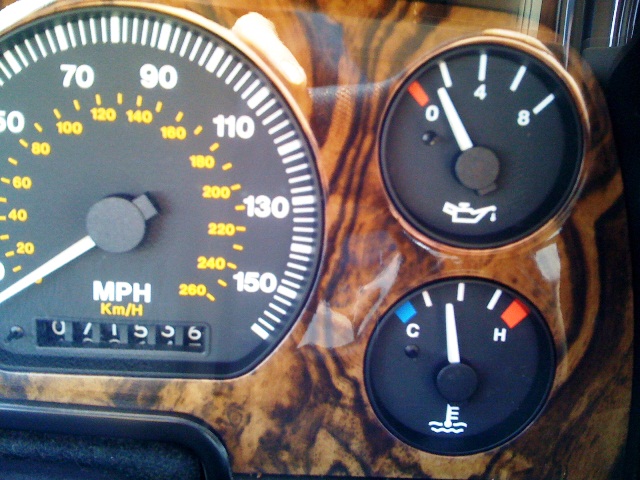

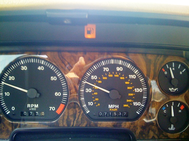

Here are my readings from my gauge while the car is at it's "normal" operating temp. 60 degrees outside, car has been running for over an hour, highway driving at 80mph.
First pic is while driving, second is stopped a light. It seems way low, notice my temp gauge never gets to "N" either. The car sounds great though, the oil pressure does go up while driving. At first cold start of the day it goes to 6. How's yours?

I have less oil pressure than you (My gauge will read 0 at warm idle, but the idiot light doesn't come on)
I have more temperature than you (My gauge gets up to the middle and stays there, mostly with the help of the electric fan cutting in and out)

Low oil pressure when warm and at idle is normal for the V12s...maybe 5-8 psi or so.
As for coolant temp gauges.....
At some point Jaguar when to a "fixed reading" temp sending unit that always reads at the exact same spot on the guage unless the coolant get wayyyyyy hot... then the needle moves over. Not sure when the change was made on the assembly line but the later type sender is often sold in place of the original.
Later Jaguar did the same thing with oil pressure gauges
