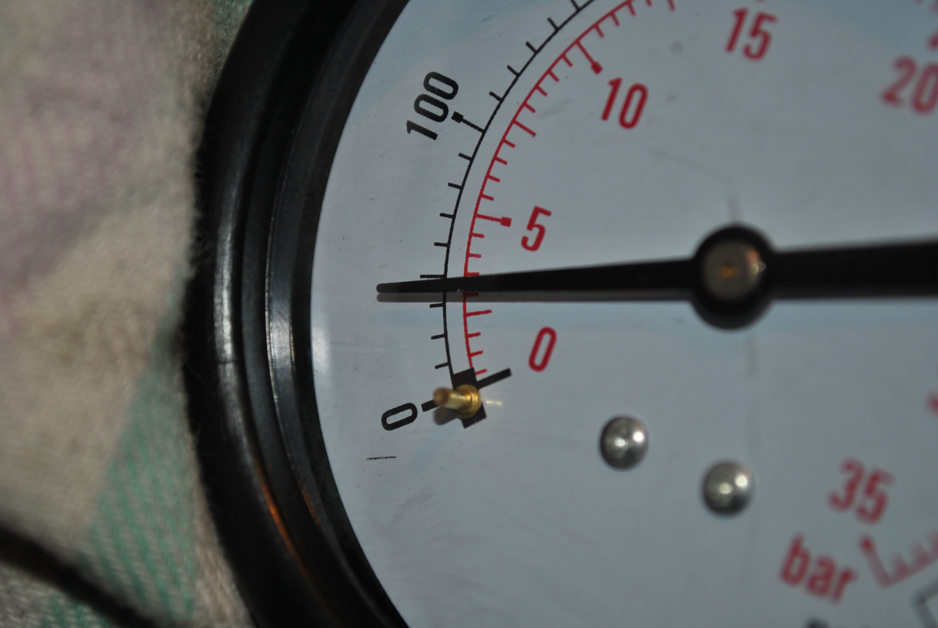

You could buy one of these off ebay (about $60 from memory) for peace of mind.
Mine always showed 0-20 psi and the light came on at idle.
Oil pressure: Would you panic at this?-dsc_6549.jpgOil pressure: Would you panic at this?-dsc_9553.jpgOil pressure: Would you panic at this?-dsc_0984.jpg
Not a problem now with new engine and senders, gauge always shows a solid 70 psi except at idle now.
