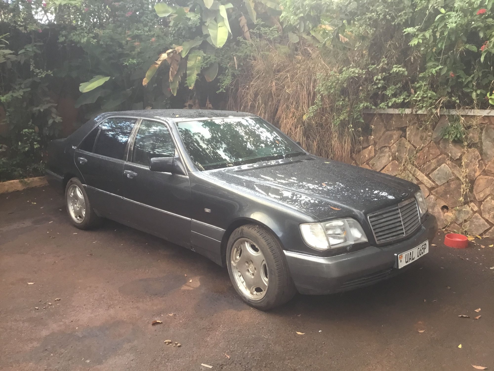

Ive been living in Rwanda, Kenya, S.A. and Uganda as my home bases since I went to work with the UN during the genocide in Rwanda in 94. I was a non tenured professor of engineering in Chicago who got bored.
Since then Ive Lived and worked for extended periods of time in Vietnam, Cambodia, Laos, Afghanistan, Jordan, and Iraq. Mosul was a cool place until Blackwater.
Im also a lifelong sailor. Did a 2 year circumnavigation in a Warrior 38 during a break in a 20 year university stint. Ive got sailboats on Lake Victoria in East Africa, the Med, and the Olympic Peninsula In Washington. My official stateside home is my boat, so, by Wa state law Im considered homeless..
Im also a gearhead. Being based a while back in Baltimore I started storing my stateside cars and bikes there. I am trying to get 4 cars and 3 bikes moved to the Seattle area where my boat is.
And with a bit of luck Im going to be able to ship my S600 from Uganda to Wa state as well. I spent 3 years restoring it, carrying all the pieces in my luggage from Europe and the States. A UN relief worker brought it over to East Africa from Japan, and commuted from Uganda to Sudan with it over some of the worst roads imaginable. He was killed by Jajaweed rebels in Sudan. It sat there being used for target practice for several years. When I was shown the car, it was full of bullet holes and pretty trashed.. The sight of Benz’s flagship V12 in a refugee camp was too much, so I flatbedded it home to Uganda.
My 928 I found on an island outside of Vancouver. Brought it to Seattle, gave it to a shop for 3 months. Then drove it to Central America and then back to Baltimore. Hell of a road trip for 7 weeks.
Since semi retirement, springtimes are spent sailing the Med On my charter Morgan 44.. During summer and fall I live on the water in British Columbia, cruising the Gulf Islands on my Islander Freeport. Winters I spend in Africa, where Im either on my Alpa 9.5m sailboat or sailing dhows off the Kenya coast.
And I agree, Rennlister’s can be rather obnoxious at times.
I also cant insert pics worth shiite...
It has come a long way
My Egyptian Hydadid Ibis guarding the S600

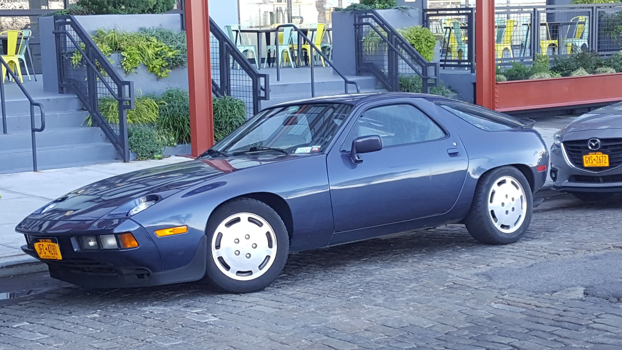

My 928, headed to Limerock Tomarrow.
