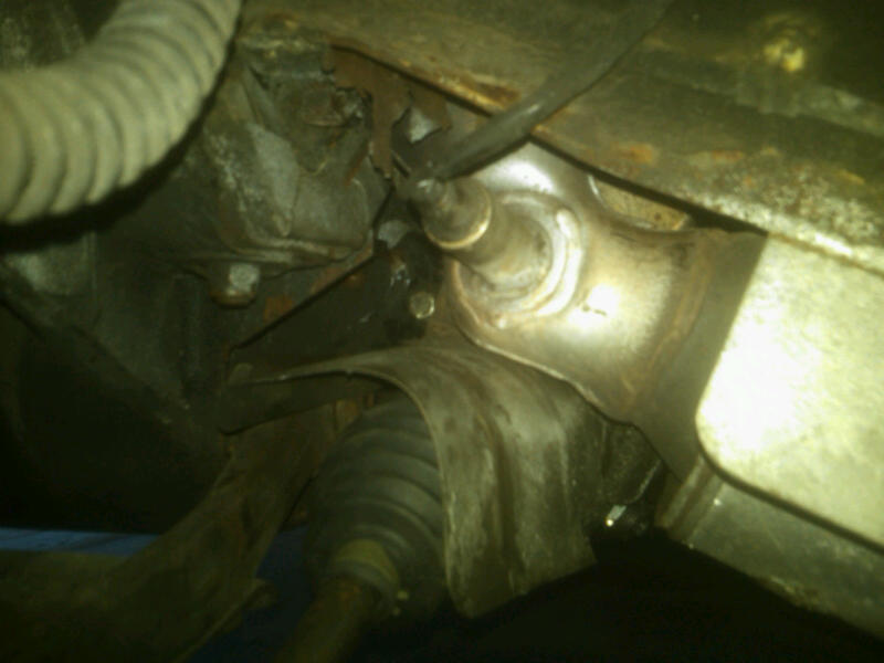

Ok...thanks for that Doug. Now the hard part...getting the damn thing off!
Possibly Hercules himself was one of the PO's, but I can't budge the sensor to save my life. By chance are these things threaded backward?
I've attached a pic in case this is new for someone else (like it is for me).
BTW, from where the oxygen sensor attaches everything aft, right up to the tailpipes, is painted silver. Is there something significant to this, or are they all painted that way?
Thanks,
John
