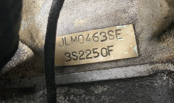

So what is the engine puzzle ? - the numbers on it - they aren't the ones on the log book which is above. These are the numbers taken from the top of the engine just by the transmission.
JLM0463SE = Part number - Clearly a high compression V12
3S2250F = What ? - I can find no such number in any Jaguar databases so far.
It looks like it has been stuck on but I've not tried (and won't) to remove it until I figure out what it is or why it doesn't align with anything I can find - is this a Jaguar warranty replace or something ?

Still no idea on the engine number though ....
