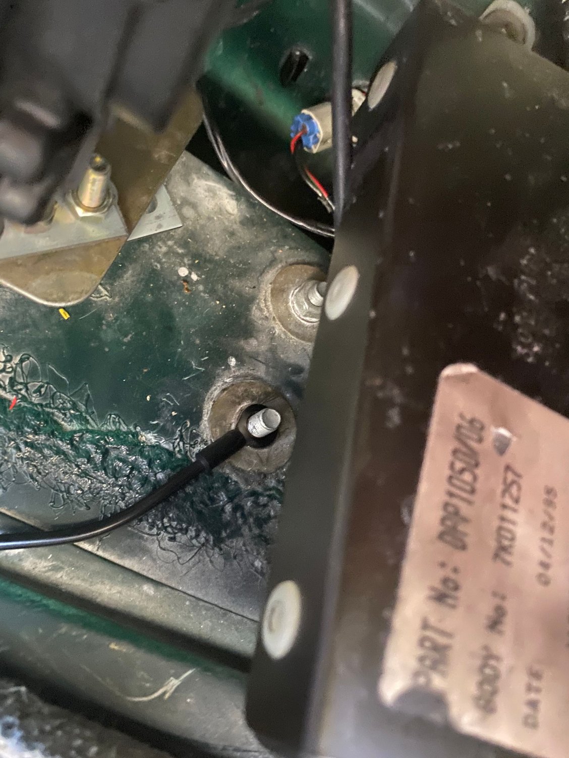

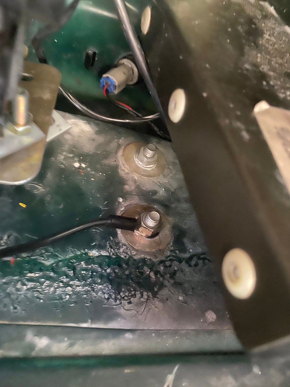

Right now I have the negative ring like this, but I am not sure if this will work:

It makes no difference, to chassis or direct to the battery, just as long as the circuit is made.

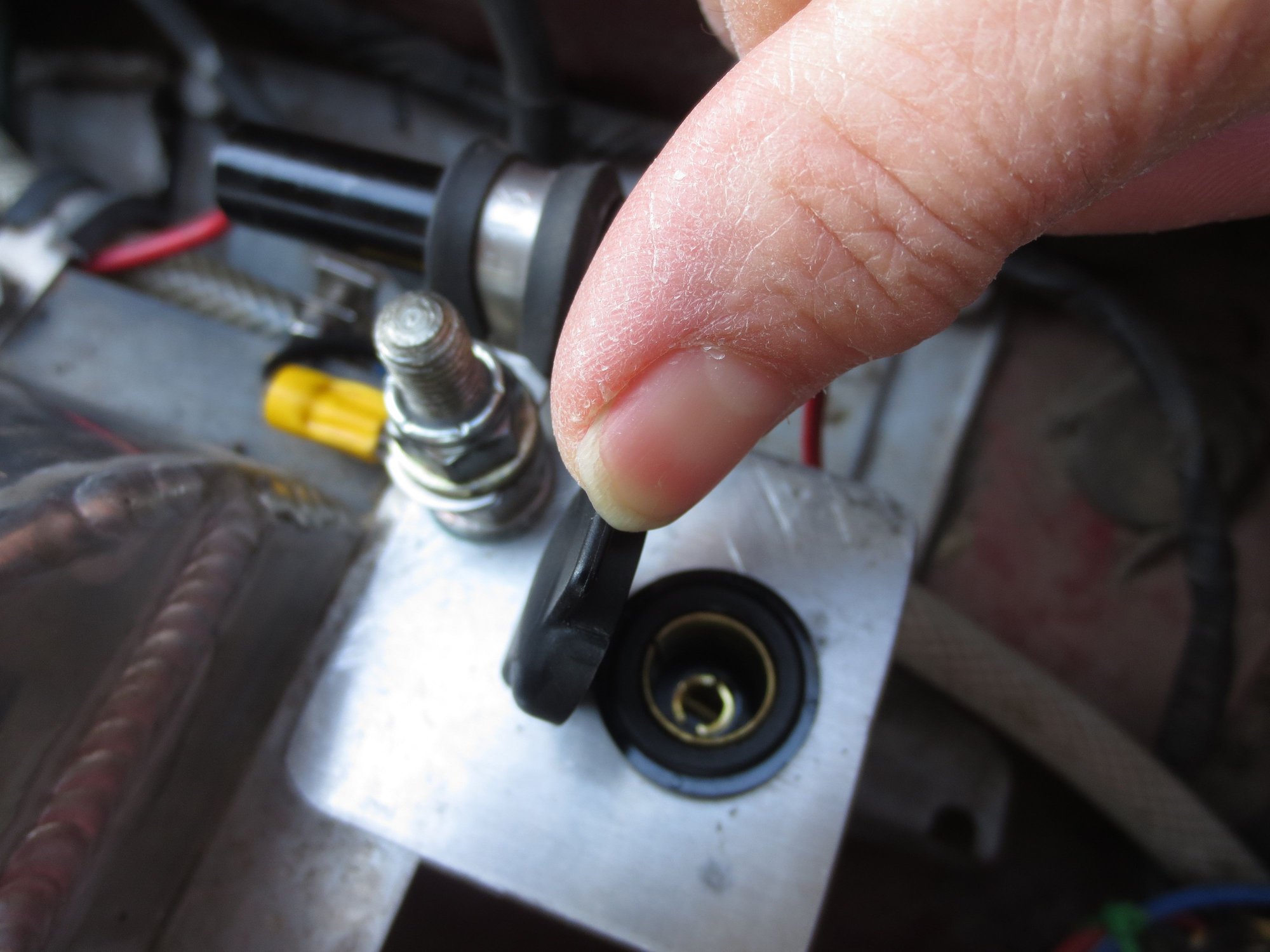

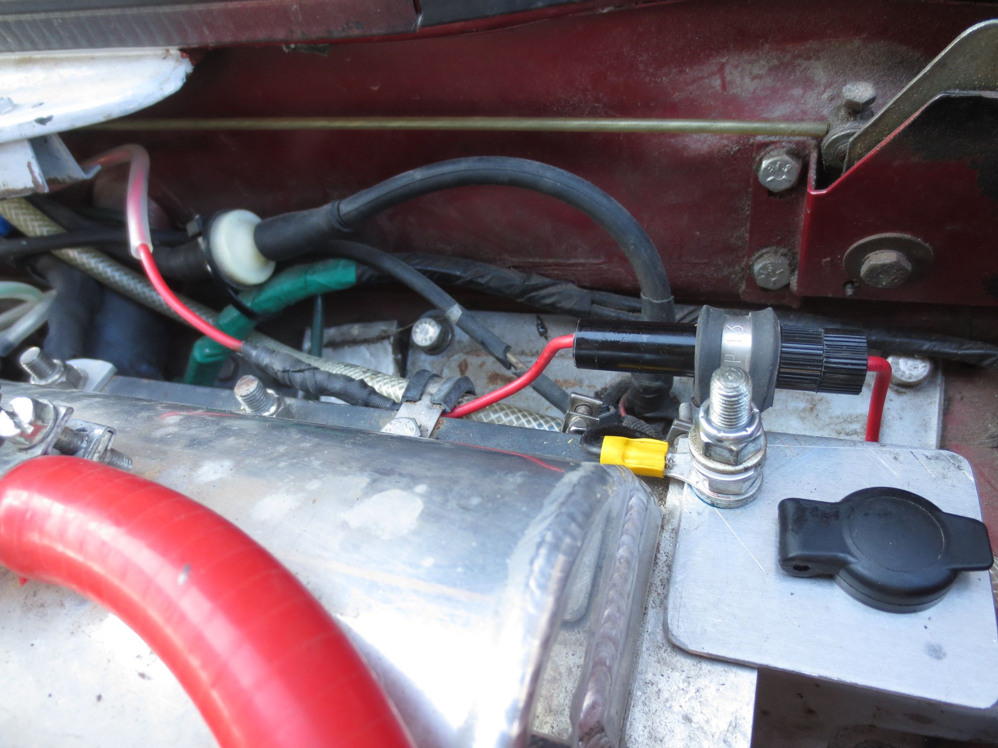

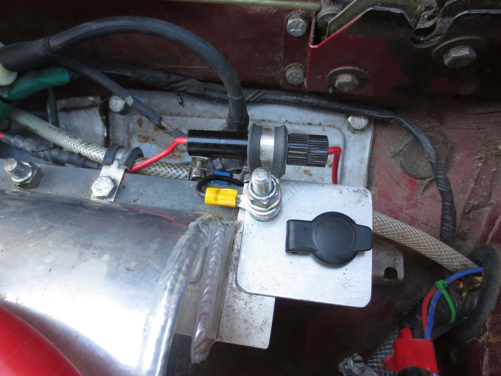

On my car, as fiddling with the battery is such a pain, I purchased a rather nice fused DIN socket and DIN plug, and rigged up the socket under the bonnet (positive to the firewall post, negative to body nearby).
Amazon Amazon
Then all I have to do is pop the bonnet and plug it in.

Like Greg, my "pigtail" is permanent to the car, and the battery cables, cover etc all stay as is.

Smart, I.never thought of doing a plug from the engine bay, ideally if one is feeling inspired you could even wire it all into a discrete water-proof (marine?) Plug under the car out of sight.
