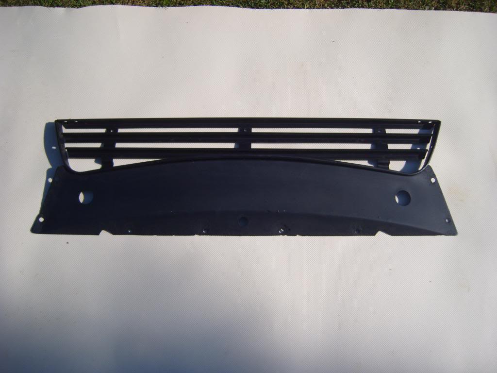

I managed to find the 'Brittle' plastic air deflector which came off my red XJS but it wasn't the right shape to match the mystery piece of plastic, that I found on the grass.
But later on when the wind dropped, I managed to get in the garage and had a look all round the Car with a torch.
To my great relief, everything was as it should be, with no signs of anything broken off and not a single oil drip anywhere!
Next I checked all round the Merc, which has lots of plastic parts and also which I should have checked in the first place!
And that was also Ok
So maybe some 'thoughtful citizen' (not) found it laying in the road and decided to lob it over the wall so no one would get a puncture driving over it, except of course me!
