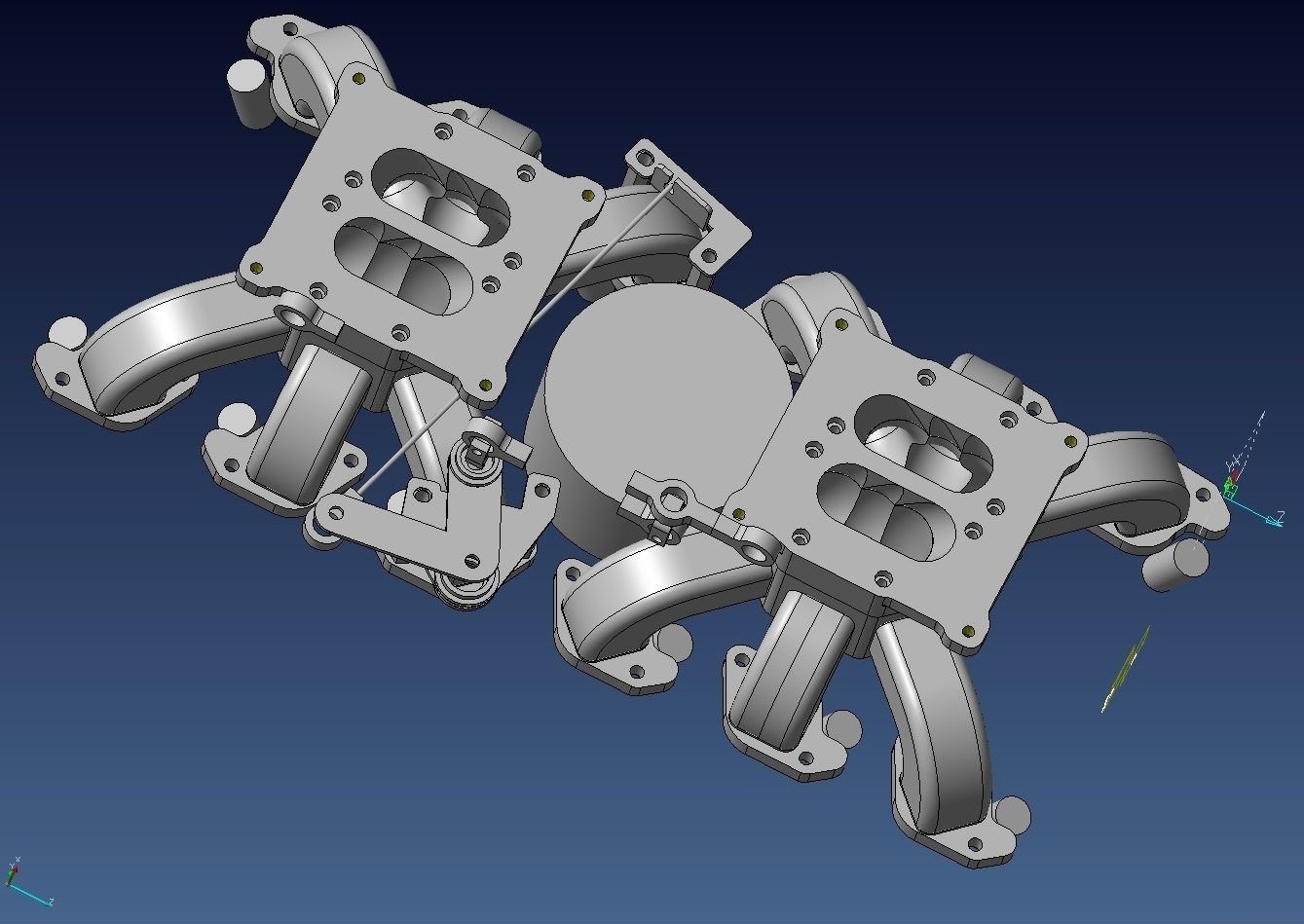

warrjon: I am using Holley carbs, so no ECU. And the OEM intake manifold is indeed fairly restricting. I installed a new one, designed and optimized for direct airflow. please see the photos - top: OEM version, bottom: new intake manifolds.
Spoiler
And you are right, I do not expect huge improvements just by the pistons. But the lighter pistons should allow for higher rpms there and there. Just for the feeling. Since Cobra is lighter than the original XJS, the engine already feels quite potent. It is easy to get into troubles - which is part of the fun! 500hp would be my death...

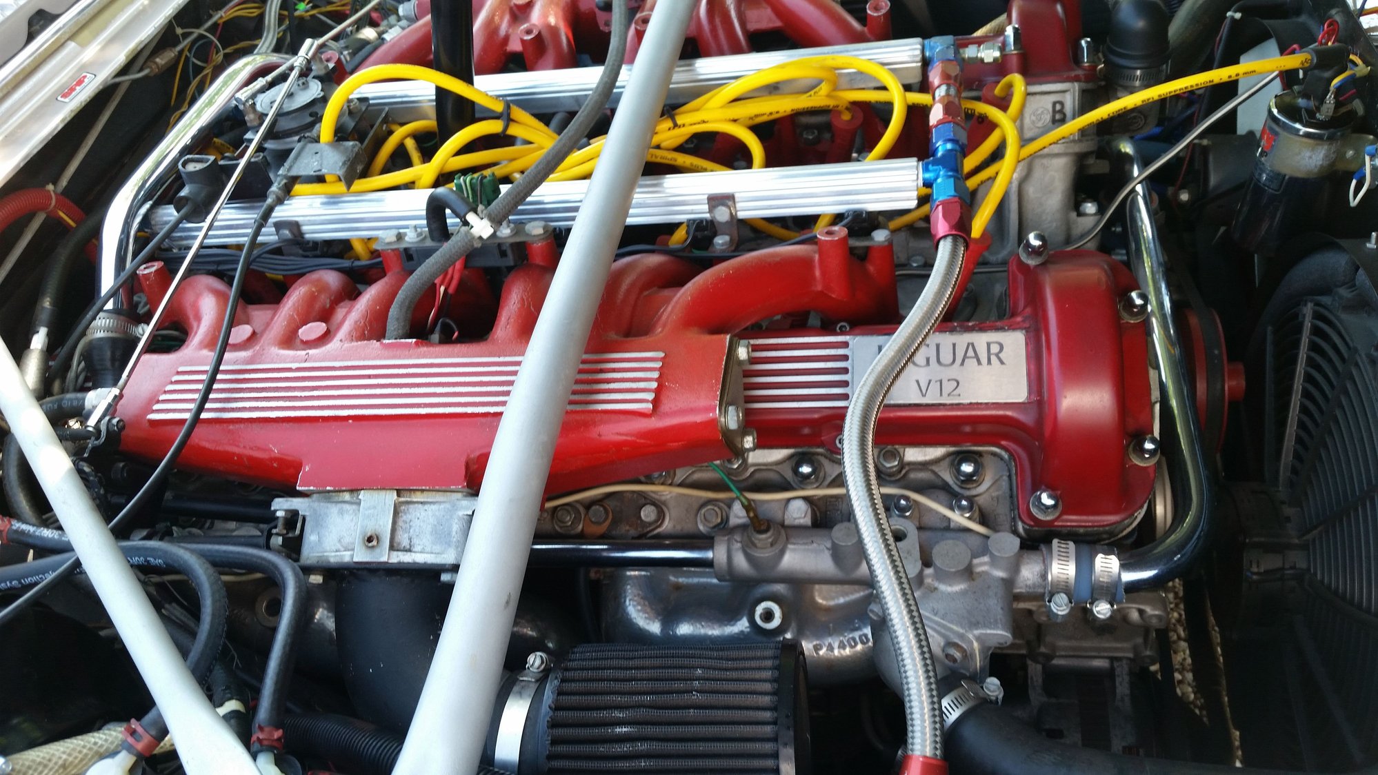

Very neat engine bay you have there.
If I were you I would go fuel injection, getting more power from a V12 with a Holley set is in uncharted territory.
Megasquirt has been done a lot on the V12 and all later model manifolds will bolt straight on.

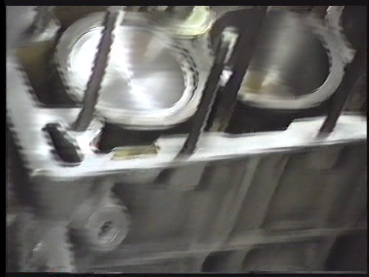

my pistons factory 9-1 , slight modify for 9.2-1, large bowl in piston top, Pre HE!

warrjon: The Holley carbs allow for a good setting in multiple regimes (with an A / F analyzer). And I wanted to go into the uncharted territory - it's part of the fun for me. For example the manifolds are custom made and even CFD-optimized (with respect to the flow), using ANSYS CFX.
Spoiler
. It should be relatively easy to get the engine close to the 400 hp mark, even without increasing the volume. (Better intake and carbs, polishing the inner surfaces etc.) This should be more than enough for me to handle.
ronbros: Compression ratio 9.2:1, bowl in piston top - that is exactly what I would like to do.

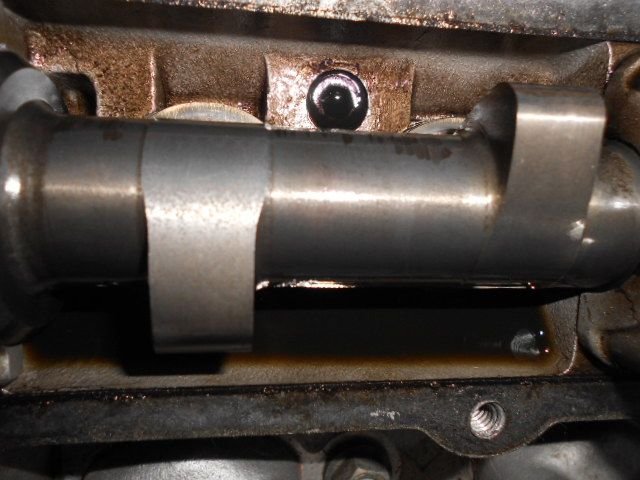

to be honest i have no idea what Crane did to the factory cams , regrind only allows just so much, but they did NITRIDE the finished product!
they did reshape lobe ,it can be seen by eye ,putting side by side, more area under the curve envelope, lift came to .410 thou. at .005 lash, but it was a little to radical so they recommended increase lash clearence
to .010 seems now perfect now, 25yrs and counting , had the cam covers off a while back , all looks good NO wear. and makes a nice solid lifter sound at idle,(i like it).
