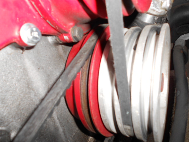

my 78 XJS had an old GM cast iron pump,heavy weight, so i came across a nice light weight alum. pump from a 1995 Dodge Viper(4lbs).
pic of the aluminum front pulley, replace the old cast iron heavy one!
many small weight savings , is why my 1978 XJS V12 roadster weighs 3370lbs.
