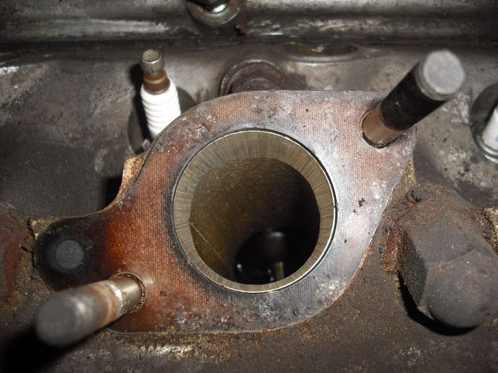

Smooth intake ports, see pic although this is my 6.0L head
