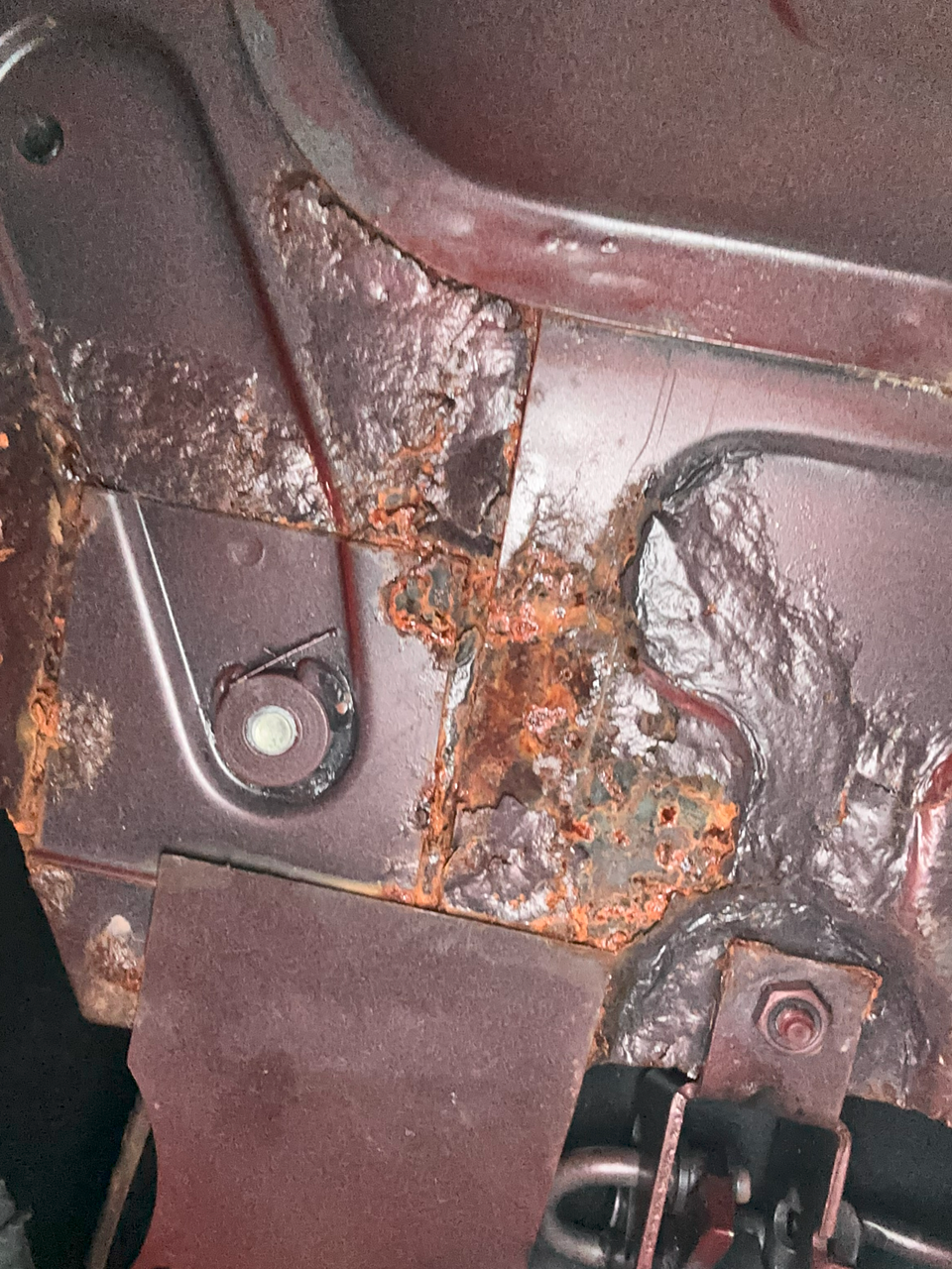

Your only hope is frequent and regular attention, liberal use of the appropriate anti sieze (being careful to adjust torque accordingly), keep the car out of the salt season, make sure your grounds are in good order and I don't mean the grounds of your house, never park on grass or 'soft' surfaces, don't park in unventilated garages, don't use a pressure washer on the car - it is tempting but it pushes water into places you don't want it especially underneath. I would also spray static components such as fuel lines and other items prone to condensation with a good underbody wax (not the same thing as underseal) - Dynax S50 is my go to (Bilt Hamber).

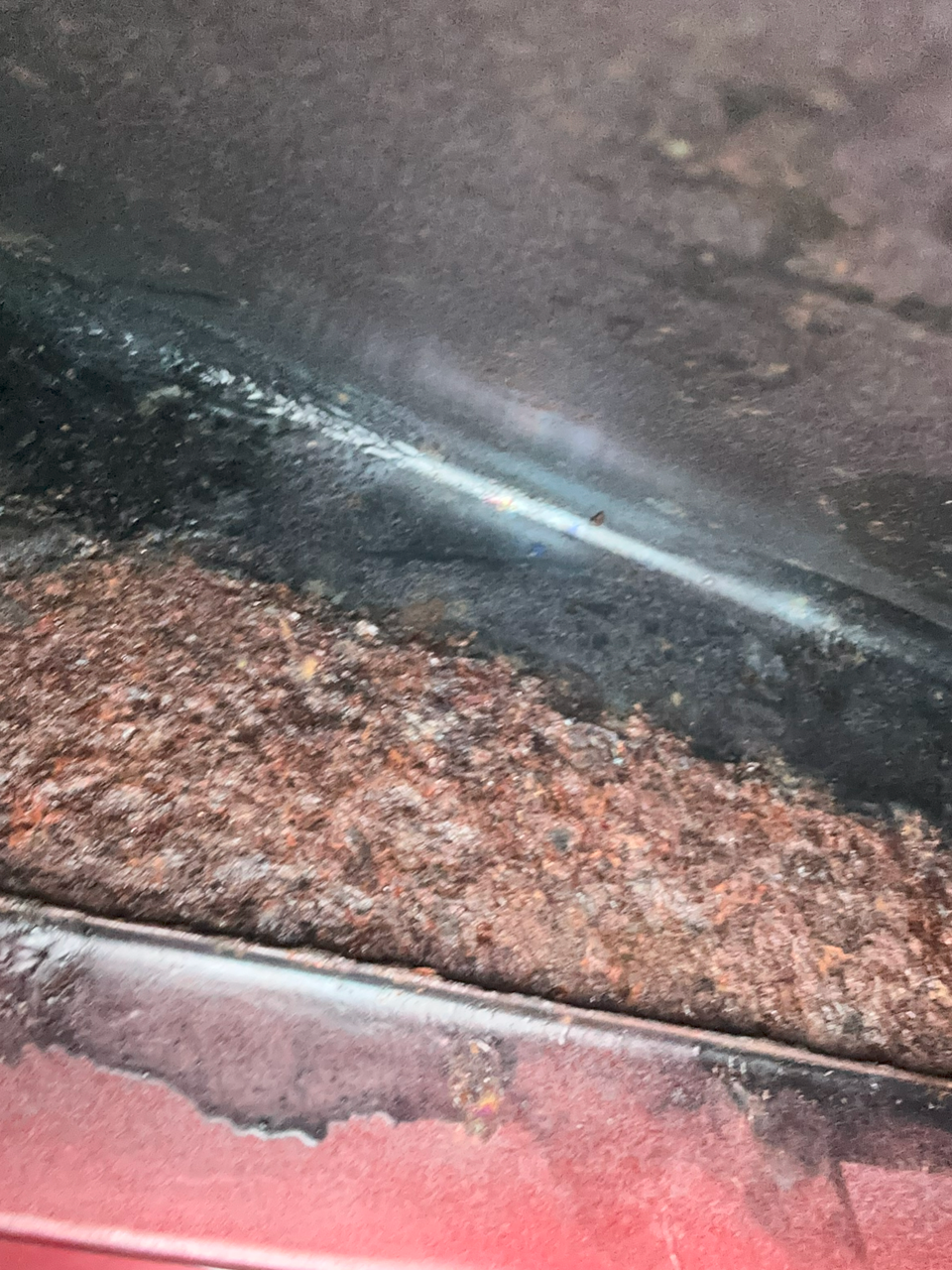

Pay regular attention to chips / scratches and if you see blisters in the paint get it dealt with because like icebergs that blister hides 10 times more destruction, try to inspec the places you don't generally see, I won't overload this thread with the hidden nightmare that started my 5 year journey. As an example there was one blister on my left buttress - this was what was hiding ...
The last picture is the underside of my back window, hiding above the fuel tank, the rear buttresses were rusting badly - from the inside out. Jaguar simply didn't paint what couldn't be seen, these cars weren't treated to immersion or other modern techniques - if the robots couldn't see it there was no paint worthy of note, but there was condensation, I was rebuilding my fuel system when I found this - fuel tank still hasn't gone back in.
