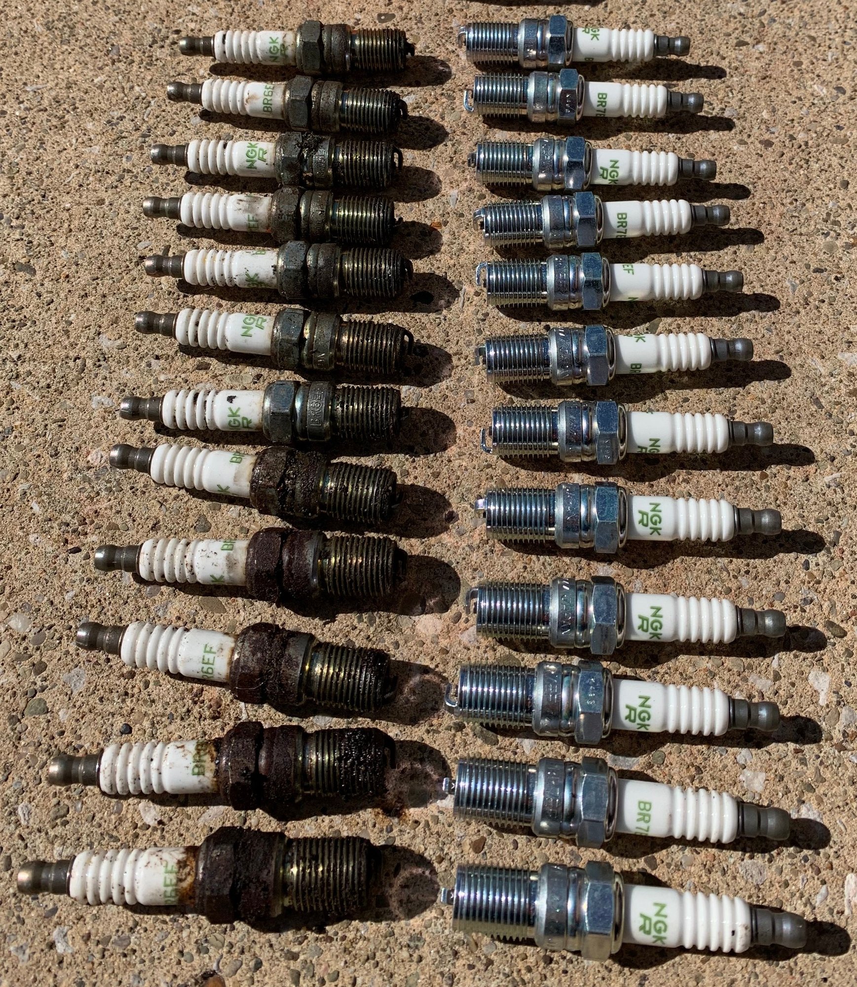

Josh, like you I am a newbie to auto repair and have been working on an ‘89 convertible during the Coronavirus lockdown. This forum has been a great resource for advice and help. As well, you should check out the “Living With A Classic” channel on YouTube as he posts many how-to videos on XJS maintenance projects.
I recently replaced the rubber fuel lines and had the injectors refurbished as Vancouver suggests. My car was sluggish and I wanted to prevent a potential engine fire. I was originally going to try to do most of this myself, but was concerned about potentially damaging expensive parts in the process. I ended up shopping the injectors and old fuel lines to JaguarFuelInjectorService.com in Florida. He did a great job and provided invaluable advice in how to remove and reinstall the parts.
As long as you have the fuel rail and injectors out, I would replace the spark plugs and leads as well. My old plugs were quite dirty.
Old vs new plugs

Old vs new plugs
The guy in Florida did mine, of course I could do locally but I prefer to keep the money in 'our' community, was abit more due to my CAD to USD exchange rate but he took the best of my bag of injectors and sorted out 12 for refurb, huge boost in responsiveness. Everyone forgets about that little filter basket it ends up being the bottlebeck, that and the swirl tank filter.
