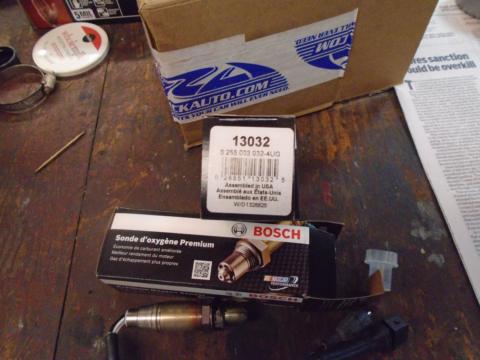

So I purchased two new OEM style Bosch sensors from Rock Auto at a very good price $57 each. Bottom Line...after the ordeal below with the new sensors installed,,,the car STILL PULSES.......damn......don't know what to do to solve it.

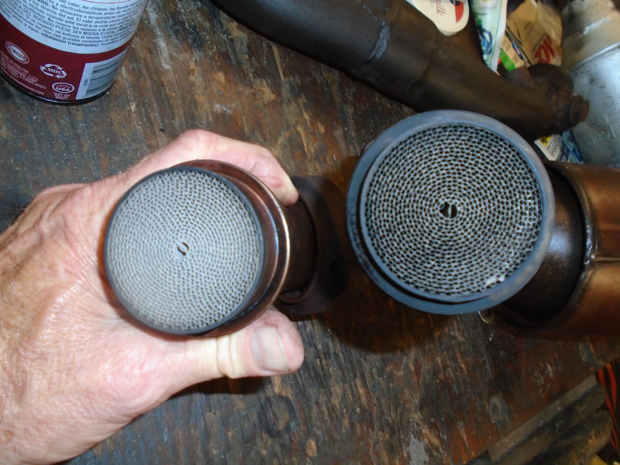

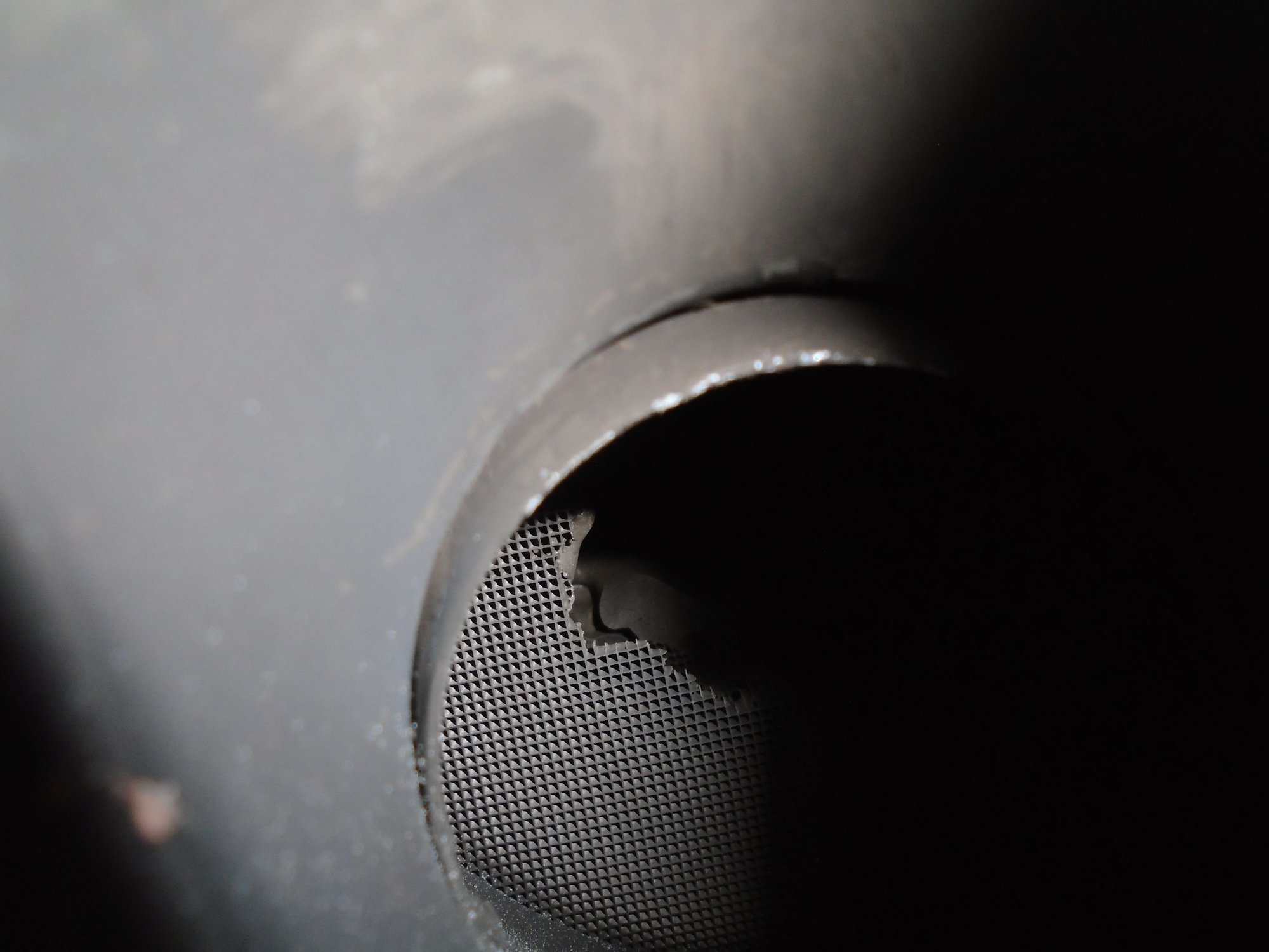

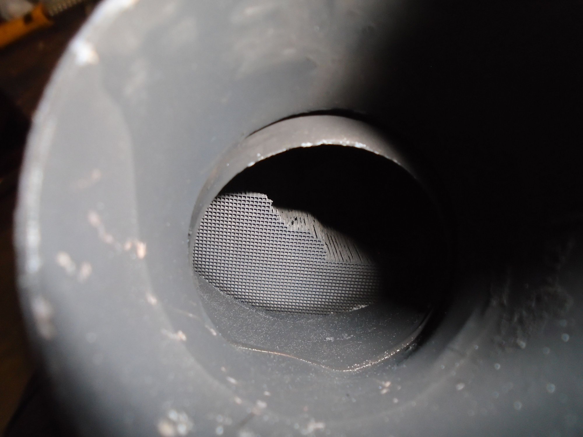

When trying to remove the old/original RH side sensor I could NOT budge it. I have the special O2 socket/tool that has a split for the wires and it started to round off the hex. So I had to cut the end off the sensor to use a 6 point long HD socket. Still couldn't unscrew it; so out came the torches. It started to come out but would freeze after 1/8-1/4 turn; thus keep reapplying heat. I brute forced it and it finally came out. But I must have applied too much heat and the threads of the sensor melted in the female hole in the down pipe (pic # 2). So next I had to remove the down pipe/cat converter. Upon removal I noticed the Cat honey comb was partially broken and melted inside (pic # 3). Same for the secondary Cat behind it. Fortunately I have the pipes from my parts car, The PO had gutted them, so I wanted to replace the LH side as well. I learned something some of you may not know. The down pipe has a honey comb in the "canister" portion of the converter. BUT it also has a "pre-cat" honey comb in the mouth of the down pipes right up where they bolt to the exhaust manifolds. (pic # 4) Now I had a dilemma with the LH pipe. It's a very arduous task to remove it due to the steering rack and heat shields etc. on a LHD car. I could/did chisel out the honey comb in the canister portion in situ (after removing the exhaust pipe behind it). I could not get to the upper "pre-cat" honey combs, So for now, the exhaust is not balanced but I don't think it will be noticable.
SIDE NOTE: Good news. Gutting the CATS have awakened the engine; it revs quicker, feels more responsive and more powerful. (Remember there a 4 honey comb sections; ea individual down pipe, the main Cat and the secondary Cat...plus 2 mufflers; on each bank---12 exhaust plugs in all)
