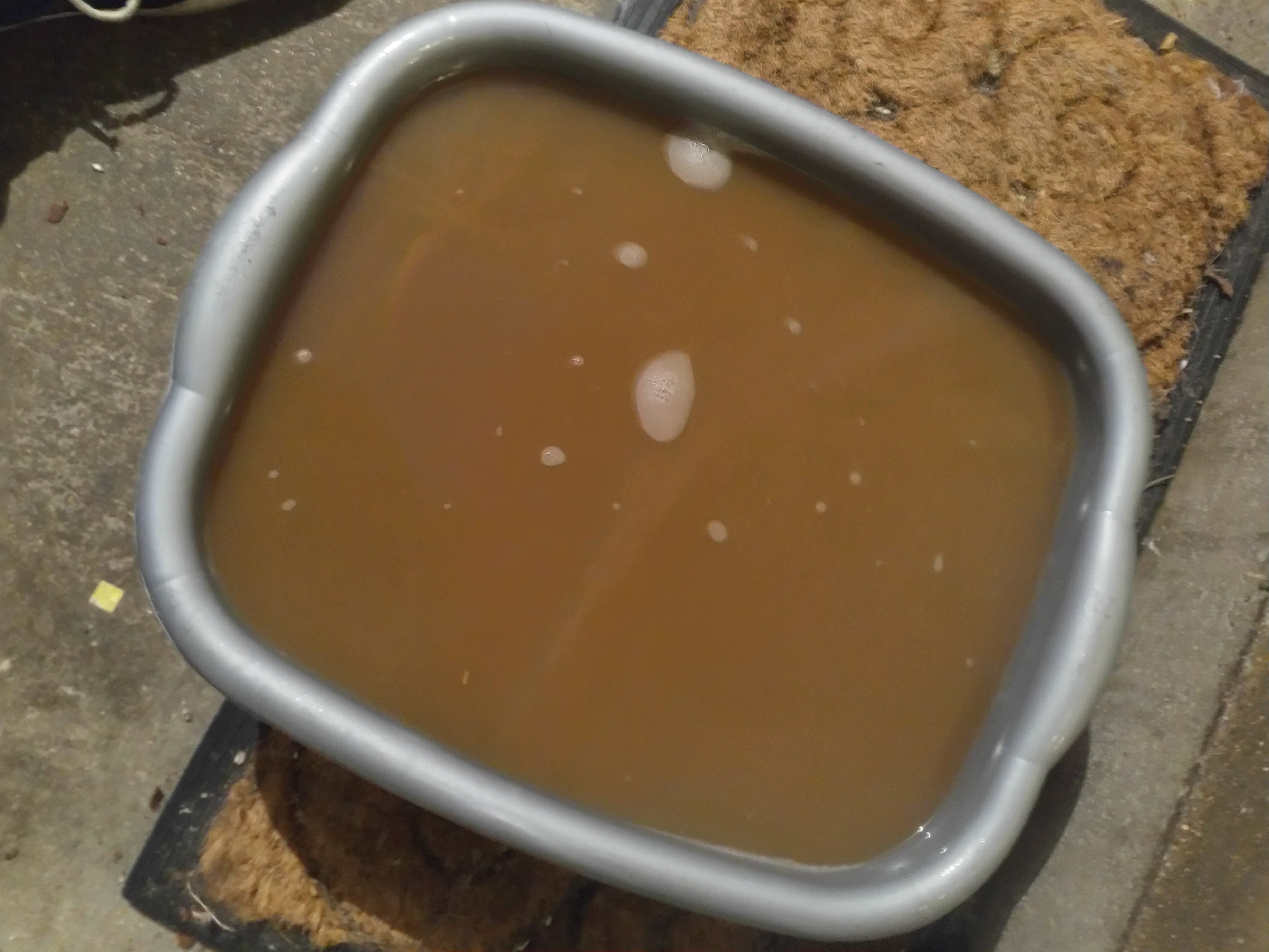

Had my Jag cooling system flushed last week, took 3-4 hours to do it, before I had clean water coming from the bottom hose. First I ran a rad flush for an hour with full heating into the cabin, then drained it completely and flushed with more water until clean.
Then filled with water and ran the car again until coolant at ~90C, drain, flush and repeat 5-6 times until I finally got clean water from the bottom rad hose after car ran ok for 15 minutes with full heating on. Must have used a half a ton of water in the process!
The only way to do it properly is to repeatedly flush it with water, otherwise you will still have rusty crap in the system.
Attached is a pic of what was coming out of the system until ~5th flush.
By the way, the system when warm didn't even get that much pressure so I didn't even have to tighten the worm clip on the bottom hose, just pull and push it and it wasn't leaking at all when full and warm so the whole job was easy, just time consuming.
