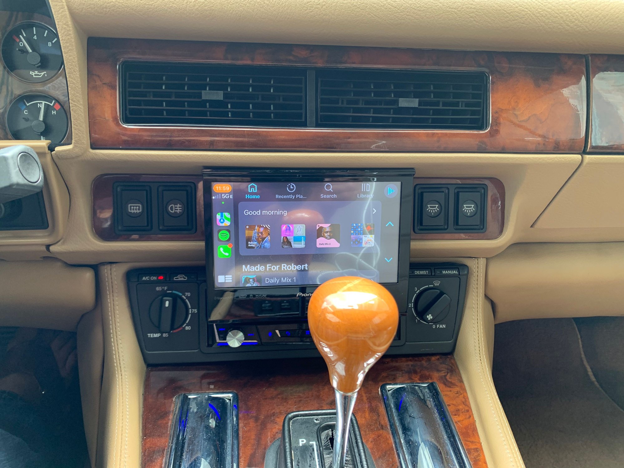

I replaced my radio in my 96 XJS 2x2 with the pioneer slide out screen. I also replaced all the speakers with JBLs. Best upgrade ever. The sounds are fantastic. The deck has CarPlay, Alexa, voice command, so rarely need to use the bigger screen unless I’m using navigation. I was also able to change the color lights on the deck to match the green lights on the dash. I didn’t install it, I had a guy who worked on imports who was familiar and comfortable with older vehicles.

I should let you know that the radio will not clear the gear stick while in park. So when i engage the eject I typically engage when the gear is in neutral or drive and typically keep it out. Slide back in when not needed.
The original is still intact so if i ever sell the car which i my thinking about the original radio can easily be reinstalled without issues. I also kept the original look and feel exterior speaker cover grill for the speakers so only changed out the speakers.
